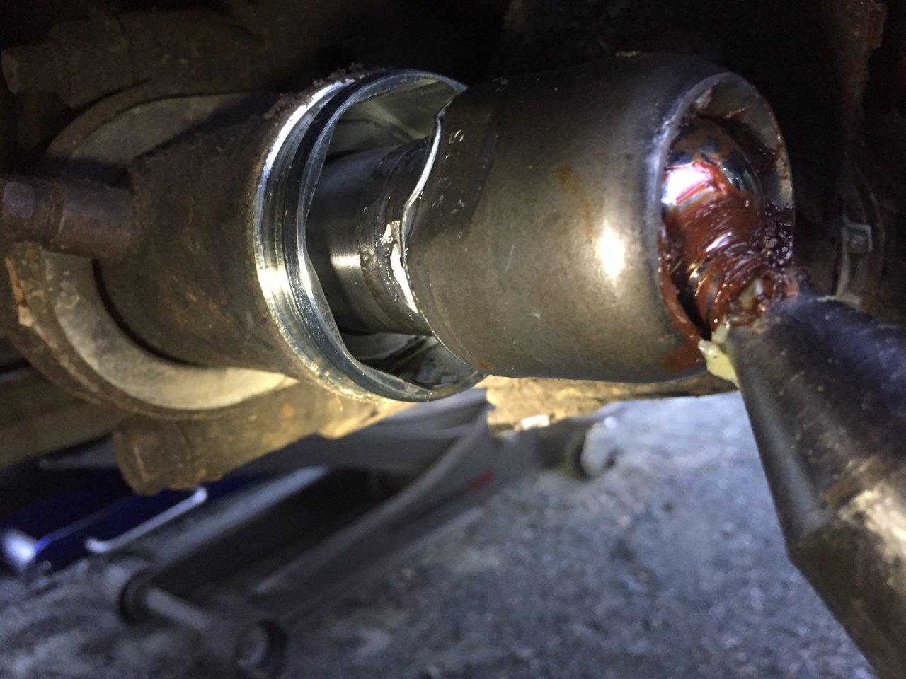

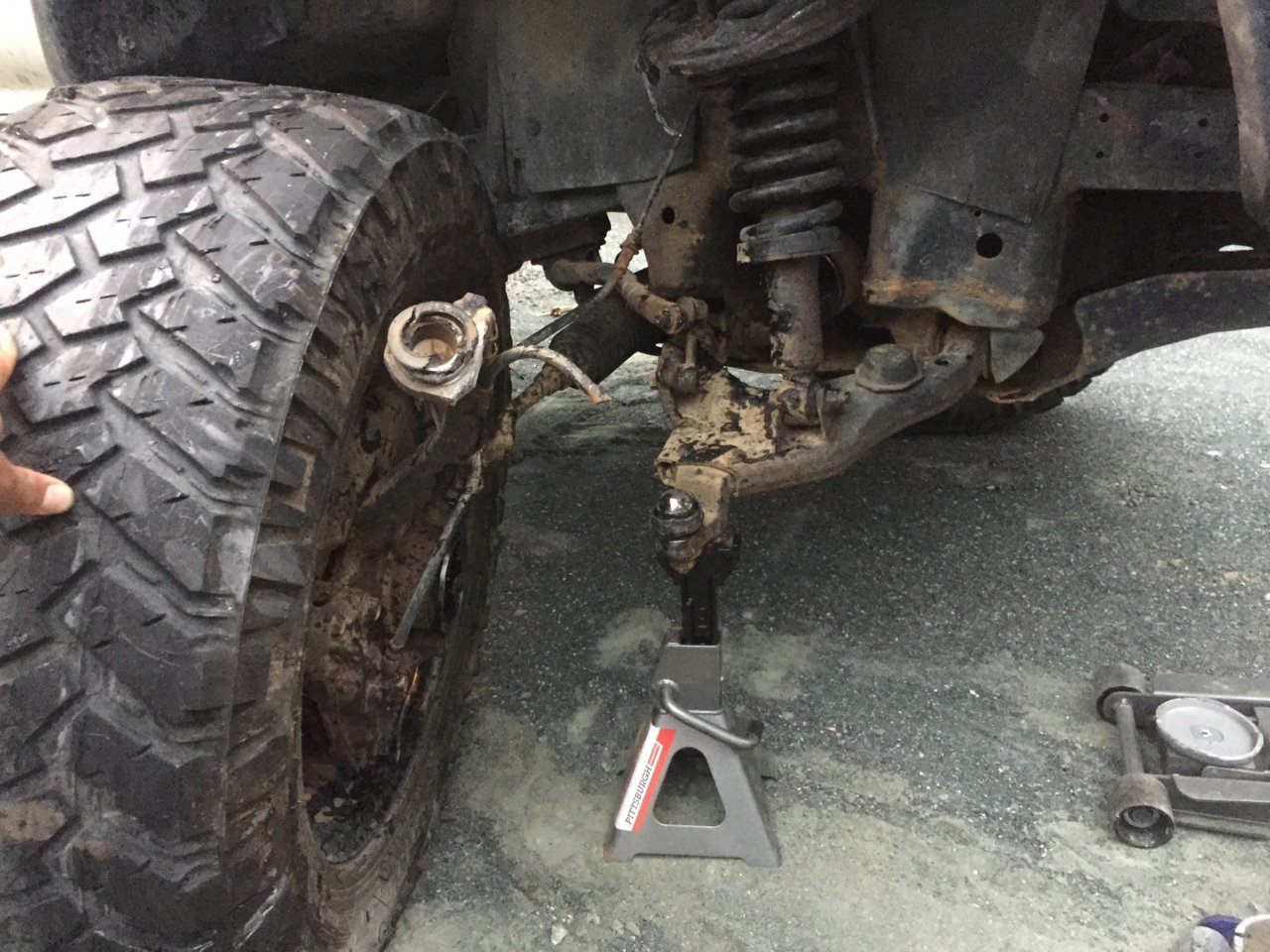

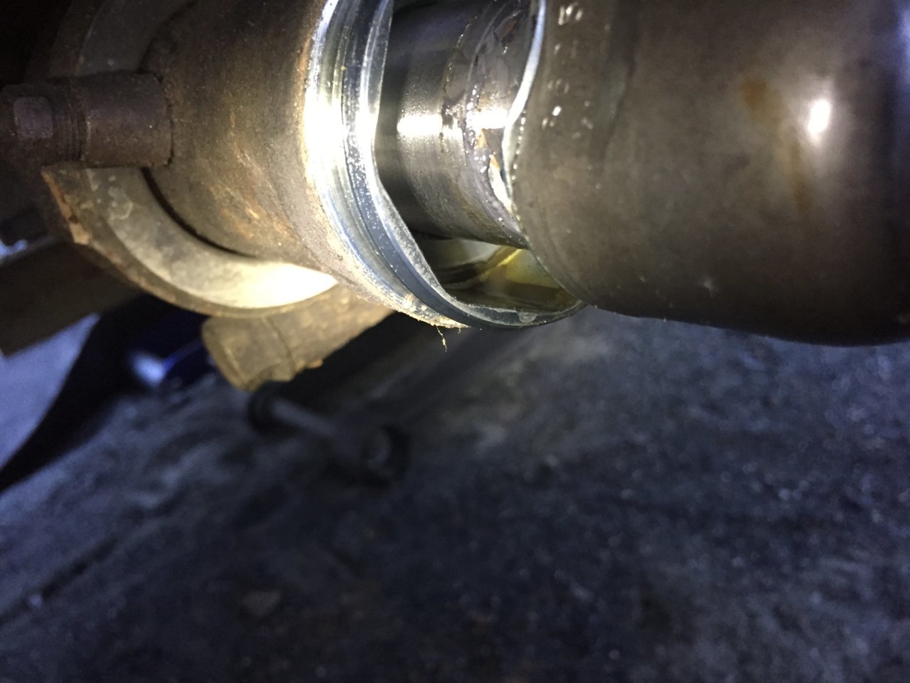

    Looking for some advice, dropped a ball joint otw home from work the other day. Front end needs some attention. Looking to possibly redo everything. Upper Lower ball joints outer inner tie rods sway bar links shocks, possibly control arms. I have bilstein rear shocks and I love them. Looking for a kit ideally. Seen moog kit for $400, should I go ahead and get uniball control arms? Any advice helps, thanks.

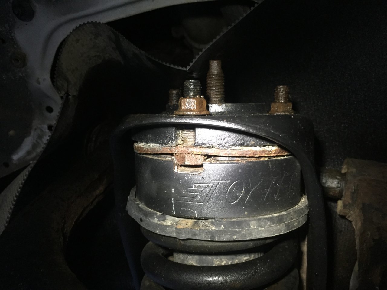

    Ok I’m pretty deep In this project. Couple things I’ve run into. I can’t remove my spring/coil over assembly. The 3 bolts turn when I loosen the nuts. Video and manual says you don’t need the spring compressor until after it’s removed in order to separate. However, I do have a toytec leveling kit so I’m wondering if I need to compress first to get a wrench on the head of the bolt. Also, I’m into my Intre’s and I heard something about inspecting my rack. What exactly am I looking for? I did notice a slight bit of oil under the ITR. Keep in mind this is my daily driver for the most part so I’m trying to get this done but also get it done right. CD51E6E4-9321-4A9E-967A-731B40C3D3AC.jpgCD51E6E4-9321-4A9E-967A-731B40C3D3AC.jpg 89AC297A-A452-4655-B578-C4383309BAF0.jpg46598073-4A68-4692-9057-95F21B28DEED.jpgimage.jpg

    If those 3 bolts on top of your coilover turn as you try to loosen them, it's time to cut them off, and you'll likely want to either revert to stock height or get another leveling kit. I personally dislike spacer lifts like that
    Get yourself a pitman arm puller from the auto part store or harbor freight, for like $10-$15, and that will pop off your outer tie rod from what's left of the ball joint. Same tool will work for pulling the other piece of the balljoint off the lower control arm. Just leave the castle nut threaded on (but loose) when you crank on the tool.
    For the upper balljoint, just go rent the proper ball joint press tool - the one that looks kinda like a C clamp.
    Generally, as long as the steering rack isn't leaking oil, it's probably fine.

    It also looks like your LBJ popped out of the socket? Mine sheared apart with the ball still in place.
