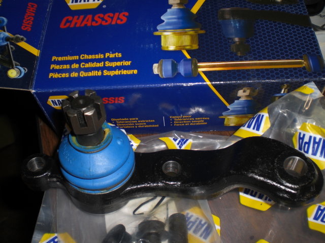

    I like the Napa in house premium line for suspension/chassis.....
    best bang for the buck .......for a daily driver....
    I would be careful of oem counterfeit's......you may be paying a lot of money for pure junk.......
    Toyota and lexus parts are pure gold .....to some.......
