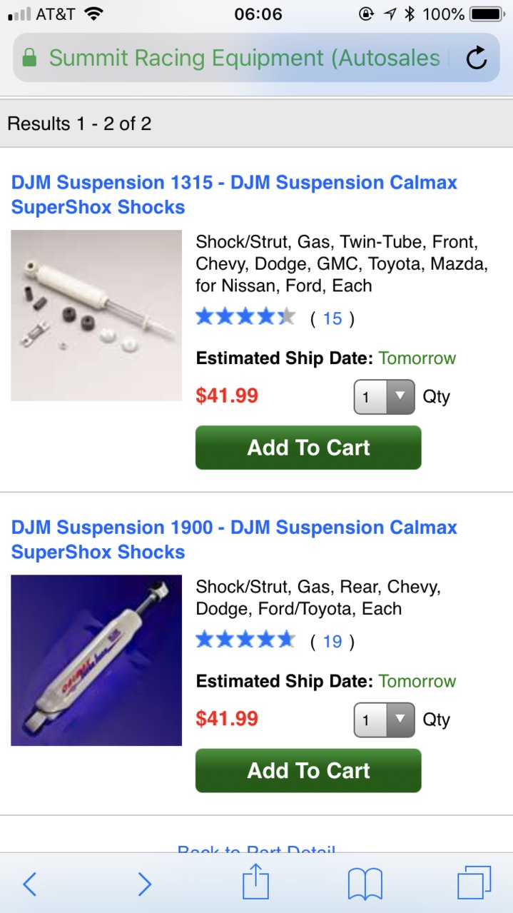

    I have a 2003 Toyota Tacoma 5 Lug, 2.4L with a DJM 3/4 drop, I am about to borrow a buddies car for a few days whilst I tear mine down, i'm at 210k now, and its time to rehab this truck. I have an intense rotational thudding in my front drivers side wheel well, I also notice that I bottom out in that wheel well only. I plan on rejuvenating the truck back to the former glory it once held.
    Upper Ball Joints Both sides
    Lower Ball Joints Both sides
    Tie rod Ends inner/outer
    Inner/Outer seals, bearings
    Calipers
    Pads
    Rotors
    Shocks(all 4 corners)
    1. Where do I get or order these stabilizer bar bushings?
    (the red in the picture)
    2. Am I missing anything else you would replace to insure everything is up to par and feeling new/and crisp?
    3.What size shocks should I purchase, and what brand should I purchase?
    4. To touch on the intense thudding I get, it is specific to the front drivers side wheel, the rotational thudding happens when I turn left, when the vehicle is straight I do not have an issue. Could you think of a part or malfunction I am not seeing?
    5. I want to order OEM Calipers (Camelback toyota) for both sides, will they come with the anti squeel shims? I think I may have lost one in the process of swapping breaks last time, I have one side with a Napa caliper, and the other with a OEM one, I figure swap both back to new OEM, Unless there is something out there better than OEM.
    The truck runs great and has never let me down, I want to insure it will go another 200k with me and be pristine. When I got my last alignment I was told I needed to change ball joints, so I figured whilst im in there it would be a good investment to rejuvenate everything that is a wear item. Anything else I am not thinking of or missing, please let me know.

    Coil amd ahocm wise it should all back stock up front. Rear i think you want 7” travel shocks. Djm does make ahocks for this kit
