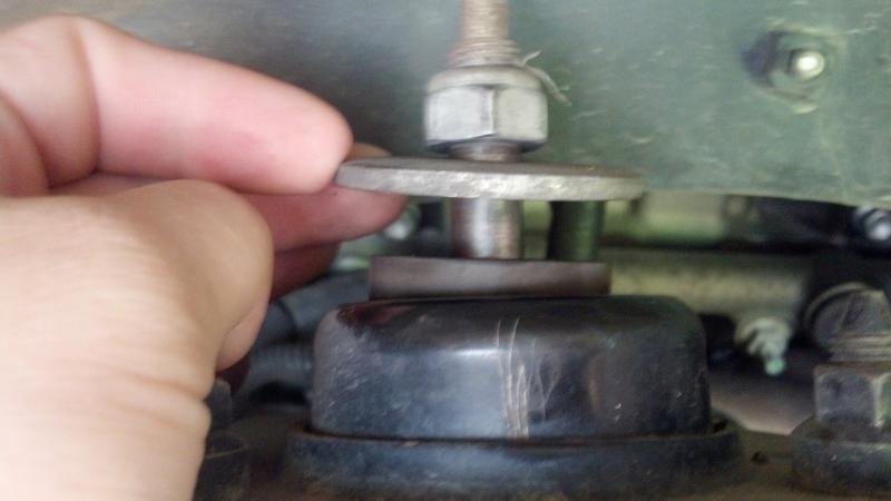

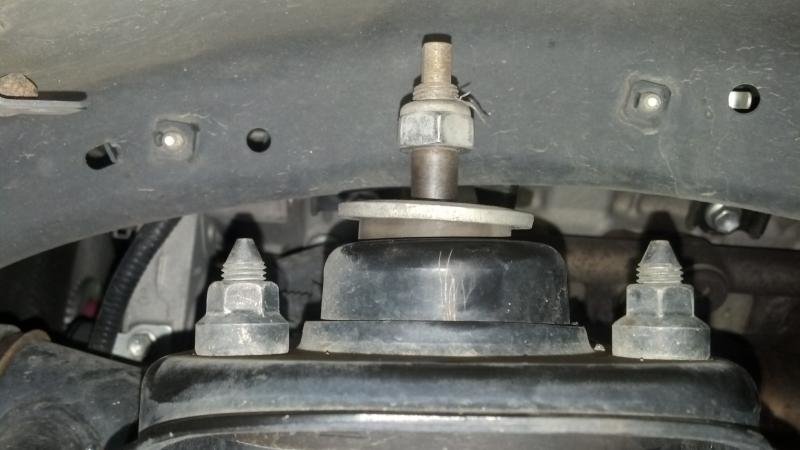

    Ok so a few months ago I had a local shop install a set of Bilstein 5100's front and rear. I had the fronts set at 1.75" on my stock coils (SR5). well I have developed a rattle in the front. It's almost like something is loose. I started looking around and I found something that looks strange. The top of the shock does not seem to be bolted down on each side like there is a bushing missing or something. I had a 99 2wd tacoma that was lowered and I know that should be tight up there. The bolt is tightened all of the way down but as you can see in the pics the threads don't go all of the way down. Can anyone tell me if there is something missing. There is a bushing there but it's not big enough to fill the gap but I also fill like maybe the gap is too big. Pic are below.
    Can anyone tell me what is going on. I believe the metal piece that I am holding up is the part that is rattling.

    That should definitely not be like that. Looks like a part is missing or your coils are compressed so much that the shock mount up top isn't even touching
    Edit: That top nut should be sitting right on top of your top plate

    The shop put the washer that is supposed to be on the bottom of the plate on top.

    That makes more sense. I would say that the correct washer is on the bottom.

    Where is the top hat (top spring cup)?

    Looks like you are missing the "cushion retainer" (see pic below).
    Also looks like you are missing the plastic dust boot. If you do not want to use the dust boot that is fine, but you still need to install the metal bushing that is inside the plastic boot.
