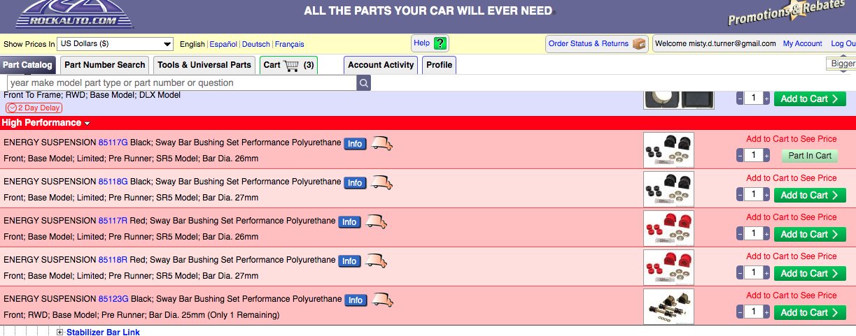

    Anybody know which bushing set I need to get, with regard to my sway bar diameter? 27, 26, or 25? I have a 99 Prerunner v6, oem sway bar as far as I know. Also ordering the Preforged 11310179 end links from RockAuto.
    I'm still waiting for my FSM to come it, so not sure where else to find this info.
    Thanks!

    Both my 98 and 04 are 27mm.
    Just check the bushings. They are stamped on the side with size.
