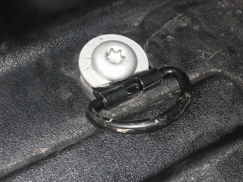

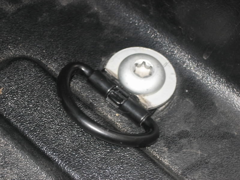

    I also thought I had to have stock rings but I only paid $28 shipped through TRDparts4U. I need more and plan to order the 5 for $5 (just like Arby's) from the Army Surplus store. They are the same thing.
    You can buy the torx bit at any auto store for $3. Remove the bed bolt, slice off half of the washer (or remove the washer with a BFH) and reinstall the bed bolt with the D-ring in place.
    I cut half of my washer off with an Angle grinder ($10 at Harbor Freight).
    I'm buying 2 more to put in the middle bed bolts.

    Not worth arguing about any longer. I just want to point out that the washer can be removed all together. A big hammer can break if from the rings that hold it in place (they are rings NOT threads). If you want to retain the washer, you need to trim it so the head of the bed bolt sits flush. That is the route I went.
    You do not need to enlarge the hole in the washer.

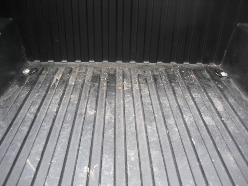

    Hauling a bike, I use the front anchors that I added to my bed bolts. But when I haul 2 bikes, they are tricky to use. I plan to add 2 more to the tops of the wheel wells. There is a very solid surface under there that would work well with the backing plate that comes with the D-rings.
    I used my cleats once (hauling 2 bikes) and was NOT comfortable with it. The cleat itself stretched a good bit. Also, the diameter of the bolts holding the rails to the bed is not impressive. The cleat system is great for hauling random things, but bigger items need more stable anchors.
    I'll be drilling into my wheel wells soon.
