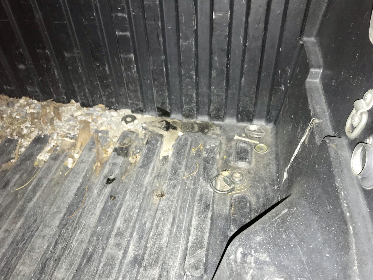

    How did you make such nice holes on the rubber? Did you use a hole saw? If so, what size? And how did you locate the center?

    How do you almost get a crack?

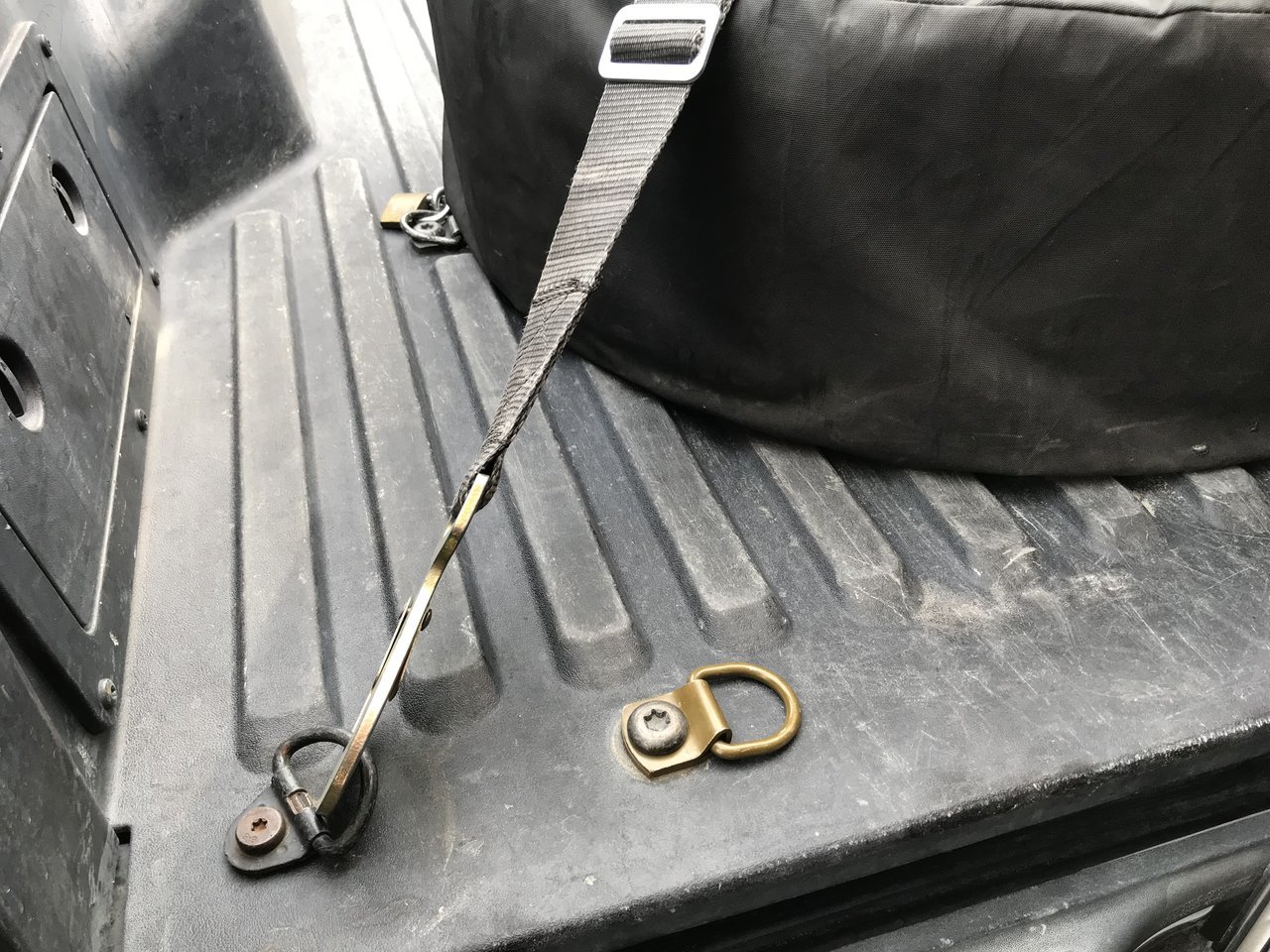

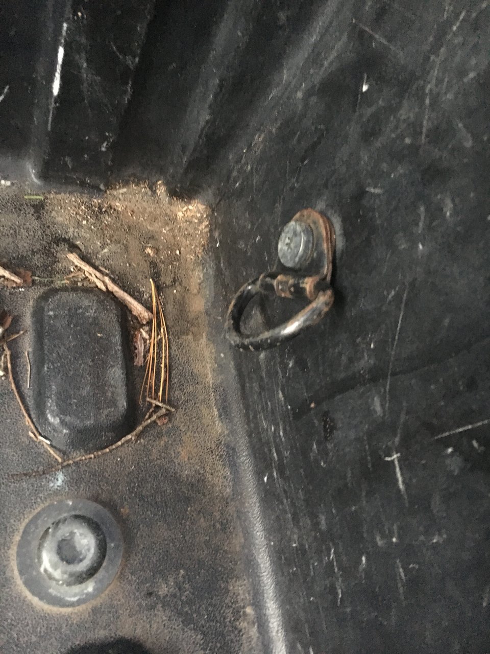

    Do the added D rings rotate like the stock ones, or they locked by the bolts? Or, did you mod them to rotate?
    On the second pic, it looks like that one can rotate?

    You lock them by the bolts. Face them any direction you want.

    With a strap. I was tightening a strap and was hearing a cracking noise. I stopped and found this solution. This d rings are strong. Same ones i saw in hummvees in the marine corps.

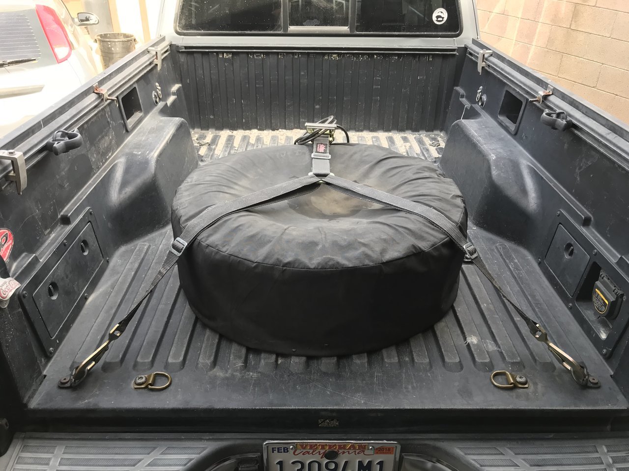

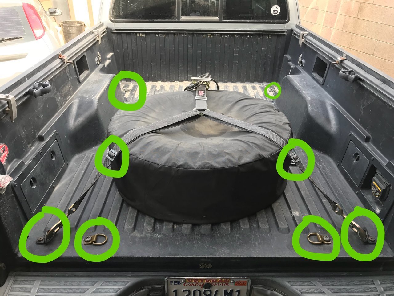

    Yea if you get 6 d rings. Cost you just over $20 and well worth it.
    The front of the bed, i put the d rings at an angle as you can see in the pic.

    Dumb question - how do you mount the d-ring into the floor? did you use a through bolt and have a nut on back side or did you thread a hole?
    Lastly, I have hauled a atv all the way from Seattle to southern Oregon using only factory locations up front and in the back with no issues and I had the straps pretty darn tight. I also use the rings in the trac bars along the side of the bed for extra, but I do not rely on those for strength.
