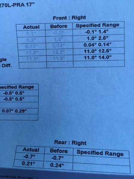

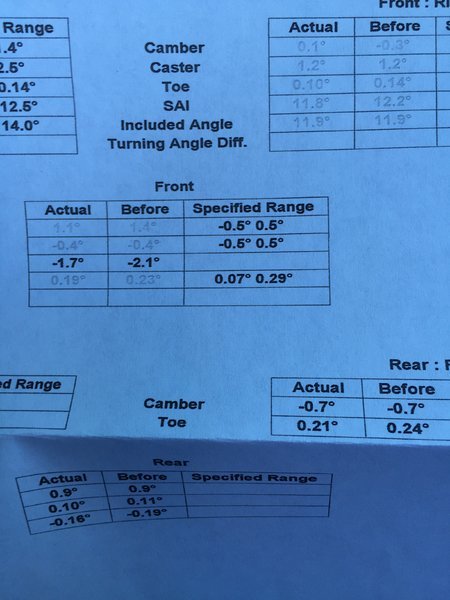

    So looks like I'm gonna shall out 180.00 to have 4 wheel parts do my alignment . Tried big O tires today for a second time- doffernet location and they keep blaming my leveling kit not allowing them to get the caster to 0. I called 4 wheel and they said they specialize in doing alignments on lifted trucks and I don't need UCA's . See readings below and pics- my tires still bow in.

    Wow - they wanted $180? Today, I had mine realigned at TireDiscounters here in Cincy. A one time is $69.00 but I opted for the three year for $159.00 - unlimited alignments for 36 months.
    Tech nailed 3.0 of caster, -0.3 camber and toein of 0.1 both sides. He has LR UCA on his own truck and adjusted mine top and bottom to dial it in. Drives great!

    Are you requesting 0 caster?? That's going to drive like absolute hell.
    If that's the most caster you can get, there is no doubt you absolutely positively NEED upper control arms.
    Post a picture of your lower cam tabs.
    Also, no matter how much you "specialize" in anything, you can't magically make the suspension have more caster than available UNLESS you use aftermarket parts. If your caster is maxed out, than your caster is maxed out. Posting a picture of your cam tabs will tell us more.
