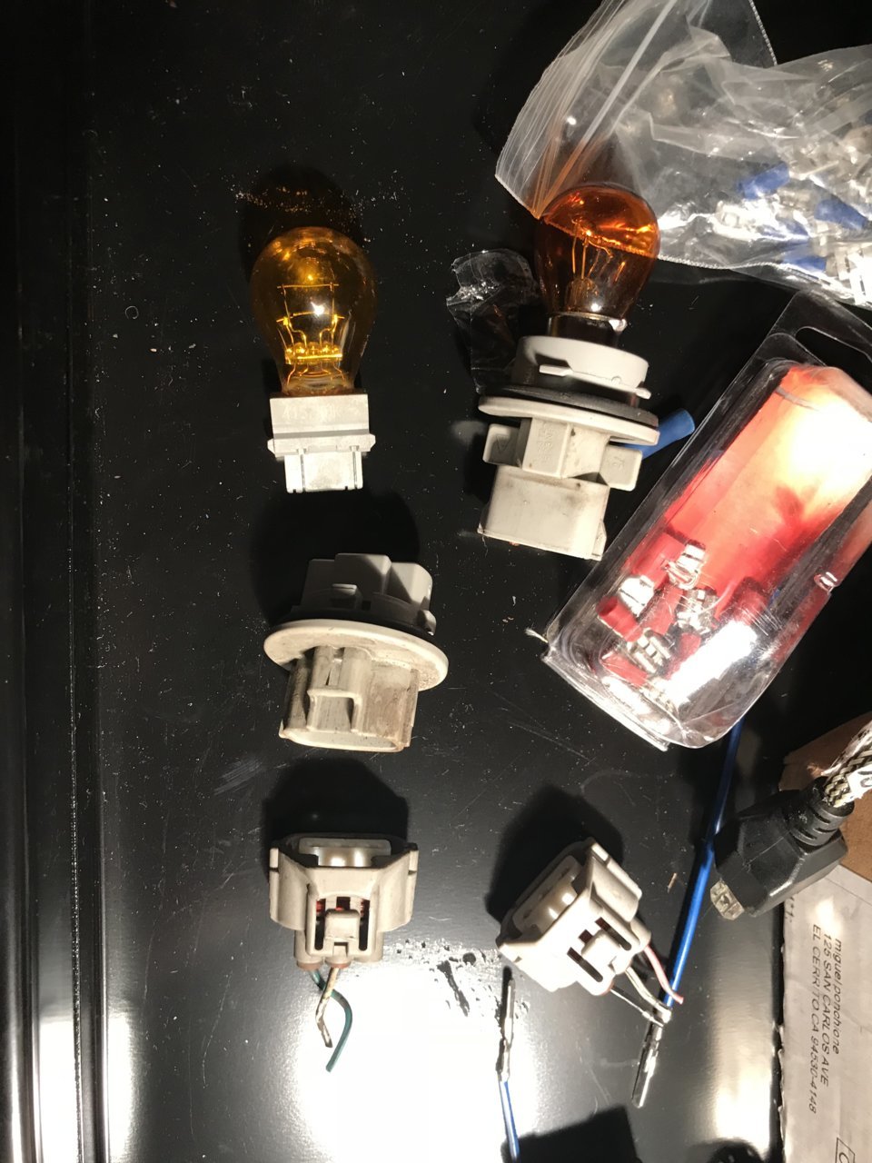

    20180424_155357.jpg Front bumper mounted turn signal got ripped off, leaving these 2 wires hanging. What do I need to get it all back in working order?

    The turn signal housing and bulb and the end for the wire harness

    I know that much, I just don't know what the end to the harness is called and where I can get it without spending an arm and a leg at Toyota.

    I think the part number for the plug is #9007560060

    Yeah I don't need that. I just need what plugs in to that. It got ripped off.

    So the part thats on the end of the wires is still there? Or no

    The part at the end of the wires is not there. It's just wires dangling.

    So what you need is the part on the bottom

    The piece on the bottom left with only 2 wires.

    Thank you so much, I've been looking for so long. So splicing the black and yellow wires should work? Just don't use the red?

    Yes, if you noticed in the pic i sent 1 had 3 and the other had just 2, both came of my truck at the same time, the 2 wire one was the original the 3 wire one was put on after the original was damaged. It only needs the 2 wires

    Alrighty, thank you. And just to clarify, splice black to black and yellow to yellow?

    Yes that should do it

    the white wire is ground (common for everything on Toyota) and the green wire is the signal.
    coincidentally, if you leave the 3rd wire in you can use it for DRL/fogs if you get CK-style bulbs. I used switch-back bulbs for lights and turn signal. you'd just have to wire up an aftermarket fog light switch to control the extra light.

    look at your other side for reference of which spot the wires go in, but @Sperrunner pic shows the correct location.
