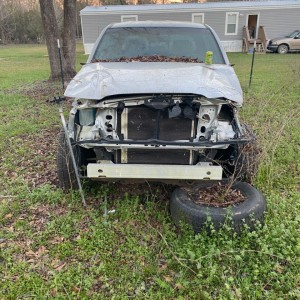

    I Purchased the truck wrecked and already disassembled

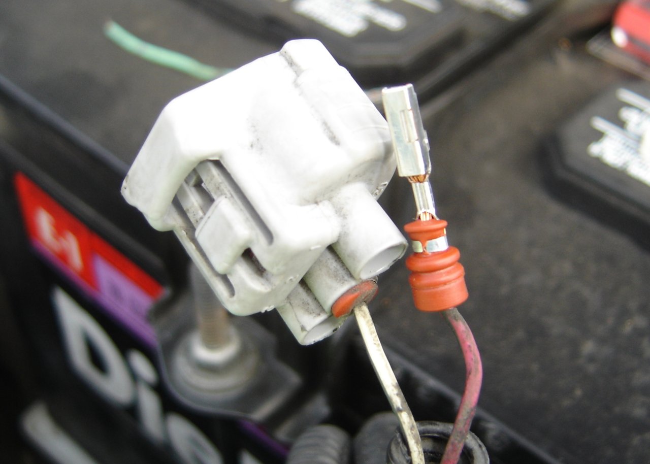

    Ok so the issue I have is the pigtails for the front turn signals were cut when the PO removed headlights and fenders. The pigtails I find online have 3 wires and the cut pigtails on my truck only have 2 wires. Can someone be so kind to snap a few photos of there front turn signal wiring and post them on here?
    Picture to show you the before

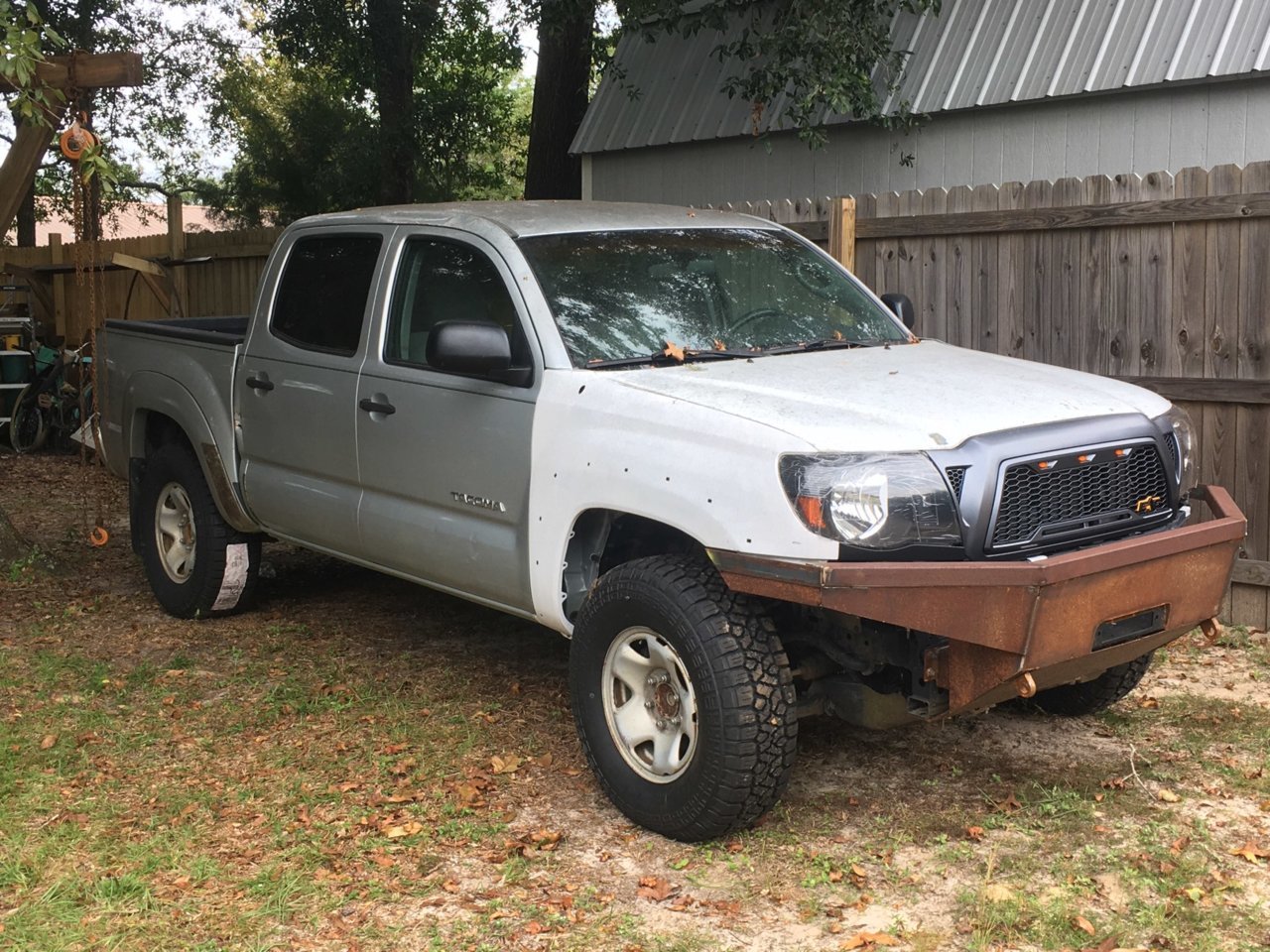

    Where its at now

    Sorry, I don't have pics, but the third wire is for powering the daytime running lights. Early gen2 didn't have daytime running lights so that's why your original wiring have only 2 wires. Get turn signal sockets that only have 2 wires.

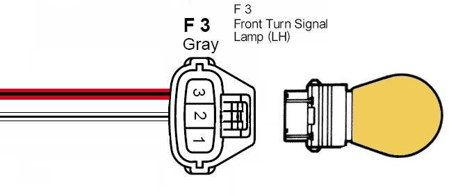

    That is incorrect. The DRL is part of the TURN signal circuit. The 2011+ have a dual filament bulb, one is DRL & TURN, the other is for Parking circuit. 2005+ have the 3 slot locations, one (parking) is plugged.
