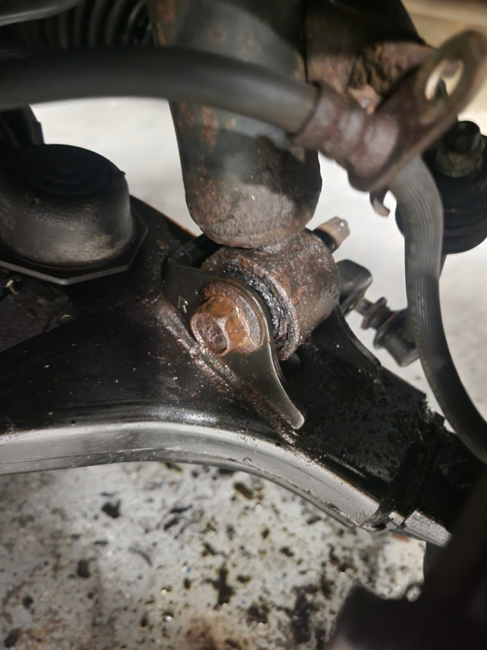

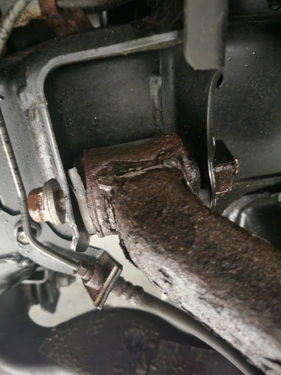

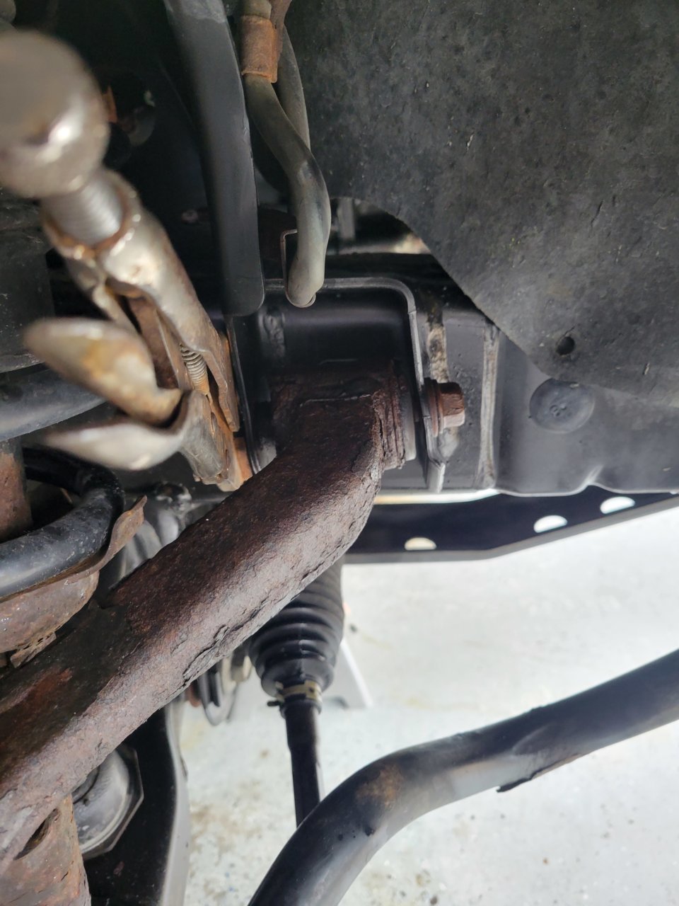

    Seems to be a common issue that these get siezed in the bushing. I'm no different there. I can't get these out for the life of me. I have heated them soaked them and negative they won't even turn. I'm just going to cut them out. I have a 5 lug so all the pics on upper control arms have the long bolt. I have 2 bolts and there us a square nut that is siezed in a capture piece on the frame. Question I have is can I just cut the whole thing off and put a nut and washer on it? Seems like a stupid design. Also if there are tricks to getting the upper ball joint to separate so I can get the shock out that is much appreciated. Soon I'll be leaving to go get a pickle bar or seperator.

    Have you tried fire yet? Pb blaster for a bit then torch it. Almost always works

    Pb blaster or Kroil and MAP gas.

    Yeah pb and heat for awhile now. Nothing. I only have Mapp seems like the bolt is actually stuck in the sleeve. I got one side loose with impact heat and pn the other isn't budging. The bolts hold the upper control arm are stuck except for 2 but now the square piece rotates with the bolt and I can't grab it without damaging the capture part of the bracket
  5. Dec 29, 2021 at 10:41 AM
    Flopjacks
    Flopjacks [OP] Member
    Dec 29, 2021
    #385771
    6
    Ok. I broke some of the bolts loose need a break. For people who come here, I used the heat up quench method. Heat the bolt, like really hot cherry red. Spray some pb on there. Beware of fire, my experience is it just get smokey but I don't want to be responsible for bad decisions. Then the bolts that hold the uca on.... well this is a stupid design. Almost all of the cages around the nut are now bent so the bolt will spin but I can't get the thing to loosen off. So... I pit vice grips on it. Same process with heat and spray. Here's a pic with vice grips. Moving forward I will probably replace the sq nut with an actual flange nut. I don't see the purpose of the bracket being like this. I will probably cut them off for clearance and then new nut and bolt. I will update after I complete.

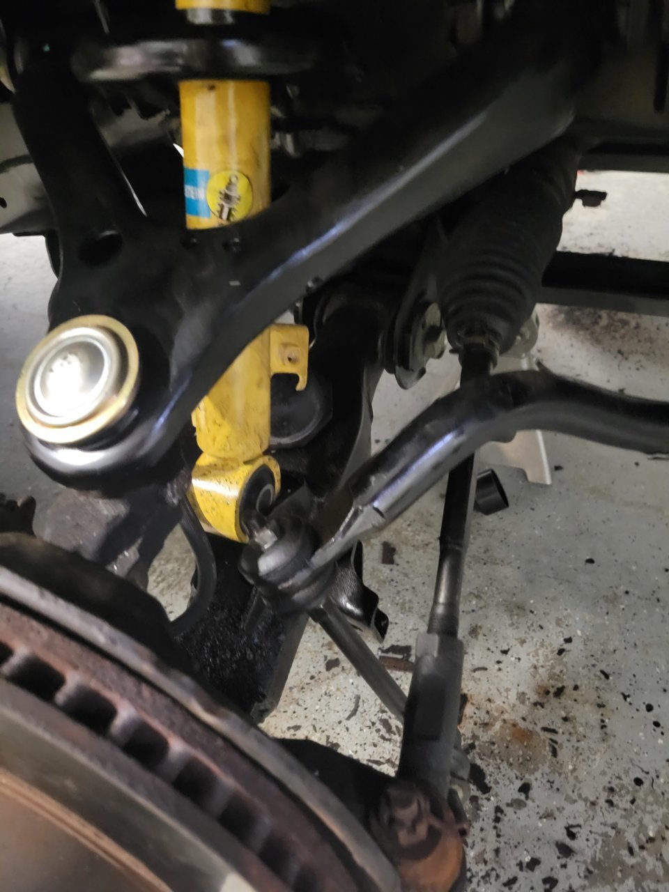

    I got one side in. Does anyone have a pic of the passenger side brake line shock mount position. I'm almost certain I installed this backwards. I have the flange on the shock towards the front. Frustrated now so I'm taking a break. This has been way more difficult than anticipated lol

    Here's a pic
