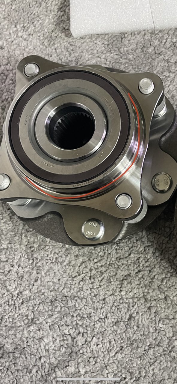

    Yes, pretty easy job. One thing that I’ve noticed is that there is a rubber (dust?) seal that goes on the outside of the assembly that does not come with this set. Use the one from the old hubs or order separately.
    I’ve marked the location of the seal on the pic attached.

    about 30 mins per side to replace preloaded hub
    FYI The Ones I got had the outer O-ring dust seal
    The O-ring was about 7.00

    It came with the O-Ring and Dust Seal for the rear side of the spindle.
