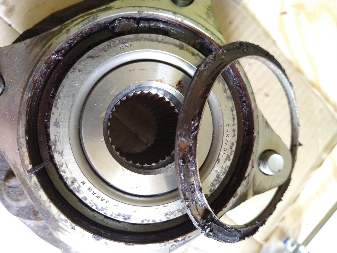

    Started taking things apart and I think I know why my bearing died. The dust cap that covers the axle nut had a hole in it! Last year Toyota replaced my brake caliper on that side, and no idea how but they must have punched a hole through that cover? Anyhow, now I need a replacement before I can put things back together. At least the old one came off easily.

    Debris past the dust cap does not reach the bearing. Nor is it necessary to remove it to replace the caliper. If the hole is small, I'd flatten the edges and put some JB Weld on both sides of the cap. Shoot, I'd even consider putting a piece of good quality duct tape, like T-Rex or Gorilla tape.

    Yeah, my first thought was Gorilla Tape Waterproof.
    That stuff sticks GOOD. My mother wrapped the water hose connection with that stuff.
    I took my forever to get that stuff off. All it really needed was a new washer.
    But she got the “drip” stopped. :rofl:
    I agree, the only way debris could make to the bearing is though the axle nut then seep down the axle. Unless the wheel is submerged in water higher than the the axle nut, I don’t see much of anything get to the bearings?
    Some guys put a thin coat of RTV on the edge of the seal. I never have, but some guys do.
    I don’t do deep water crossings and I don’t like mud. ;)

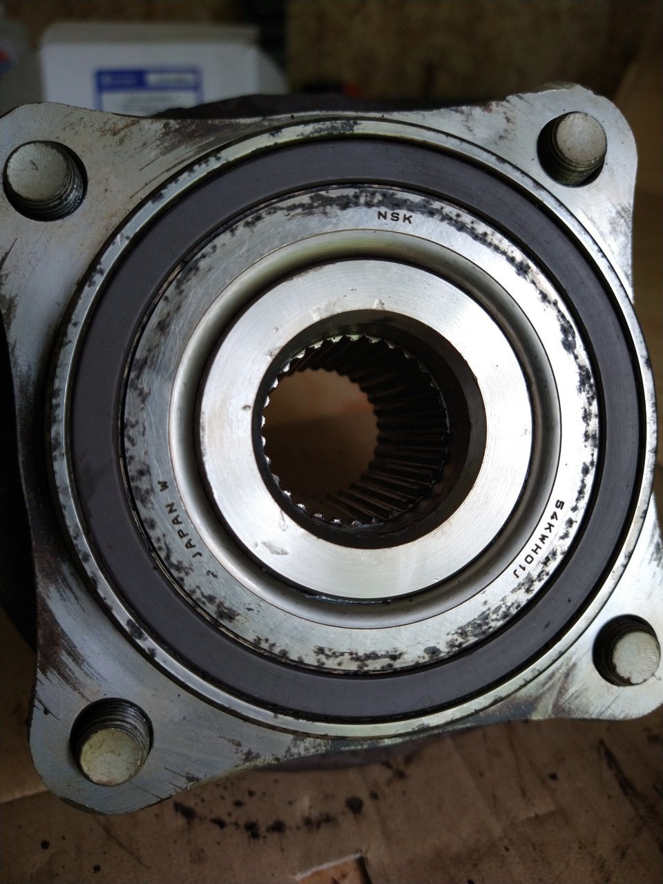

    I still am going to replace the cap with an unbroken one. And also not sure if this makes a difference but my old bearing didn't have the o-ring on the inside.
    And yes, tnshooter posted the right part number.
    Questions for people who have done this....
    Should the axle splines have grease on them? There was a lot of red grease on it when I took the old one off. Was this from the bad bearing?
    Also, should I put any grease around the axle but or inside the dust cap?
  16. May 29, 2021 at 11:58 AM
    #36
    TnShooter
    TnShooter The TacomaWorld Stray
    Sep 2, 2010
    #42625
    21,392
    Deogee
    07' TRD Off-Road, Auto
    STOCK
    A thin coat shouldn’t hurt the spline.
    I usually do this, but sometimes I don’t. (If I don’t have any)
    A THIN coat. You don’t want grease on the threads where the axle nut goes.
    As for the O-Ring. Yes, you need it.
    Otherwise, water can get between the spindle and hud.
    That’s more important than the dust cover.

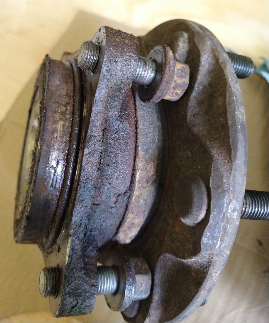

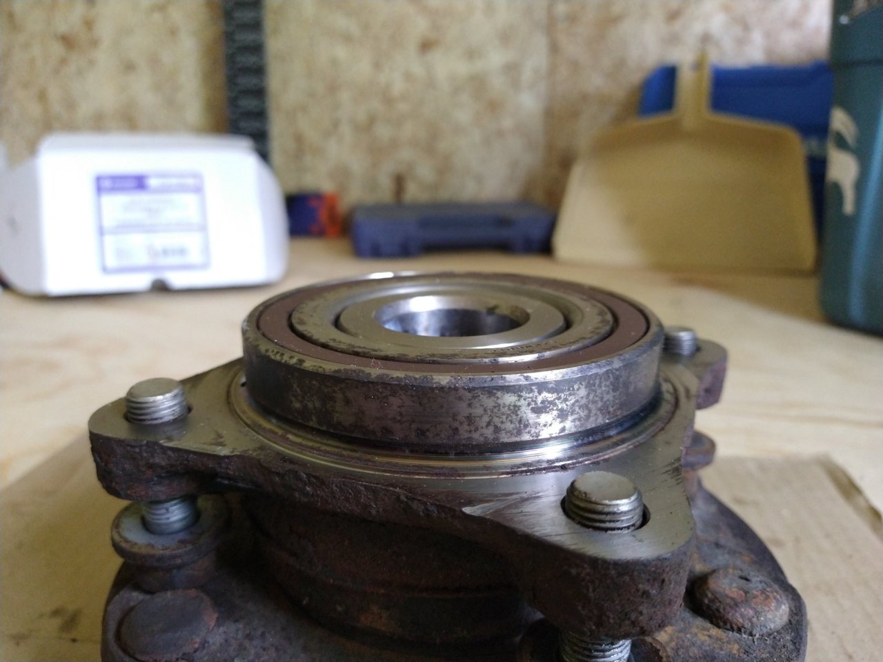

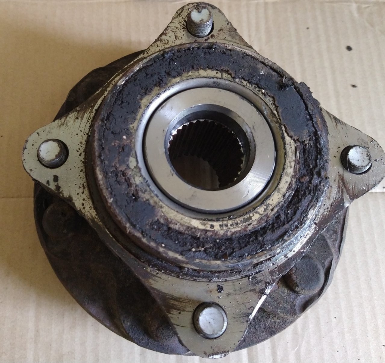

    Can anyone offer an explanation of why these front wheel bearings (or their hub assemblies) are failing relatively prematurely in many cases? My 2011 TRD Sport is now getting its third set on the front after 108k miles, after all four wheel bearings/assemblies were replaced (under warranty) at 40k miles. Below are some pics of the latest victim, front driver's side. This truck is a highway princess, and western Canadian winters, so relatively low salt and crud exposure. It appears that either the dust seal/o-ring combination isn't keeping anything out for very long considering the amount of pitting on the inner assembly and exposed bearing surfaces after only 5 years. Overall I wonder why I'd bother buying a more expensive bearing/assembly if it is the outer sealing that is the ultimate weakness and I will be replacing every 5 years.
    Second question. Does Dorman do different bearings in the same hub assembly for different price points? I see Amazon sells a cheaper Dorman option (model# 950-001), and NAPA (Canada) sells a Dorman Part #: OES 77010691 for a lot more. The one in the pics below is a Toyota (Canada) warranty replacement with NSK bearing, which I assume is an OEM part?
    Thanks in advance.

    Are you replacing the inner and outer dust seal when doing the bearings?
    One is on the CV axle the other is on back side of the spindle.
    I do see the O-Ring , so we know it was installed.
    I don’t replace the seals every time, but you SHOULD.
    In your case, I’d definitely see if they have been done. It kind of looks like you may have water intrusion somewhere?
