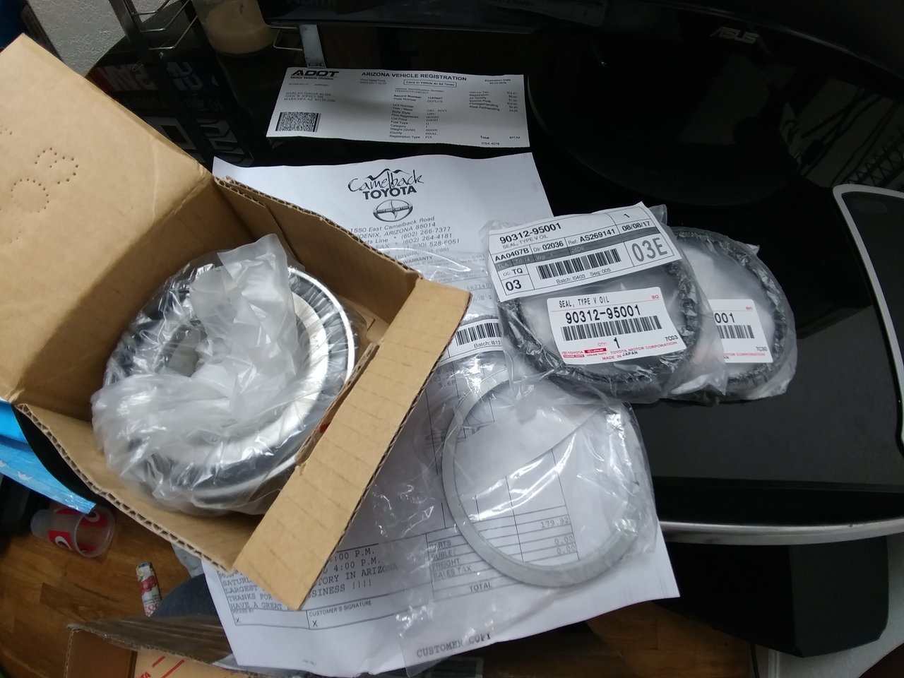

    oem. Which i think is koyo. I just received mine from camelback toyota. $71.36 ea for mine. Pm @gunny1005 with your oem part # or vin and he'll take care of you.
    (i also got new seals and snap rings)

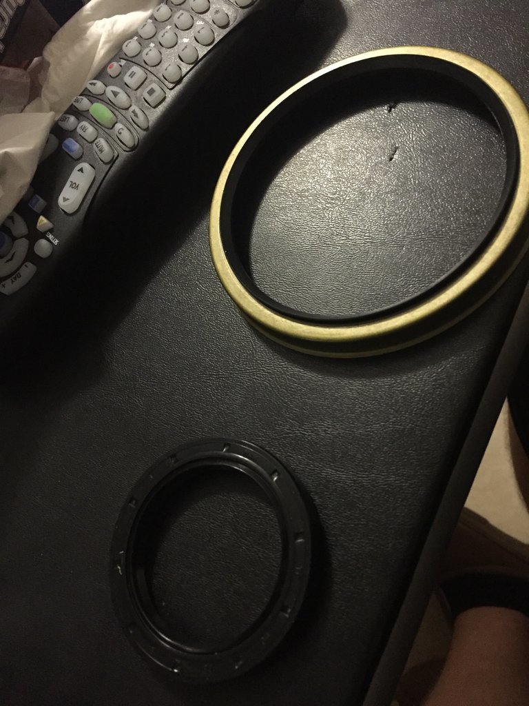

    Is one larger than the other in diameter?
    These are the one the local auto parts store said I needed. But I can't find any info online that agrees with them. Fsm part numbers don't match and can't find a photo of the inner seal searching google with the part numbers the fsm Cals out.
    Pulling it all apart tomorrow and taking to the shop Monday to be changed so I'll update this thread with the correct seal info

    Well, if its the same for 96-04, (mine is an 01)
    Seals:
    90312-95001 R/L
    Lock nuts
    43521-35010 R/L
    (which are pretty much needed too btw. Could possibly be reused but one of mine had to be cut off as the tool couldn't get it off they said. Besides I think they're supposed to be a one time use lock nut).
    I also got new snap rings:
    90521-99114 R/L
    Idk anything about an inner seal and my diagrams dont show it. The only other things inside would be the non abs spacer(reusable) in place of abs rotor, abs sensor rotor(if abs) and grease caps.
    Edit: Just had these done recently by Napa. They had difficulty with one and said it took everything their 20t press had to get it free.

    There are 2 seals for ADD. One larger, one smaller.
