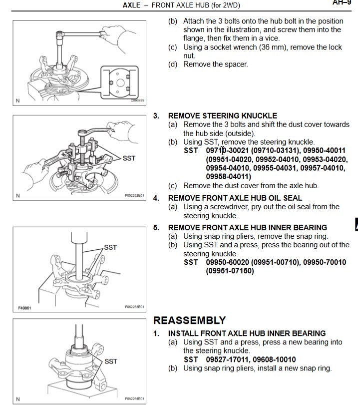

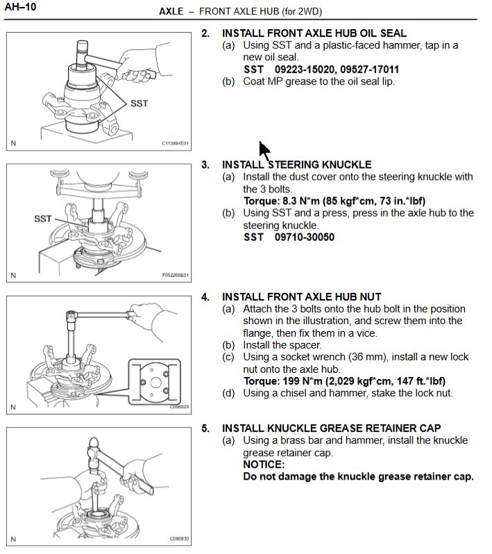

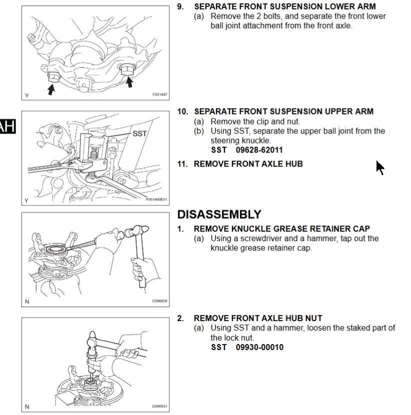

    The 5 luggers the bearings and seals etc are all pressed into the steering knuckle. You have to remove the steering knuckle disassemble it press out the old and then press in the new. Giant pain in the rear.

    After you remove the Steering knuckle from the truck follow this:
