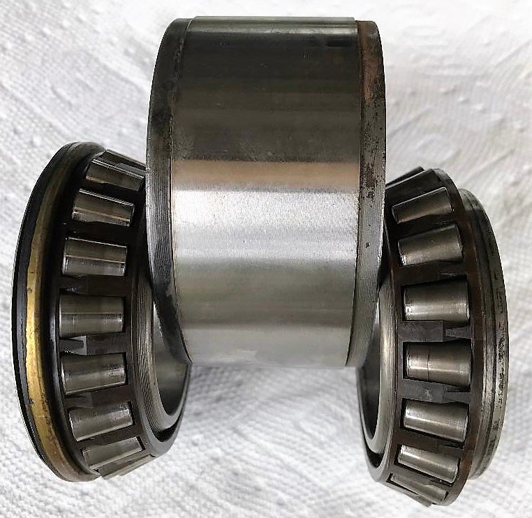

    WOW! I wish. The super-harsh deep mud/high water conditions here in MS had my original front wheel bearings in my '97 V6 Taco 4x4 screaming at me in just 50K miles & on its 4th set of KOYO DU5496-5 sealed wheel bearings in 138K miles. It really should have been the 3rd set. But the last shop pressed both the front wheel bearings in backwards with the metal shield/seal to the inside causing both bearings to fail in under 5K miles. Preload of the front wheel bearing cannot be properly set or maintained when the bearing is pressed in backwards. My wet environment uses parts up quickly, normally from grease washout after the fine sand in this muddy water eats the seals up causing them to leak. Using a marine grade EP grease even in sealed bearings appears to be of value to me with this problem.
    Very lightly used KOYO DU5496-5 front wheel bearing parts: Outer roller bearing with the metal shield/seal on left and inner roller bearing on the right. The inner roller bearing has a black seal over it.

    Are there specific orientation markers on the bearing itself that points to the proper direction?
    Or is a metal shield all there is?
    1997TacomaSR5 likes this.

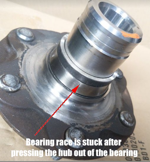

    How did he remove the bearing without obliterating it? On the 6 lug, when you press the hub out from the bearing, it splits the bearing. At least it has for me each time I've done it. You're left with half the bearing race literally frozen to the hub. Heat and careful cutting are about the only way I know of to remove it.
    Mechanic was full of it. Guess he was thinking about the 5 lug.

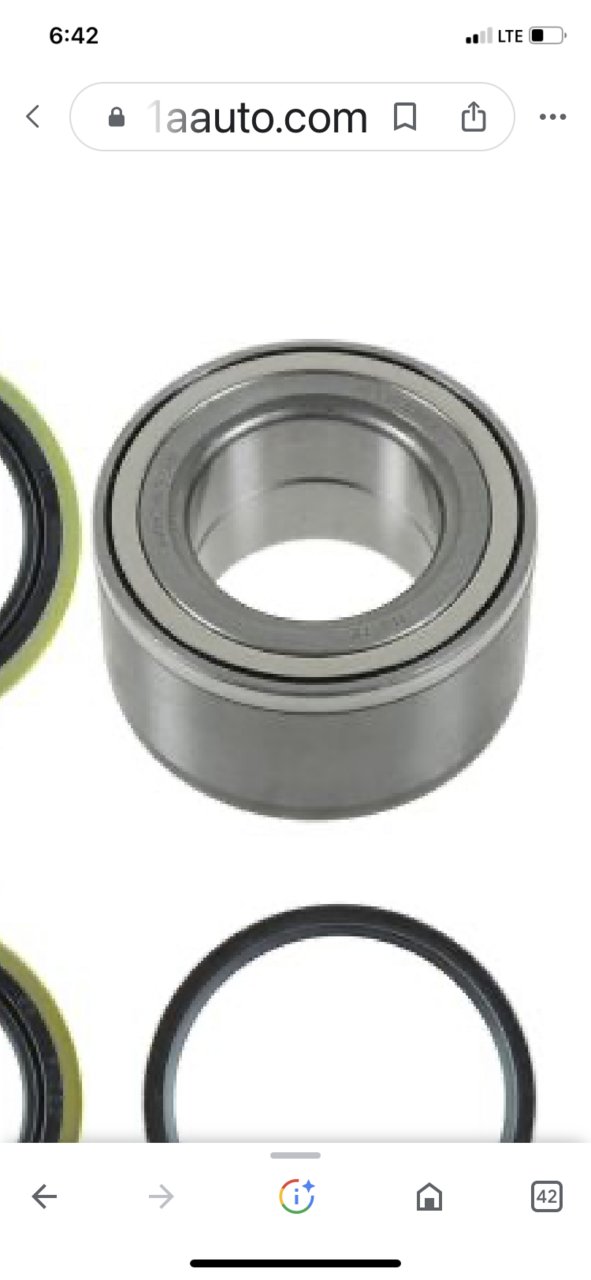

    99 PreRunner 4x4 2.7
    this is your front wheel bearing, once its assembled it is impossible to grease. They suck. If the outer race had a grease groove like most bearings of that nature, you could drill a hole through knuckle, tap it for a greasefitting and never have to teplace them...IMG_0611.png
