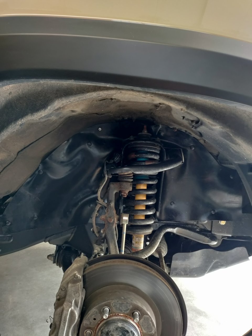

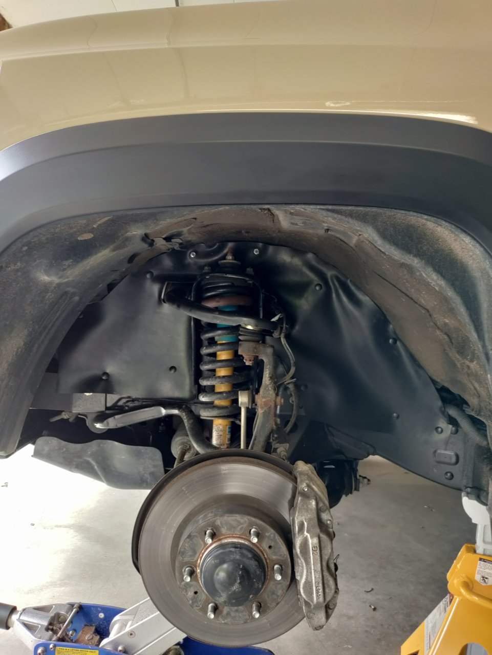

    There are a couple screw bodies that stick out into the wheelhouse on the driver's side and 1 on the passenger side. I poked a hole in the guard with a pencil and secured it with a nut onto the screw bodies. The passenger side body seems to be a less common diameter and pitch, so I just lightly cross threaded a nut I had onto it
    driver side-2 above shock tower
    Passenger side-1 rear of shock tower

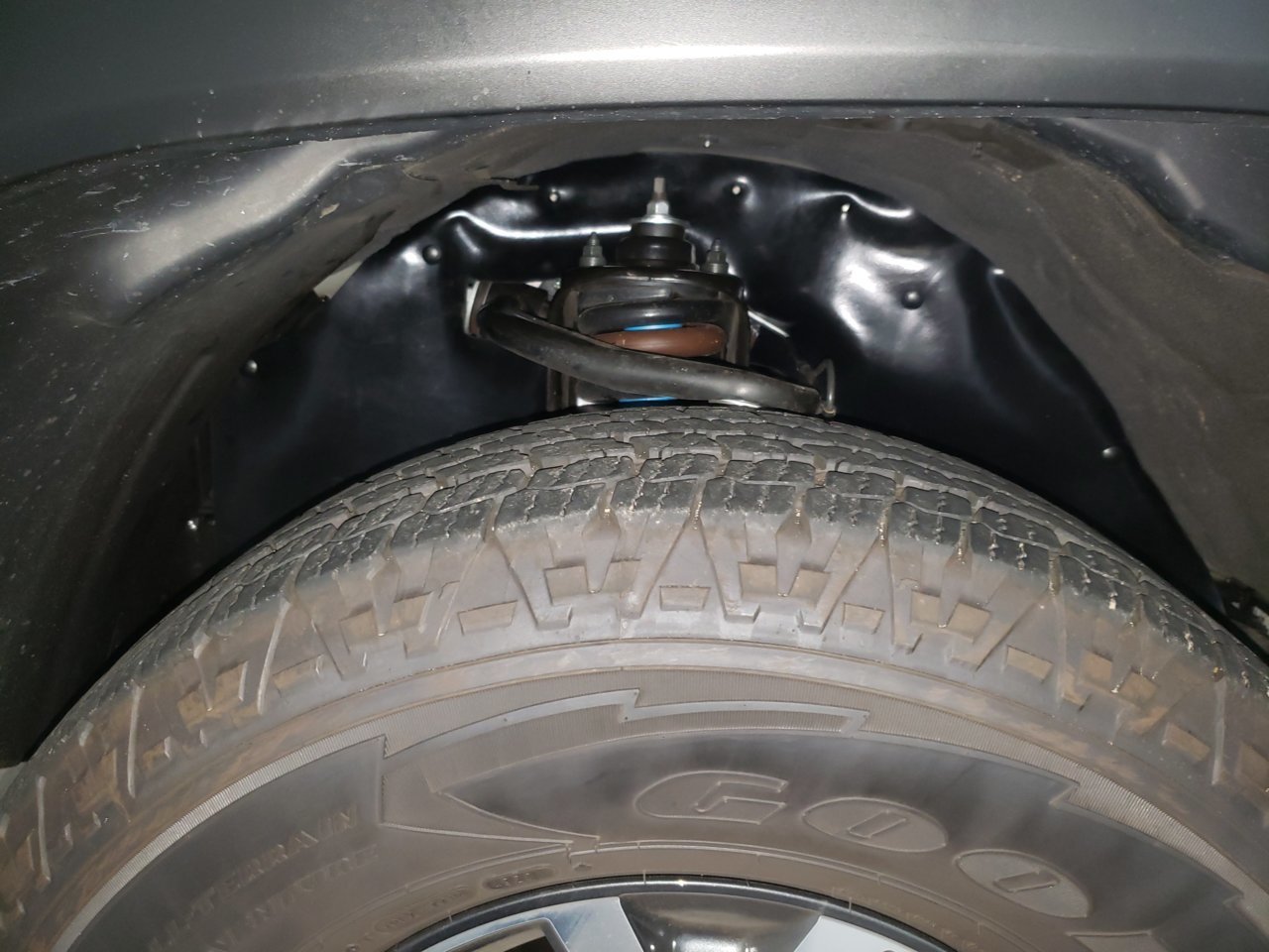

    Just installed them and they definitely provide more coverage than beforehand. Thanks for making these, they are well worth it!
    I highly suggest taking the wheel off to make it easier.
