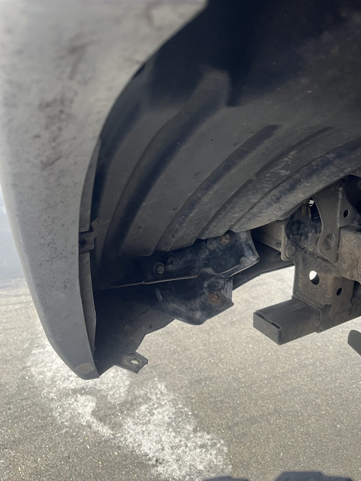

  9. Dec 24, 2023 at 2:56 PM
    #29
    Hohocakes
    Hohocakes Member
    Nov 29, 2017
    #237254
    12
    Toyota Tacoma 2014
    Here is what I did on my 2014. Instead of cutting I pushed in and folded the wheel well liner in and bolted by one point. Bolted by the inner point. Just need cut off the extra tap and make flush with the other. Running 285/75/17.
