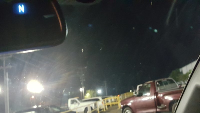

    Much better improvement and thanks guys for help and would like more help on getting the remainder of it off. This stuff is only visible during the night under streetlights.

    As a former professional detailer, I used this stuff a lot and really like it. Also, I don't know if it's been mentioned, but the film is going to keep coming back pretty often for a while because all you interior parts are "gassing out." It will get to be less and less over time.

    That Sprayaway is good shit.

    Get a white scotchbrite pad (one of your wife's cosmetic pads will do) and either alcohol or
    white vinegar. White scotchbrite is very fine and will not scratch glass and the alcohol or
    vinegar will dissolve the Rain-X and later road grime. I prefer Stoner's Invisible Glass. Be
    aware that the windshields on the 2016 Toyotas are very susceptible to cracking, pitting
    and scratching.

    do you use the rain-x spray, or windshield wiper fluid/ new rain-x blades that apply it....I use the blades and washer fluid, and have never had the haze problem...never used the spray though
