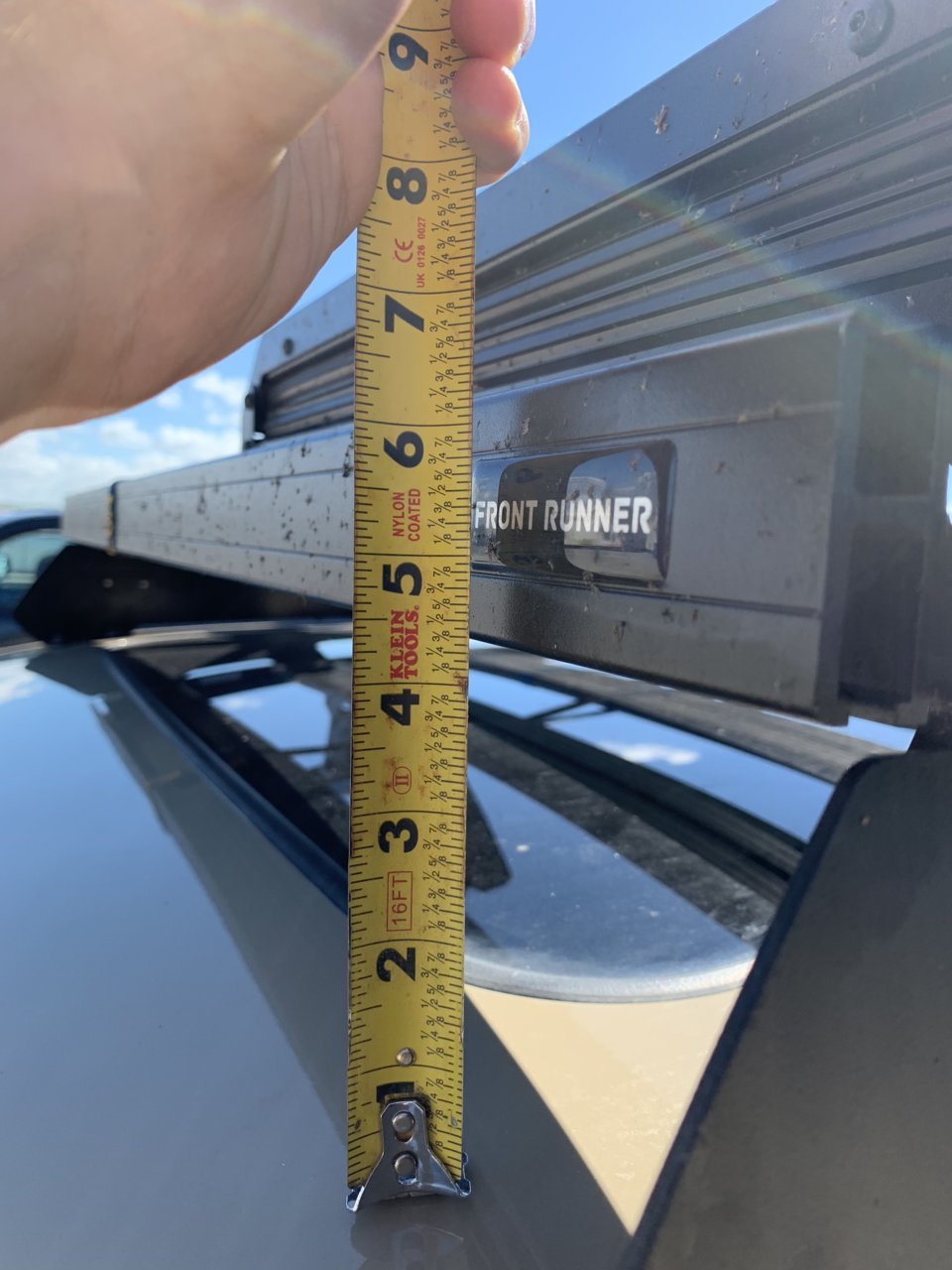

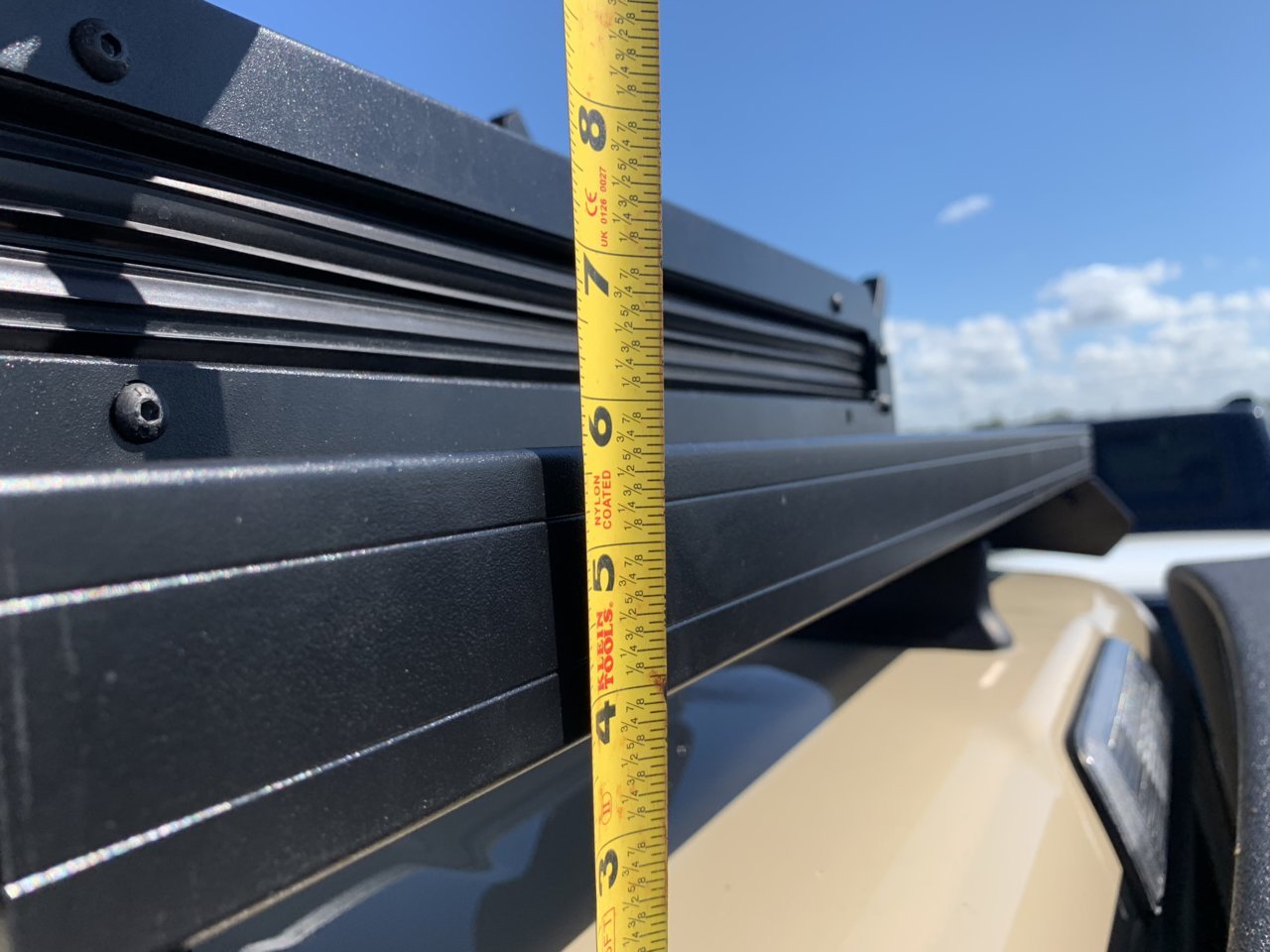

    What’s the height from the cab to the top of the rack?
    Website says measure the rack and foot rail but nothing gives the height of the foot rail.

    Are you asking me about heights?
    I just took some measurements. See photos of side, rear, and front height from roof.

    Perfect! Thank you!!

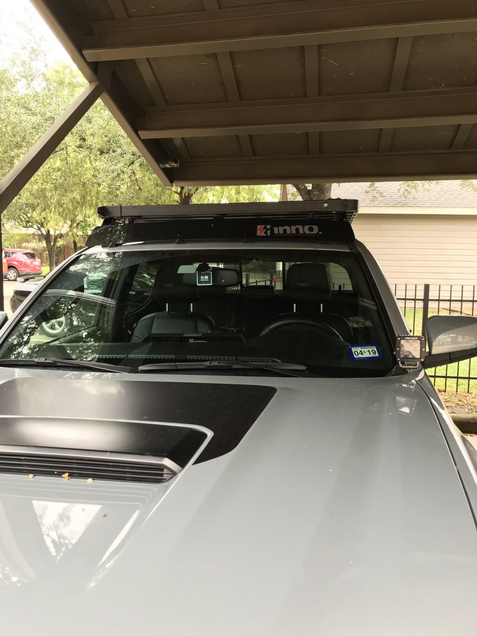

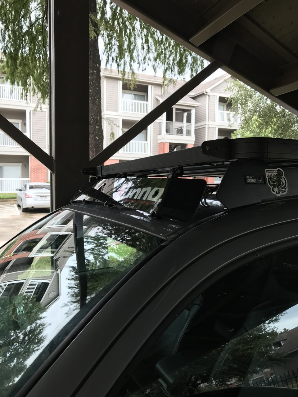

    Did I ever show any of y'all this? Looks better and keeps sound down.

    That looks pretty cool. I found the link as well.
    Does the Innocences sticker peel off? I wouldn't want that on there. And it looks like the mounting gets in the way of adding attachments to the forward bar. Is that the case?

    How do you like the wind dampener??

    I like it a lot! Seems to work well.

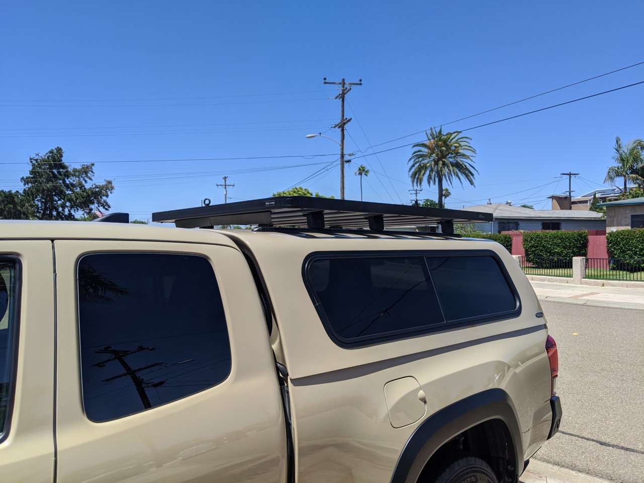

    I like the looks of the low version better. I set the height so that the wind deflector was about an 1/8" off of my Snugtop XV. This is the upgraded version of the Rebel. The only problem with this setup (after a 1,500 mile trip) was that the 2 piece mounts did not maintain their height. This caused the deflector to rub some paint off of the shell. To remedy this, I put an aluminum spacer inside of each mount and drilled a hole for the height adjustment screw at the fixed height that I wanted for the rack.
