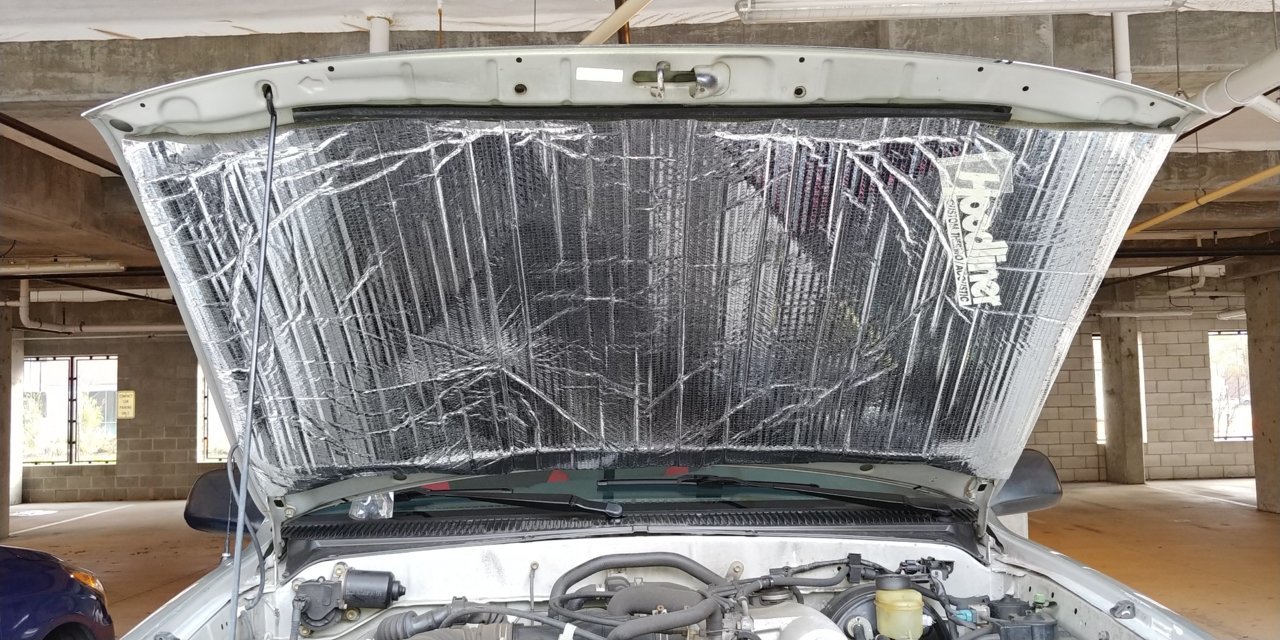

    And Dynamat Hoodliner under the hood
    https://www.amazon.com/gp/product/B00069QLVC/ref=ppx_yo_dt_b_search_asin_title?ie=UTF8&psc=1

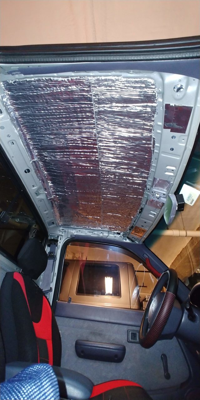

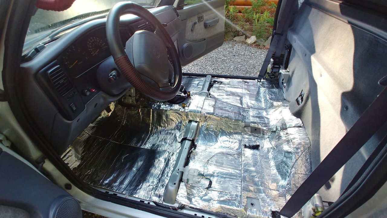

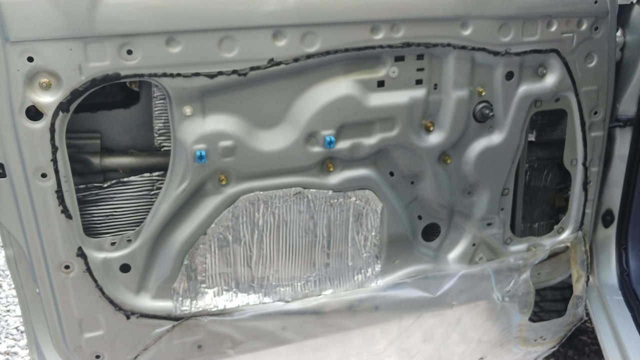

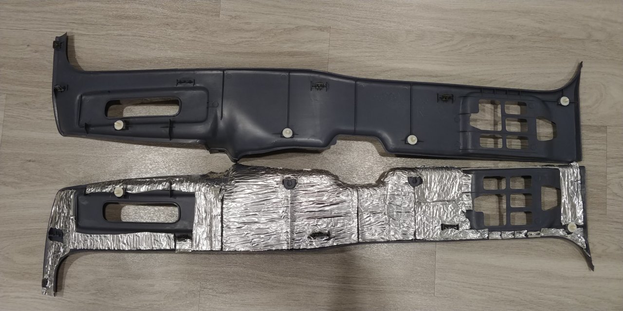

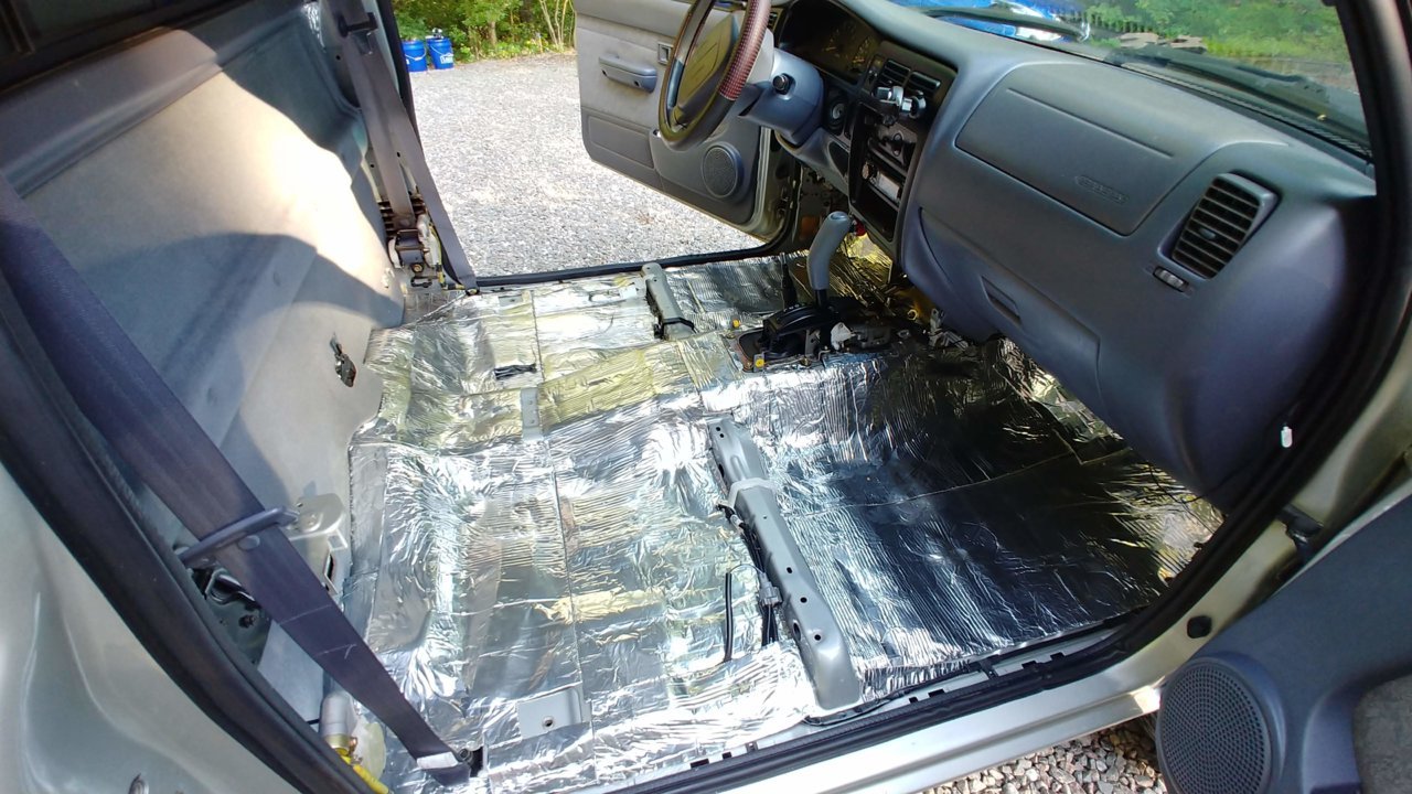

    Below are the finished product of insulating each component. In some cases, where space allowed, I doubled or tripled the layers in order to help with point-sources of noise and/or heat, e.g. the middle hump through the cabin where the transmission is. I had to leave some areas bare in order to properly fit the carpet/panels that had to go over top of it. For the floorboards, I added as much as I could to the firewall facing the engine. I could get it a little higher than the carpet, but that still leaves a huge space behind the dashboard uninsulated.
    Also note that installing insulation will result in lots of small pieces that are seemingly useless. I was so gung-ho about this sound damping that I even used these pieces and slid them into holes and gaps in places like the A and B pillars. You’ll also see that I even went through a LOT of trouble to apply insulation to the underside of the cabin tupperware, such as the parts that cover the:

    In other words, I don’t know how much more I could have done.

    After insulating everything listed above, the sound readings did not change. That means the insulation, both the Frost King and Duramat, had absolutely zero effect on the noise level in the cabin.
    You can imagine my disappointment.

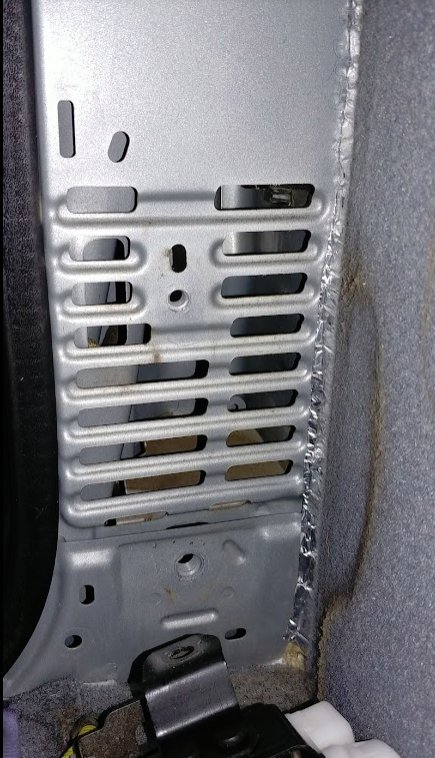

    I would like to discuss what I think is the greatest source of noise in the cabin. You can see my original thread here:
    https://www.tacomaworld.com/threads/sound-damping-rear-cabin-vent.594886/
    The highest noise readings I got in the cabin was pointing the sound meter at the rear cabin vents, up to 83 db, which is approaching a sound level is perceived to be twice as loud as the ambient noise in the center of the cabin.
    I am no longer interested in trying to add more duct insulation. However, I think that trying to fix the noise intrusion from the cabin vents may be worthwhile and a last-ditch effort. I’m thinking of cutting out a few of the metal slats, perhaps the bottom 3 to gain enough access to stuff some type of insulation in there that would still allow the air pressure in the cabin to equalize when the doors are closed. I would welcome suggested on specific products that won’t hold moisture and can be squeezed and then expand.
