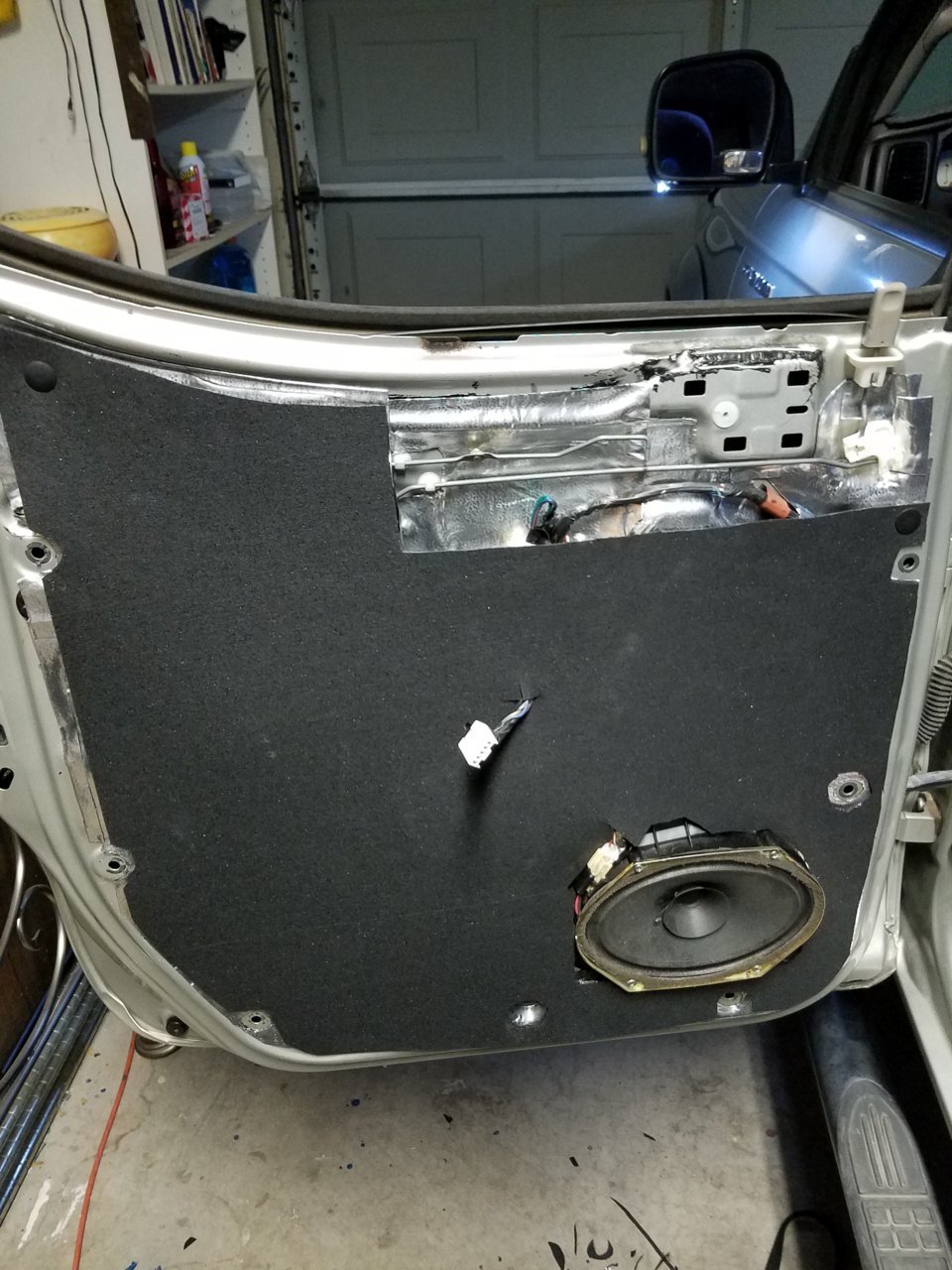

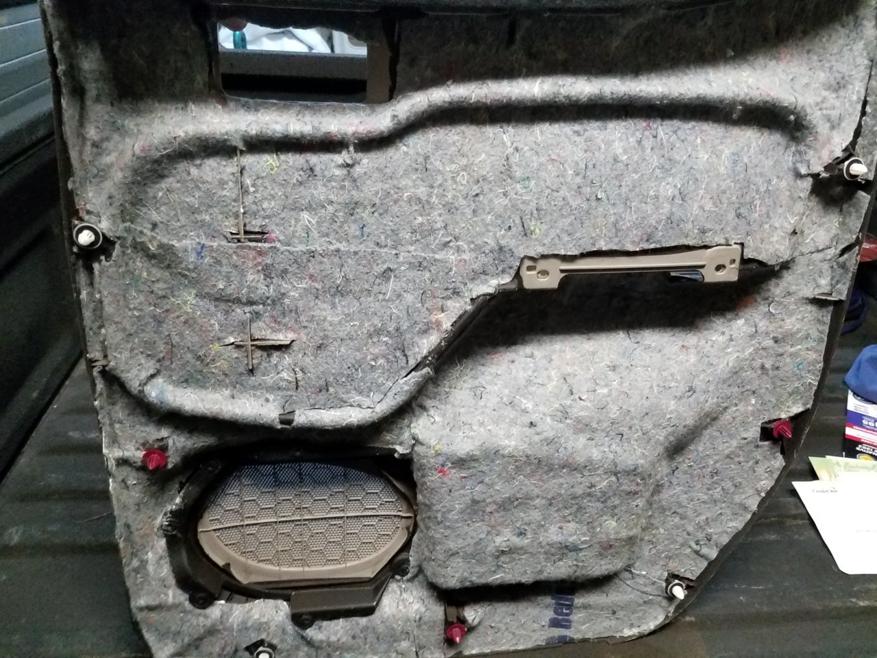

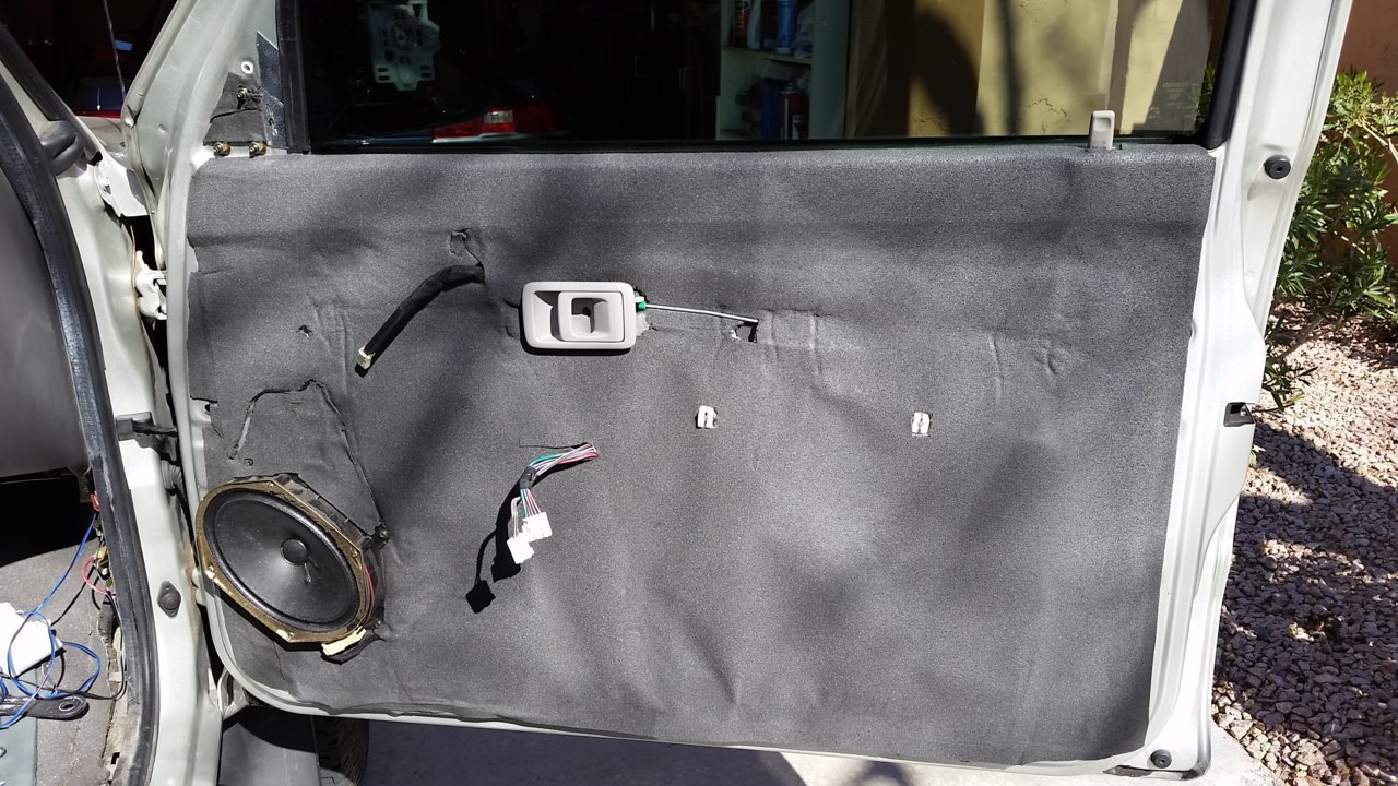

    This is what I added to my door panels with a noticeable change. 1/8 rammate foam, sound deadner, mass loaded vinyl and as crazy as it sounds UHaul moving blankets. Used spray adhesive to hold it to the back of the door panel.

    @mechanicjon . Did the moving blanket really make a difference Is it more to stop the rattels?

    It made a difference to my ears. If it was the sound deadening mat or the mass loaded vinyl or the blanket that did the most. I don't know I did all 3 at the same time.
