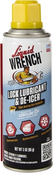

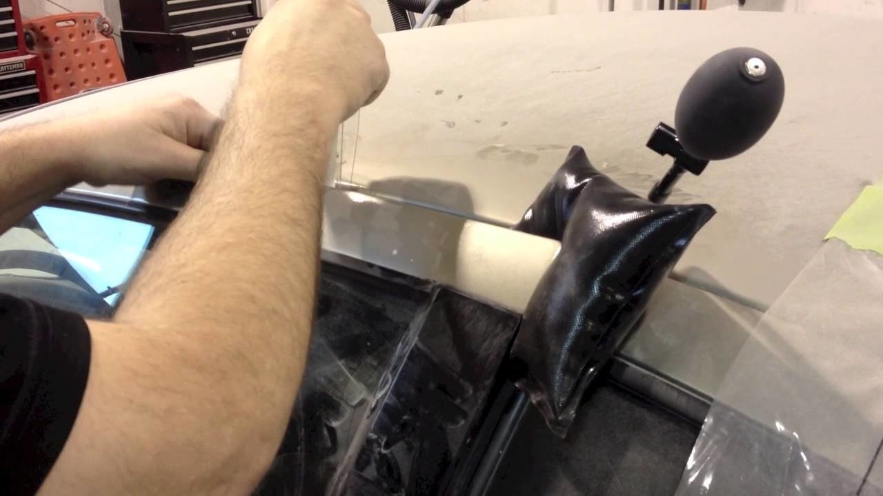

Frozen and dead. Help!
Discussion in '3rd Gen. Tacomas (2016-2023)' started by Bullitt, Feb 6, 2019.
  1. Feb 7, 2019 at 1:04 AM
    #21
    USPfan
    USPfan Well-Known Member
    Jul 27, 2018
    #260760
    265
    North of 60th paralell
    2018 Tacoma TRD OR DCSB
    Good luck!
    Are you running the stock battery? I started my truck after sitting idle for 1 month in the NWT (temps have been a steady -30c to -40c for weeks) and it started up instantly (plugged in of course). I'm using a Northstar AGM.
  2. Feb 7, 2019 at 1:07 AM
    #22
    m603holden
    m603holden @Koditten Pirate Radio member #063
    Oct 18, 2014
    #140581
    11,732
    Marteeen
    New England
    2017 Tacoma DCSB OR MT
    Lots of sail boat fuel
    $5 says the door is unlocked and just frozen shut. Visually verify the lock from the passenger window.
    Edit: I say that with love. Tone doesn't translate well on here .
    They key should mechanically open it being an MT
    Last edited: Feb 7, 2019
  3. Feb 7, 2019 at 1:28 AM
    #23
    Talk comb a
    Talk comb a Well-Known Member
    Aug 23, 2017
    #227739
    46
    Ontario, Canada
    14 AC/TRD OR MGM
    That's what I was thinking. Maybe crack the window gasket and fire some hot air from a blow dryer down in to the door for 20 minutes or so.
  4. Feb 7, 2019 at 1:30 AM
    #24
    koditten
    koditten Well-Known Member
    Sep 8, 2013
    #112077
    19,762
    Kirk
    Central Michigan
    04 trd x-cab 4 x 4 3.4l
    Reserected from the dead.
    Turning the key twice opens the passenger door as well.
    Skidog1 likes this.
  5. Feb 7, 2019 at 1:36 AM
    #25
    m603holden
    m603holden @Koditten Pirate Radio member #063
    Oct 18, 2014
    #140581
    11,732
    Marteeen
    New England
    2017 Tacoma DCSB OR MT
    Lots of sail boat fuel
    Correct . Electronically. The driver side should be mechanical. Not sure why a new truck wouldn't open with a key. I'll have to check my lock when I get out to see if it can be forced
    Clearwater Bill likes this.
  6. Feb 7, 2019 at 10:49 AM
    #26
    wilcam47
    wilcam47 Keep on keeping on!
    Jan 27, 2016
    #176243
    54,733
    Will
    Bourbon state
    Thats just a safety feature so you dont get vandalized. The only reason I said jumper it to the starter is to get power back to the battery. Obviously it wont start but if you hit the negative on the the starter it will turn over...
    shane100700 and Chipskip like this.
  7. Feb 7, 2019 at 10:52 AM
    #27
    BillsSR5
    BillsSR5 Looking out for #1
    Apr 12, 2017
    #216032
    8,654
    bill
    2014 SR5
    have it towed to a garage before something else gets broken
    cascadetaco likes this.
  8. Feb 7, 2019 at 10:55 AM
    #28
    BillsSR5
    BillsSR5 Looking out for #1
    Apr 12, 2017
    #216032
    8,654
    bill
    2014 SR5
  9. Feb 7, 2019 at 10:57 AM
    #29
    Clearwater Bill
    Clearwater Bill Never answer an anonymous letter
    Oct 11, 2014
    #140097
    24,678
    Billy
    Largo Florida
    '13 5 lug AC w/convenience package
    A few OE parts from fancy trucks
    Even if you get in, hood opened and able to jump, has the truck been connected to a block heater?
    Isn't there a risk at those temps of the cooling system being frozen, or even damaged?
    Chipskip and transworldmoto like this.
  10. Feb 7, 2019 at 11:01 AM
    #30
    BlakeM
    BlakeM Well-Known Member
    Jan 9, 2017
    #207016
    1,413
    Blake
    Gonzales, LA
    2023 T4R.SR5.4WD.OMG.LOL.WTF
    This is why chain saws were invented. Or is your chain saw also frozen?
    AugustusJack likes this.
  11. Feb 7, 2019 at 11:13 AM
    #31
    Tacoma2020
    Tacoma2020 Well-Known Member
    Sep 9, 2018
    #265725
    1,320
    That’s why garages and heaters were invented.
    BillsSR5 likes this.
  12. Feb 7, 2019 at 11:14 AM
    #32
    BillsSR5
    BillsSR5 Looking out for #1
    Apr 12, 2017
    #216032
    8,654
    bill
    2014 SR5
  13. Feb 7, 2019 at 11:33 AM
    #33
    bajatacoguy
    bajatacoguy Well-Known Member
    Apr 22, 2013
    #102609
    3,232
    Johnny
    RI to NH
    Blk Taco
    OEM: Bed Mat Roof Rack Tri-Fold Tonneau Cover Door Sill Protectors KO2's Dobinson GTS Suspension TRD Beadlocks Timbren Bump Stops SPC UCA Rear SuperSpring SSO Slimline Winch Bumper SmittyBilt x20 Mobtown Sliders Mobtown Front Skid Avid Basket Bed Rack DECKED Draw Organizer Total Chaos Bed Stiffners Relentless Fab Bed Corner Tie Downs CBI Ditch Light Brackets ARB Dual Compressor Instant Air Tank Smittybilt RTT Road Shower II Indel-B Fridge/Freezer w/ Slide Ironman 4x4 Insulated Fridge Case Redline Tuning Hood QuickLIFT Yo_Hec - Center Console Molle Little Johnny III CB Radio KB Voodoo Flashlight Kit Switch Pro 8100 BlueSea Fuse Pelfreybilt Fuse Panel Mount Gecko - LED Bed Lights Gecko - LED Hood Lights Raptor Grill Lights Cali Raised - Bed Flag Pole Holder Center Console Tray & Organizer Weather Tech Floor Mats Weather Tech Hood Deflector TRAILER BUILD HAPPENING! Plate: Negan
  14. Feb 7, 2019 at 11:52 AM
    #34
    svdude
    svdude Well-Known Member
    Sep 30, 2012
    #88055
    824
    jonathan
    Let's say that plug does go straight to the battery (without powered relays), I don't think the wires can handle any real amperage to give your battery a real charge in any decent time.
    If you try this, keep a close eye on your truck. If you put too much juice through the wires you're likely to let the smoke out. Once the smoke is released then something isn't gonna work when you want it to.
  15. Feb 7, 2019 at 11:56 AM
    #35
    savin yours
    savin yours Well-Known Member
    Sep 18, 2018
    #266644
    830
    Bryan
    SE Tx
    2018 TRD Off Road
    I love Texas
    AugustusJack and Tacoma2020 like this.
  16. Feb 7, 2019 at 11:58 AM
    #36
    TacomaSport86
    TacomaSport86 2010 Tacoma/2016 4Runner Pro
    Dec 17, 2018
    #276093
    1,976
    Hmm I thought a dead person posted...would have been a first here I believe.
    Spare Parts, fatfurious2 and SR-71A like this.
  17. Feb 7, 2019 at 11:58 AM
    #37
    koditten
    koditten Well-Known Member
    Sep 8, 2013
    #112077
    19,762
    Kirk
    Central Michigan
    04 trd x-cab 4 x 4 3.4l
    Reserected from the dead.
    I was under the impression he only wanted enough juice to operate the remote door locks, not jump start it.
    Chipskip likes this.
  18. Feb 7, 2019 at 12:07 PM
    #38
    SR-71A
    SR-71A Define "Well-Known Member"
    Jun 1, 2018
    #255145
    7,893
    Zack
    Southern Maine
    2012 DCSB, TX Baja Edition. Barcelona Red
    255/85/R16 Falken Wildpeak MTs, Mobtown sliders, ARB bar, SOS front skid, Icon RXT leafs, extended & adjustable Kings, JBA UCAs, OVS wedge RTT, dual AGM batteries, Gen2 xrc9.5 winch, CB, GMRS, S1 ditch lights...
    Yup. Unlock the doors, pop the hood and charge/ jump it from there
    tcjacado, shane100700 and wilcam47 like this.
  19. Feb 7, 2019 at 12:19 PM
    #39
    Tacotickler
    Tacotickler Active Member
    Mar 10, 2018
    #246883
    36
    16 TRD sport DCSB 4x4 6MT
    Do the 17's have the power sliding rear window? If not you could try and push in and slide that open from the bed and have someone small enough to fit threw or jimmy rig something to pull a door handle?
  20. Feb 7, 2019 at 2:41 PM
    #40
    TRDCal
    TRDCal Well-Known Member
    Feb 2, 2016
    #176893
    307
    Canada
    2018 DCSB Sport MT
    Had this happen in my old 4runner, battery died after being frozen for 3 weeks and the key locks were rusted solid.
    Local taxi in Montreal had a door unlocking kit. I'm sure at least your local tow trucks would have something similar. It's a small inflatable wedge that you work into the corner of the front door, then pump it up which creates a gap. Then insert a flexible rod through the gap and manually unlock the door
    Easy peasy
    Flash1034, K_Sandhu and AxisCab like this.
