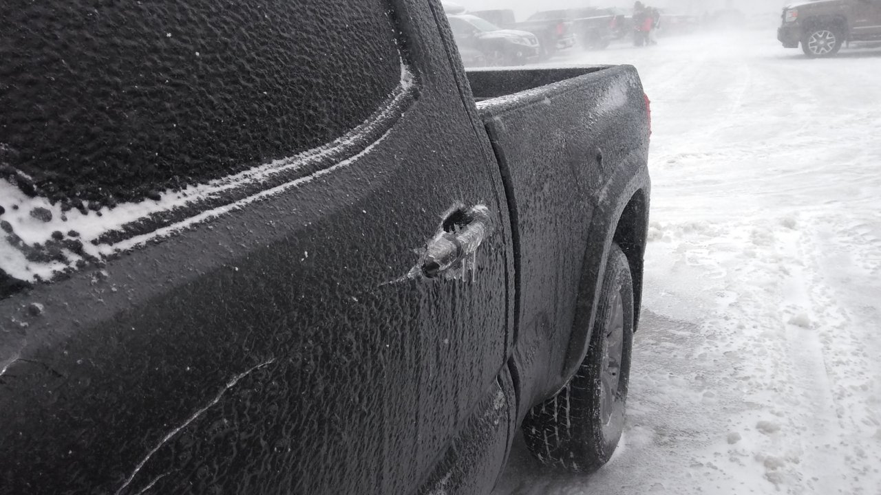

    This is exactly what I had to do through my AAA tow truck driver and it worked and didn't break anything

    If you’re in NW British Columbia, you probably got that just above zero rain storm before it froze well into the minuses. We had that a week ago in PG and I had the same problem. My battery wasn’t dead but the moisture got into the weatherstrip and froze the door shut. when I first pulled on the handle and nothing happened, I thought I broke the linkage. I just pulled the handle and nursed the door open, took a bit of cursing but it finally broke lose. I’d try a heat gun and go around the door gap, it’ll probably let go. Good luck.

    OP, you should install a charging lead and run it up under the grille for next time. I think it's been mentioned, but an air shim might help you gain access to the inside.
