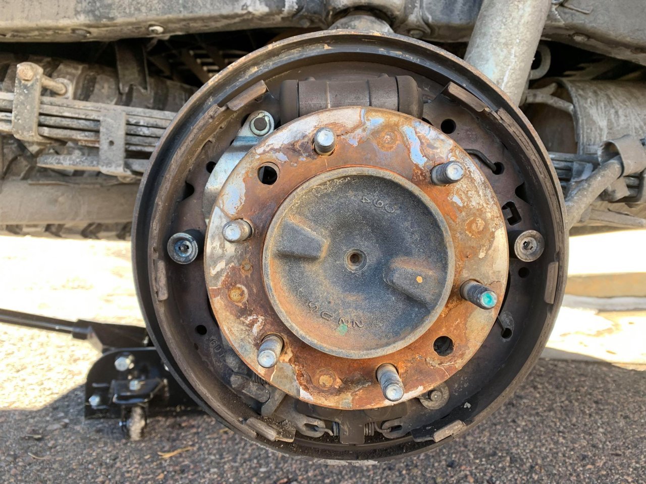

    Kind of late reporting back but anywho. I took the drum off and saw NOTHING that should have caused them to lock up. I cleaned them out the best I could anyway but it was just brake dust. There was no mud in it at all. Im stumped. It still does it everytime the temp is below about 30. I have even put it in 4LO and engaged the locker to free it up. It would work, but as soon as I disengage the locker, it locks up again.
    Side note: theyre pretty stinkin thin to have 45k on them.

    Is there even any pad left on the left shoe?

    You can see there’s lots of brake shoe remaining

    Its thin, but there is pad left. I am going to change them soon anyway but there should be plenty to not lock up.

    I guess it's just the camera angle but the left shoe looks almost bare.
