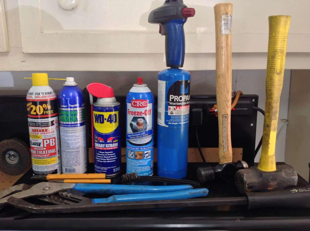

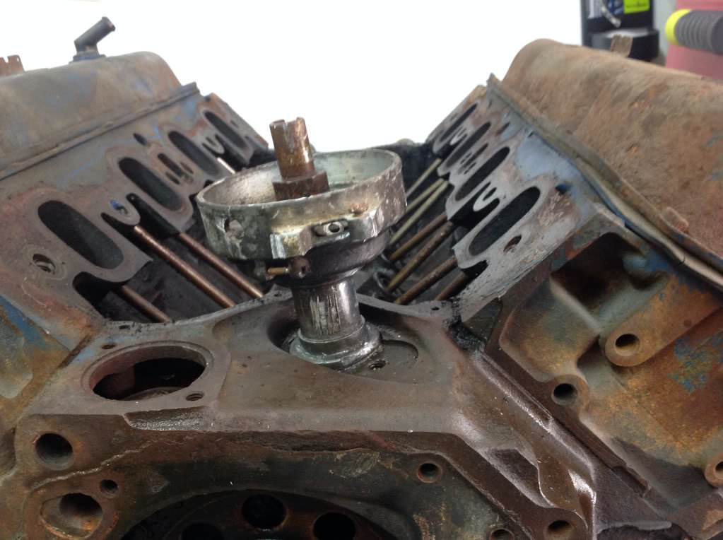

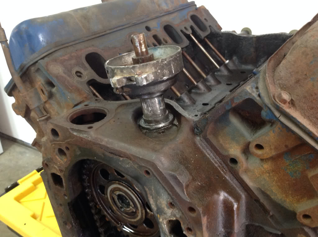

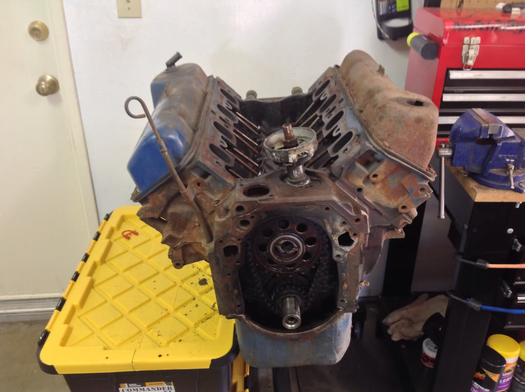

    I've got a 351 Cleveland with an absolutely stuck distributor. I've looked for solutions on the interwebs and have tried what I could, with no positive results. I've tried:
    -WD40
    -PB Blaster - Been soaking for 48 hours
    -CRC Freeze Off
    -Corrosion Block - Currently soaking in
    -Heating it with a propane blow torch
    -Ball peen hammer
    -4lb Sledge
    -Very large Channel Locks
    -Pry bars
    I've even heated it up with the blow torch and then doused it with Freeze Off. Also used a cheater bar in conjunction with my a Channel Locks trying to turn the distributor. I've gotten no where with it, other than the distributor starting to crumble from all of the abuse.
    1021037b8139331859594e6f65e0636a_zps5027_a8f727498c5d02d0503d27d54fa6f18960e12e2d.jpg
    9172f98c77273f30579feb9a3b86f7cb_zps1d63_987dd52f16d11c15c9de11385b2055cd6b3f81c6.jpg
    477d1e764af614020844c1909803ab6d_zpsb68c_a42f20d42b3ce78c6ce05ac72caa18cde843d177.jpg
    649977412b9c22a7b9786cb3e6c4dd9d_zpsf019_e8fb2639b2f16f78d57d4b73f11b2ba02b04fa91.jpg
    Anybody have some good advice?

    finish taking it apart, drop oil pump, see if the 4 pound sledge will loosen the distributor from the bottom side at the gear end....gonna need a new distributor anyway, best I can come up with..
    do you have a pipe wrench of significant size, you will get a whole lot of grip over channel locks on the stem coming out of the block...you may want to try that first....
    I am assuming this is getting a rebuild?
    good luck...

    So, I tried the pipe wrench with a cheater bar. It turned, maybe, 10*s. Only problem, is I really don't have a way of applying upward force while rotating. Also, I need to figure a way to hold the engine stand still. Haha, it was turning the whole freaking thing and pushing my work bench out of the way.

    that's progress, apply liberal lube and twist it back and forth, probably rusted in pretty good....

    Take it all the way down , cut it knock it threw, you gonna tear up the hole ,I see it already peeling steel, looks like engine sat up for awhile ,has enteral rust.

    If you're talking about where the timing chain cover goes, there's still a gasket on there. You are correct though, this engine was sitting for a few years.

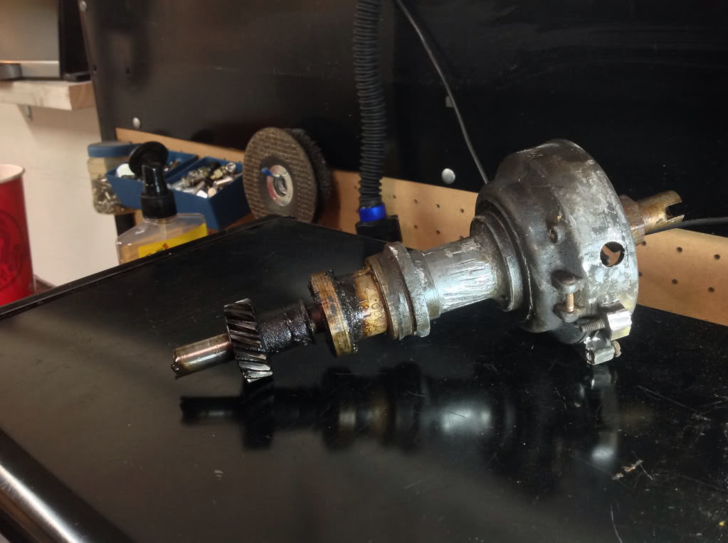

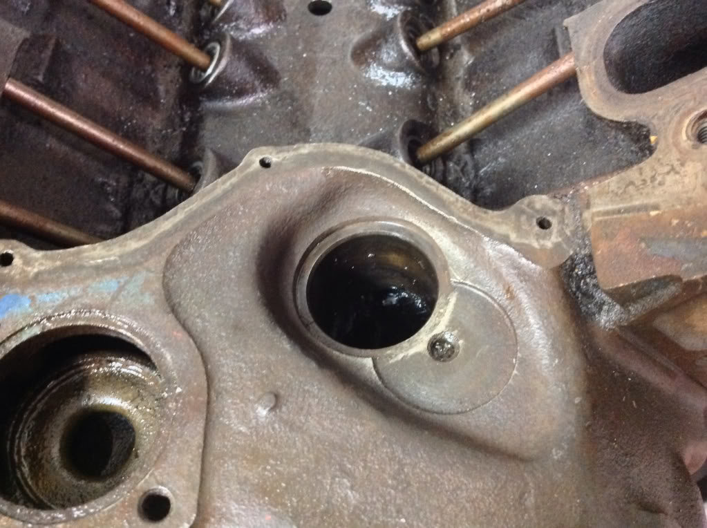

    I finally got it out. After only being able to rotate it with the pipe wrench and cheater bar, I dropped the oil pan and the oil pump. Once I got those out, I flipped the motor over to access the bottom of the distributor where the oil pump shaft connects to it. Using the oil pump shaft and a 4 pound sledge hammer, I was able to persuade it to give up the fight. The pump shaft and distributor are trash now. Haha.
    25a861fa63658c1591f9a5382d37d3be_zps73f8_ac611134ee921193091067e2d90770c7f569dd04.jpg
    3bf22632b8b28fe136730b9c3bd451d7_zps062c_ea5756d49ec8ae38e8510eaa4d69c189e9ebba67.jpg
    Doesn't seem to be any damage to the port, but I'll have to clean it up better to be certain.
    0011f9afccfd49d27ec756fe395dddb6_zpsec22_22b8b040c1cd01f0dd75d3eca5bd743f81a7ad09.jpg
    Thanks for your help bldegle!

    The opening for the distributor is gonna be okay, needs to be cleaned of rust and you should be good to go....
