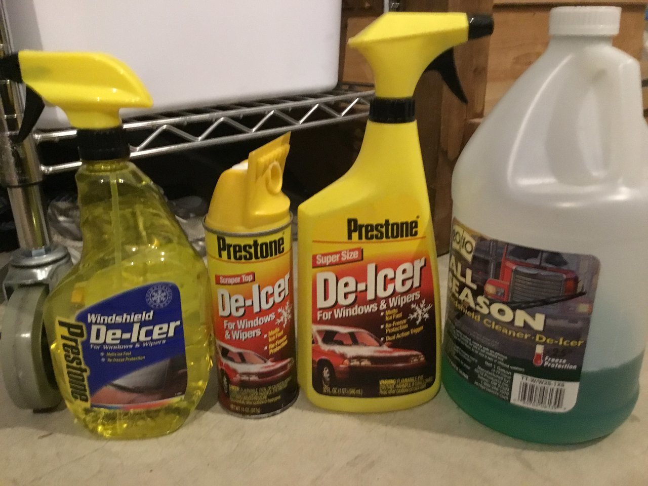

    It’s good to have a bunch of this in your truck and garage. Yes I know it doesn’t work on really thick ice on your windshield.A531444E-F451-49A8-B16A-71A342F8BF97.jpg
