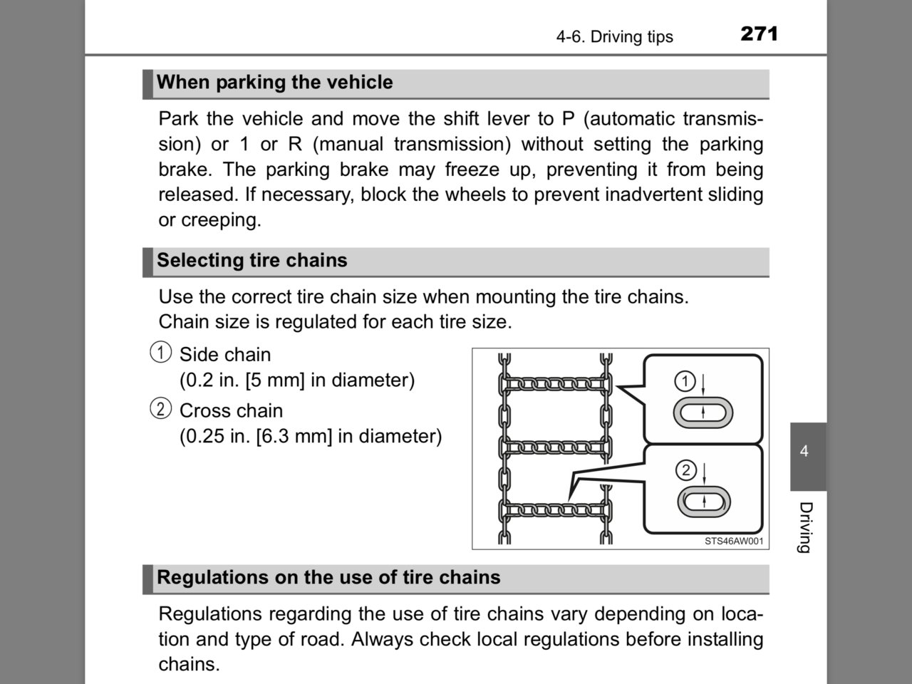

    0CA672A0-AA24-4288-BF1B-8A14B39A8173.jpg Straight from the horses mouth...
    Marc70, Bastek and Eatmorevegtables77 like this.

    Yeah, it's well stated that the manual says you shouldn't do it. But that doesn't change the fact that in a manual transmission, when parked on a hill, you HAVE to use it. and I am not going to be taking chocks with me every where I go.
