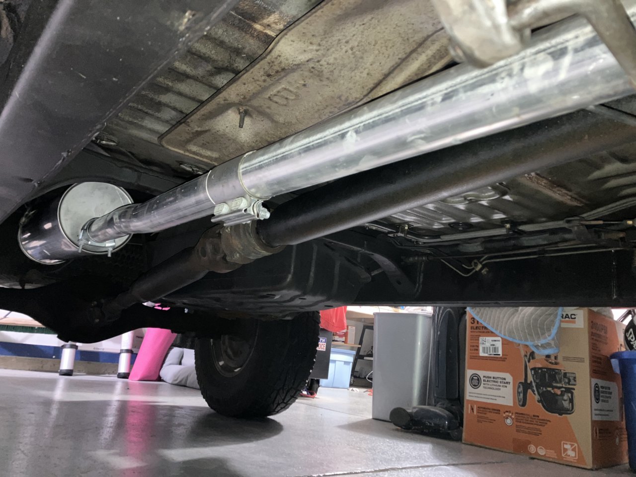

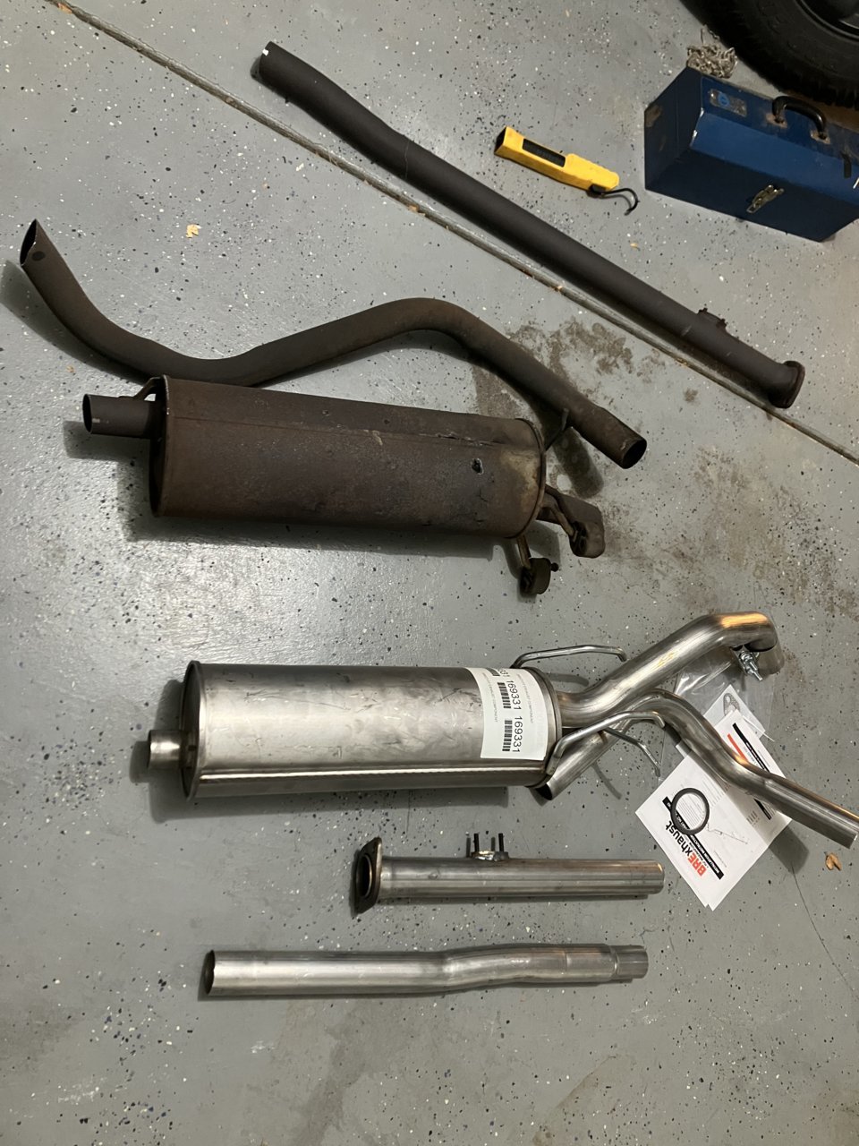

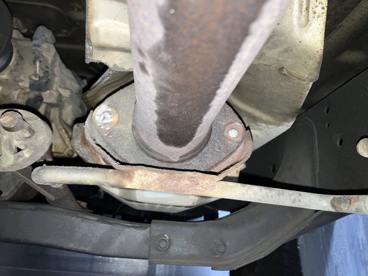

    My stock muffler has rusted through after only 24 years. So I'm getting ready to install the BRExhaust/Bosal cat back kit, and as expected, all the bolts are pretty much solidly rusted. As far as I can tell, there is some kind of hanger bracket that is bolted to the exhaust flange / cat. I broke one bolt and rounded the other. I'm guessing I need to replace this hanger, but so far have been unsuccessful in finding another one. I guess I have to cut it out now, but it's going to be a pain getting anything bigger than a Dremel in there. Any thoughts on saving or replacing it? I can't tell if the nuts are supposed to be part of the bracket or not - they're just blobs of rust now, pretty much welded together. I don't imagine the PB blaster will help much.
    The O2 sensor bolts are frozen too - I'd like to save that too as it apparently still works.

    Anyway, a Dremel tool, angle grinder, and sawzall made short work of the old exhaust. I just hope the BRExhaust goes together well. I'm not sure what to expect from this budget kit.

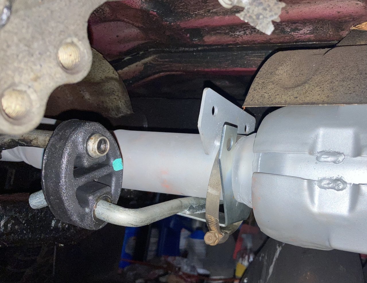

    I decided to try this. T'was about the only hanger I could see that might work unless I wanted to fork out the 50.00 for a Toyota one.
    https://www.amazon.com/dp/B000C949PG?ref=ppx_yo2ov_dt_b_product_details
    I had to make it work ('01), however I do believe this is for the '99. Although looking at yours I'm not quite sure how it'd work unless it attaches right to the flange. Holes don't seem big enough though.
    I just ended up putting the arms through the bushings 1st & then used a large-ish hose clamp. A 2 1/4 exhaust hanger came up too short. Anyway, it's holding fine & I can figure out something else (maybe weld it on) down the road....

    Yep, that’s very close. It kind of cradles the flanges, and the flange bolts go through it and attach it to the backside of the cat flange. I ended up dremeling the bolts off, since I couldn’t fit a bigger cut off tool in there. Then I had to take out this hanger/bracket/cradle thing and cut off the other half of the bolts that were pretty much welded on. Same with the O2 sensor studs.
    So I didn’t need to replace it. I reused it and all the original isolators. And the dremel, angle grinder, and a sawzall make short work of that original exhaust.
    Got it all buttoned up and let it run for a while. Ah, the smell of burning permatex. I took it for a ride too, and it’s still noisy as hell, but at least the exhaust is quiet.

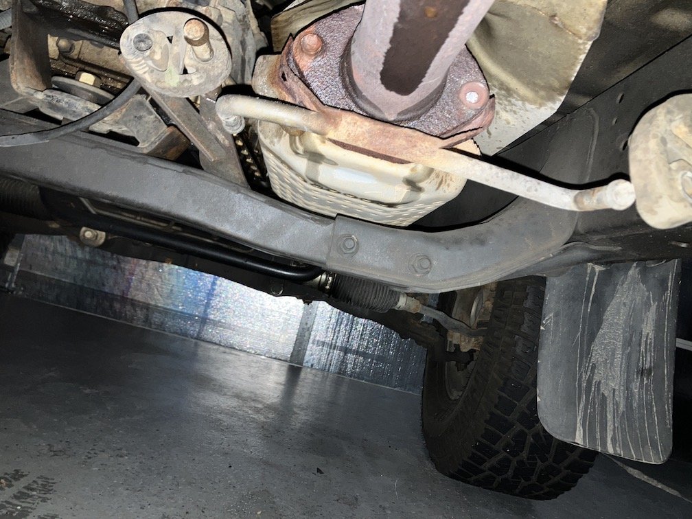

    if I Dremel off the bolt head and nut, can I tap out the rest or is it threaded?

    It should just come right out of the nut is done. Typically the flanges that mount to pipes together are NOT threaded.
    Might take a little more than a “tap” but a good “smack” should do haha

    Rust tech here, we dont even bother with penetrating fluid, it doesnt do anything to bolts that are melded to the flanges.
    I cut off the head and the flange nut with a torch or disc then put in fresh hardware.
    Anyone that dicks around with those fasteners just waste a boat load of time.
    Usually the weld nut is held on by 4 welds, you cut them off and use as punch to hammer out the nut.
