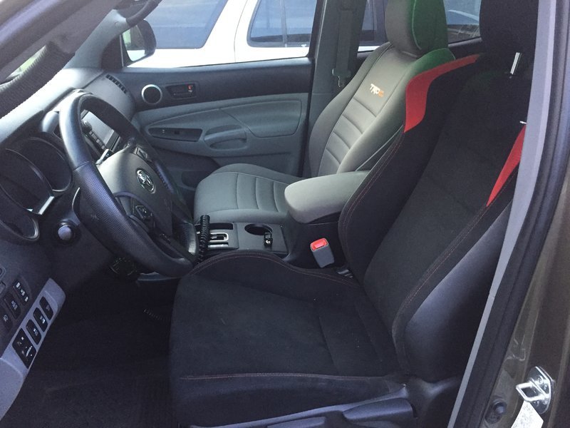

    Lol yeah if I didn't have a 2013 I wouldn't even have wasted my time on the FRS seats
    Just curious though for the long run are they decently comfy?
    I have a small frame, 5'9" and 145lbs so it felt real nice sitting in it but wondering about long drives.

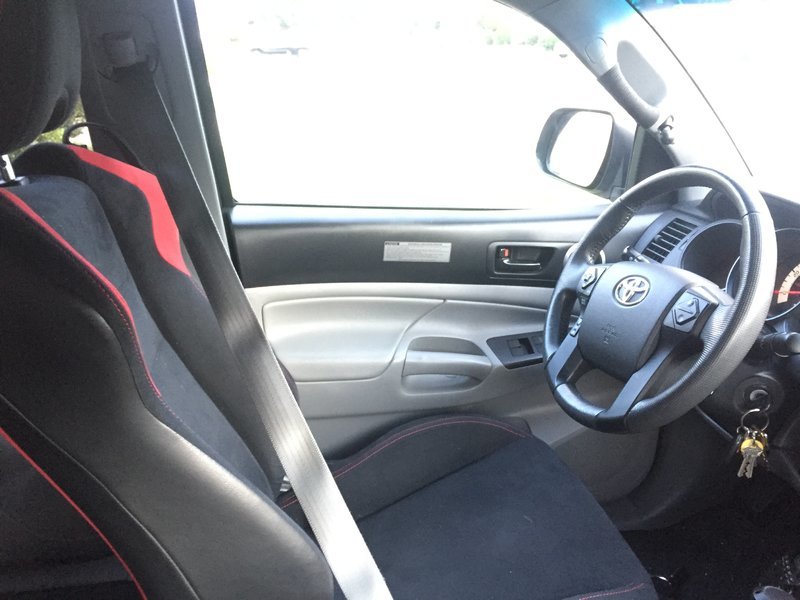

    Finishing up everything. Finished up the seat position sensor mounting.
    Doing a final touch up paint job of the seat bracket.....marred it up a bit yesterday trying to get everything lined up.
    Once that's done it's going in the truck!

    It is complete. No airbag lights, everything is go.

    Day 1 driving impressions:
    Overall really enjoying the FRS seat. After making adjustments in my seated position it feels great! Seat is a little more firm than the stock TRD seat with wet okoles installed.
    Felt a lot more comfortable on my 20 min drive to work this morning. Seat back + headrest position is a lot better in my opinion. With the seat + custom bracket it does "feel" overall taller by maybe an inch or so as I have not done accurate measurements yet, thus I did lower the seat down a tad to get back to what felt like stock height (which I am used to and prefer since I am 5'9").
    And maybe its just a placebo effect but my drive home down a windy 2 lane going 60mph+ was noticeably better given I wasn't sliding around in my seat going around curves. Might have been in part to the slicker Wet Okoles I had on the TRD seats, but prior to seat swap I would need to brace myself if I took a curve at speed. Felt very much more planted in the FRS seat given the hip and shoulder bolsters.
    My only con thus far is hopping in/out out of the truck with the higher hip bolsters is slightly more of a pain, and my only real concern with that is wearing down the seat fabric over time having to slide out. But then maybe some sliders/steps will solve that.

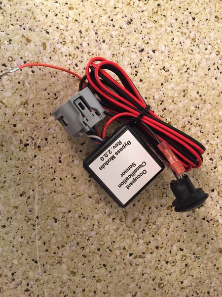

    Passenger seat should be 90% the same process. The only difference is the need for an "OCS bypass module", which MetalTech 4x4 sells. I contacted them last month and they finally replied and said they do still sell them and have about a 1 week lead time. The FRS seat uses the electrostatic detection system whereas the Tacoma uses a weight detection system so the two seats aren't compatible in that regard, so the OCS system requires you to transplant the passenger seat ECU and then it just plugs in and comes with a switch that allows you to activate/deactivate the passenger side airbag manually. I also don't think the passenger seat has the rail position sensor so no need to mess with that. So really sort of subtracting one step and adding another in comparison to driver side.

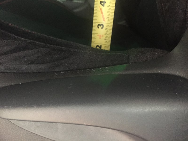

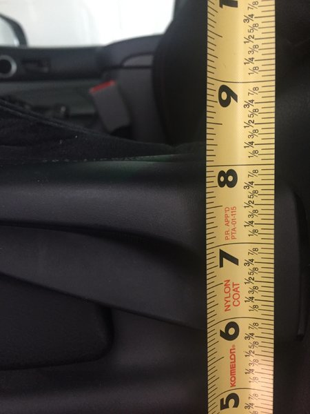

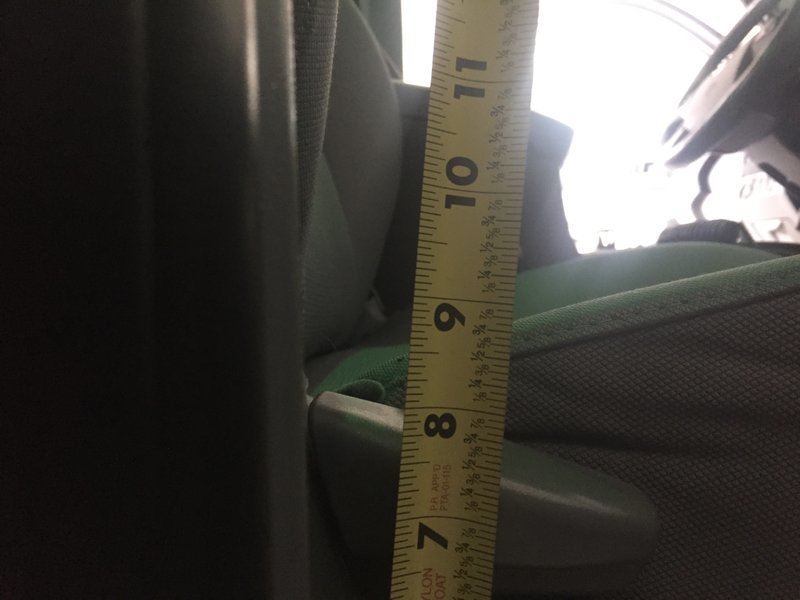

    I took measurements of the seat to gauge the difference height wise how low the FRS seat can get vs TRD seat. FRS seat sits roughly 2" lower than stock seat at lowest height setting.
    TRD seat is roughly 8" at rear lowest point, and FRS seat is same at the BOLSTER, However the bucket is then 2" deeper at the rear most point vs the bolster. So ~8" for stock seat and 6" for FRS.

    My OCS bypass came in the mail today.
    All I need now is to get the passenger seat. When funds allow.
