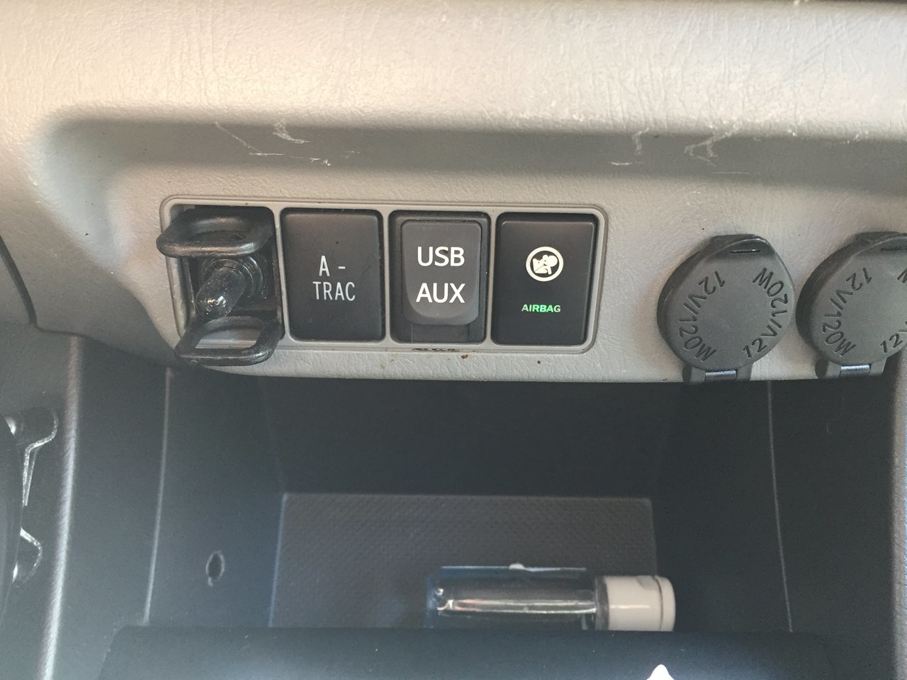

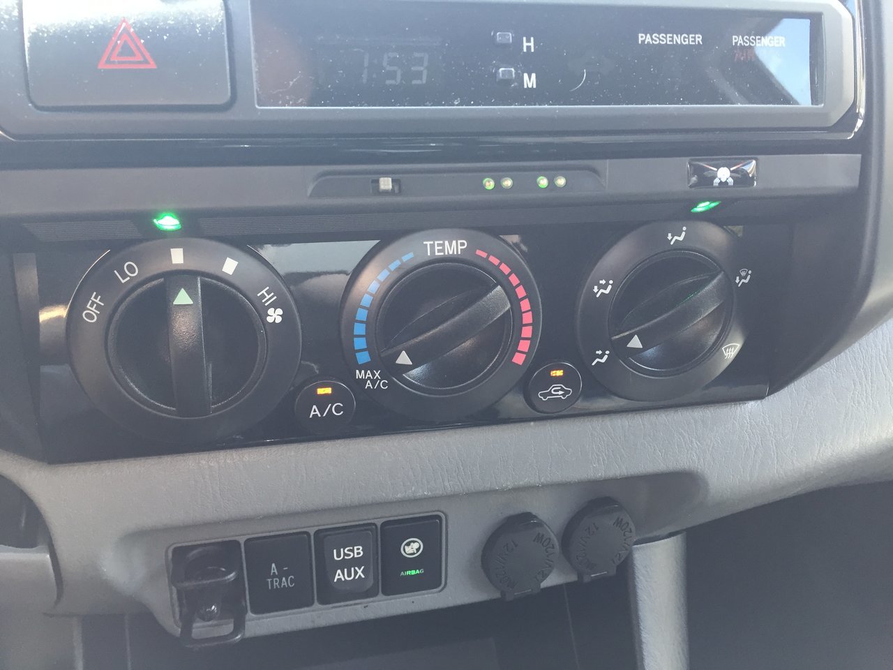

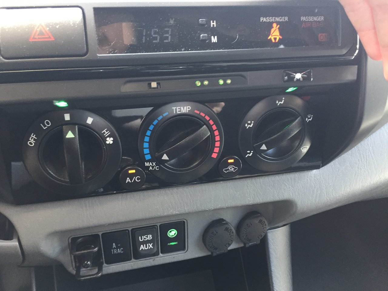

    Finally done with switch.
    Close up
    Switch off (rest of dash is on, the ATRAC switch is just less bright)
    Switch On = airbag on and upper LED lit
    And my overall opinion of the AOB switch. No solid click like OEM which I half expected, but mines not sticking so that’s good. The lighting also sucks. the first couple letters of “airbag” sit off to the side of one of the internal supports so they are only half lit. Didn’t feel like it was worth it to fix that. Owell, overall happy with it.
