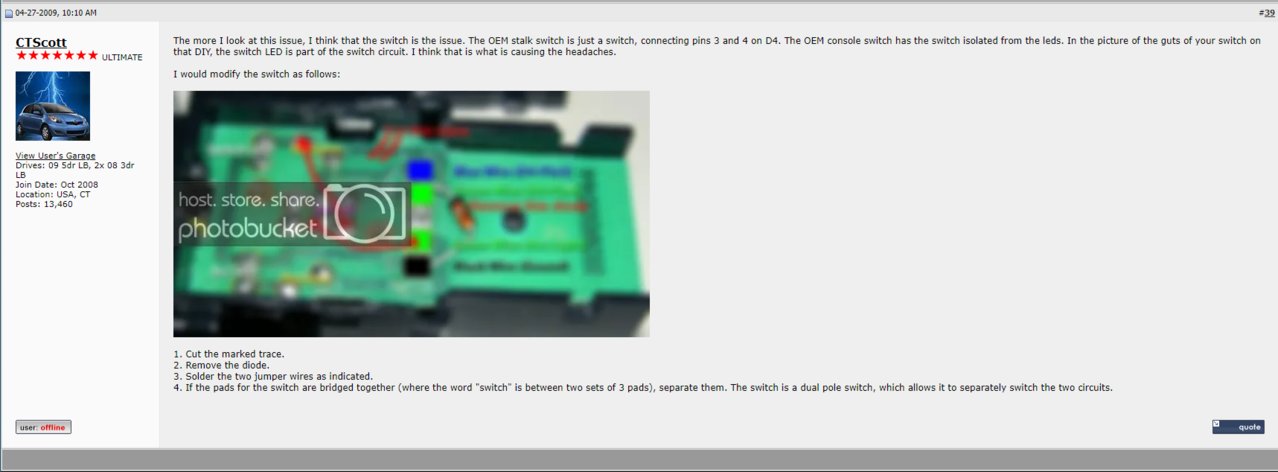

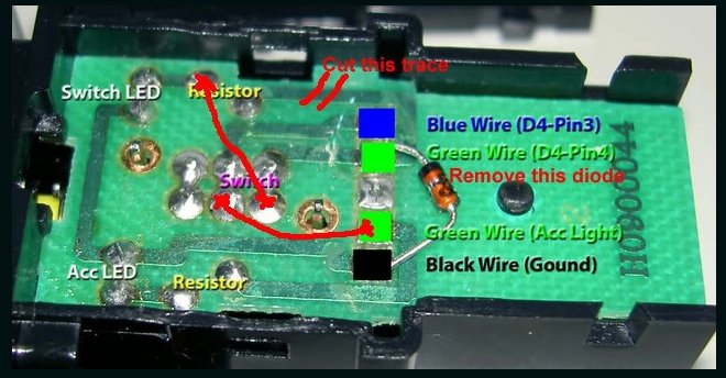

    I really have just one question for NOW. You showed a photo at the start of the Surgery but all I could tell was it looked like the “feet” on the slider were removed or moved? If removed where they replaced with the Tacoma “feet”? I hope what I’m asking makes sense?

    So what you do is drill out the rivets of all four mouting feet on the FRS seat. What you are left with are holes to use as bolt points to attach to the Planted brackets. I think I used an existing set of holes on the planted brackets for the rear bolt points and drilled 2 in front. I don’t perfectly recall as it’s been a while and I’ve since sold my truck and another member now has the seats.

    CTScott is MIA & the 4x4 shop that sells the passenger airbag weight sensor is NOT selling the part anymore!
    The air bag system will only operate with the “Bypass”‼️
    Just an FYI this jack @$$ “boogie3478 / Tacomaholic” is now in possession of these seats! I found a gentleman that said if he could see the “Bypass” he could copy it. But this jack @$$ will NOT let the “Bypass” be coped‼️ Please ladies & gentlemen do not support this jack @$$ on his YouTube channel‼️ He doesn’t really give a $h!t about helping other Tacoma owners all he wants is to sell his Crap to put money in his pocket‼️ If he doesn’t make or sell the “Bypass” he is not responsible… He talks a big talk but he’s really a spineless lowlife! Plus he’s nowhere near being mechanically inclined… I love to see him try just to change the third member. Plus if you do watch his stupid videos you never see him do anything technical. That’s because I don’t think he can. I installed StopTech’s on my Tacoma, they went on so easy that I had to stop to look at the instructions because I though I must be doing something wrong, aftermarket parts never fit this easy. I bet anyone that he can’t install a set of these brakes. Can he even change his own oil? Sorry but I can’t stand watch him act stupid so I can’t watch his video’s to the end…
