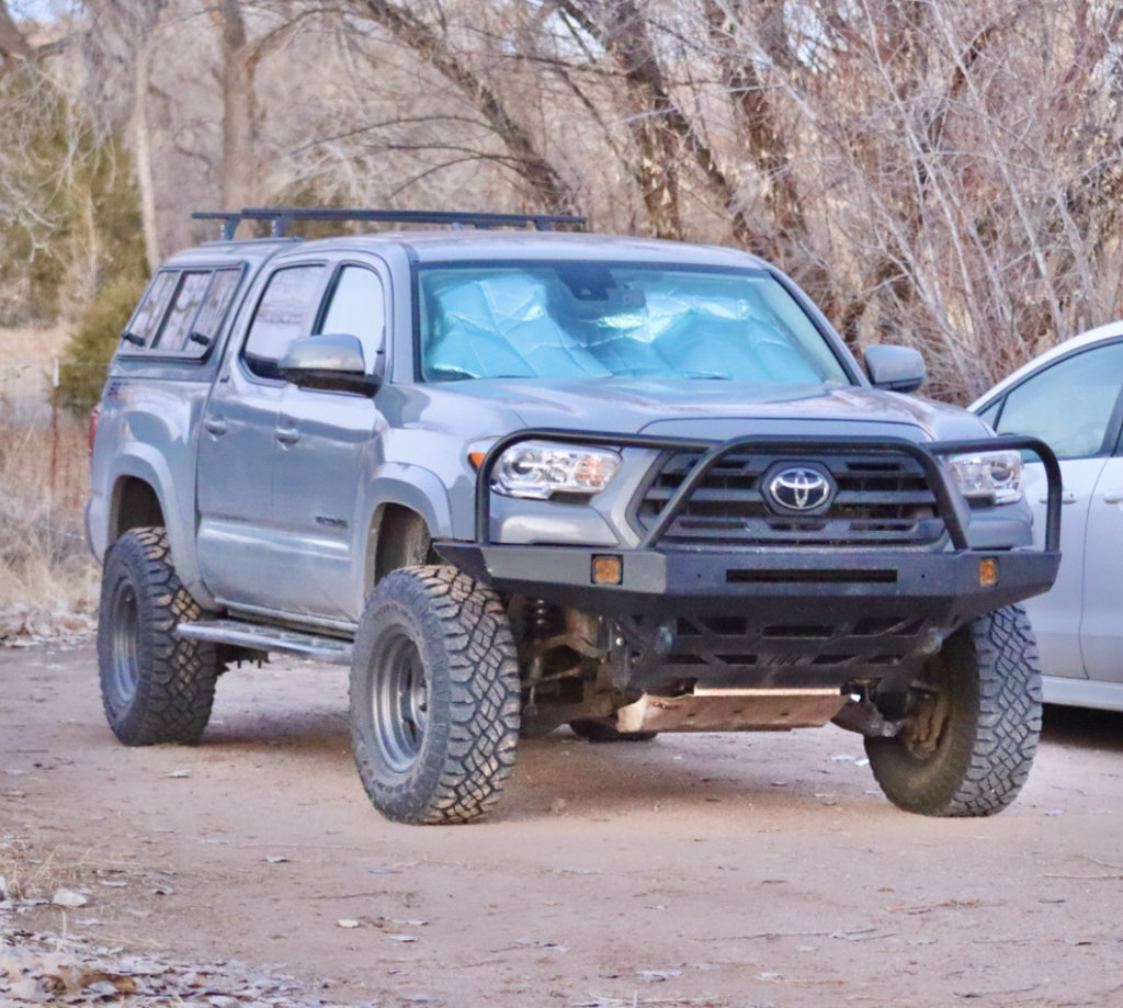

    Pic of the front end because…we all love pics… :D
