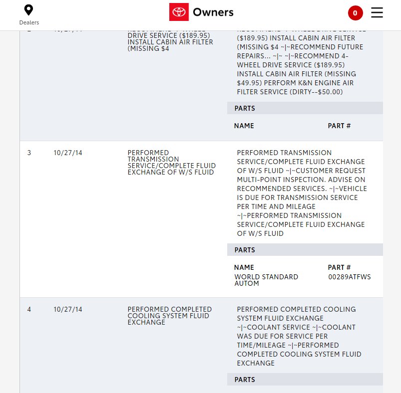

    wheeliest
    wheeliest ///////////////////
    Feb 3, 2016
    #177066
    1,356
    Json
    TMPE AZ
    05-SWB-DCSB-4X4-V6-SR5-SPORT
    NO SWAYBAR, Spacer lift with dirty4's
    well, this is weird.. Toyota service history of my truck. (Item 3)

    Goosie0080
    Goosie0080 Well-Known Member
    Sep 11, 2019
    #305024
    345
    North East
    07 Tacoma Access Cab 4x4 base
    ^^^ it was probably;y at 70,000 like i had mentioned. ;) and if it was done then, Go for it. no worries changing the fluid. IMHO

  12. Nov 12, 2019 at 9:28 AM
    #32
    wheeliest
    Feb 3, 2016
    #177066
    1,356
    Json
    TMPE AZ
    90k
