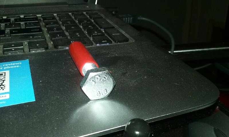

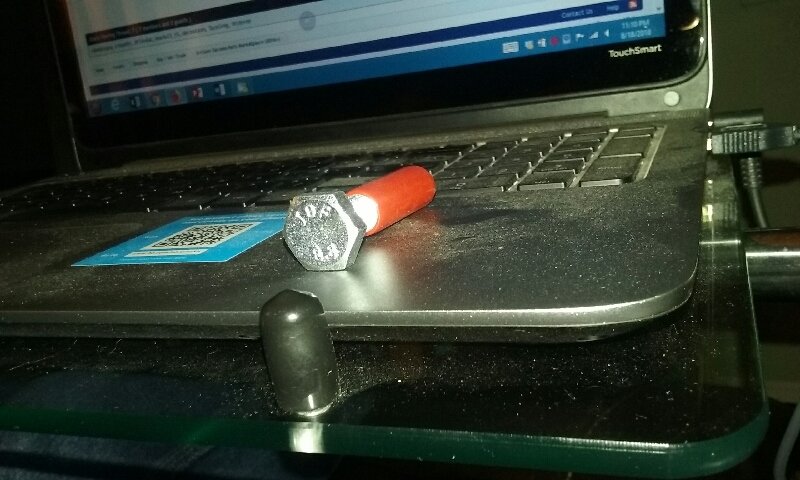

    Grade 8 is what Toyota use on the Seat and all critical bolt downs that is the closest US Standard, However what Toyota really uses is the Metric standard and that is 8.8 if you look at the bolt head sometimes you can see a little 8.8 on the top.

    Thanks for the help. Here are what I have.
