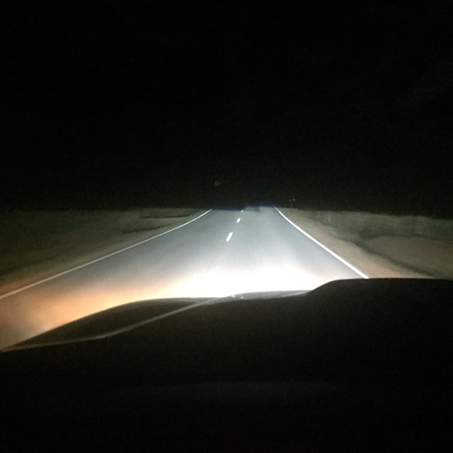

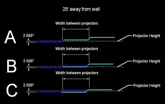

    I'm still getting flashed all the time. I've set my cutoff at 40" from 25' on option C. Thinking about maybe giving B a try.
    Also should my projectors be rotated left or right any? Where's the step supposed to be in relation to the middle of your lane?

    Leave it at option C but lower both a bit. Sometimes the color flicker distract drivers

    Ok I'll give it a go at 38" and see how that works. Do they look centered to you?

    Looks good so far! The top of the cutoff should be under the side mirrors on most cars

    Call me crazy but I don't see any difference between A, B & C

    Look at the cutoff of the dark blue line in each option

    Got it, thanks. I went with option "C" and suggest @HFDane do the same.

    I always do C

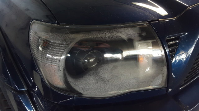

    My Rechelon retrofit has glaucoma.

    Gawd damn!!!! I'd be pissed as fuck
