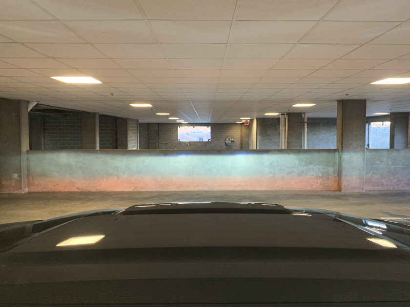

    Yeah I drove the truck up to a wall. I had a pretty good starting point as I visually compared them to the original XB's I took off the truck and had already adjusted. But still had to tweak the driver's side a bit. Checked the aim at 5 feet, 25 feet, and 50 feet to make sure they were where I wanted them. Match them up at 5, and watch them as you drive back and you'll see any small adjustments you need to make if they separate as you move away.

    Yessir. And this photo is at 20-25 feet for reference when you get to aiming. Should at least make a good starting point.
