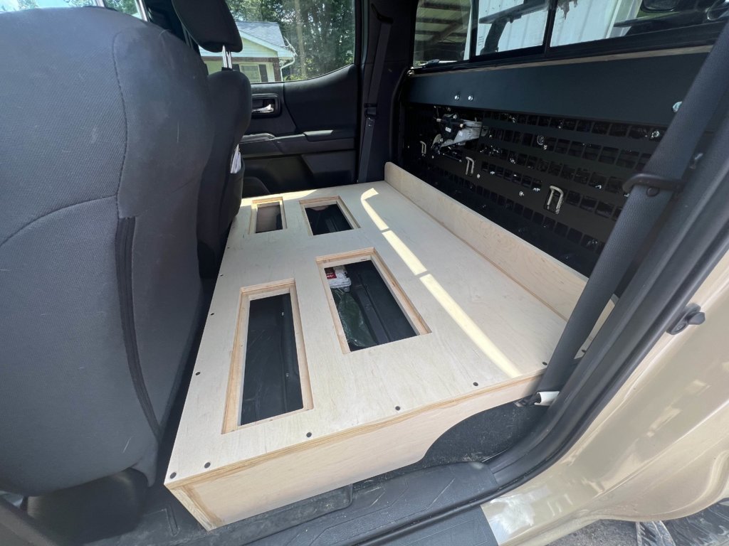

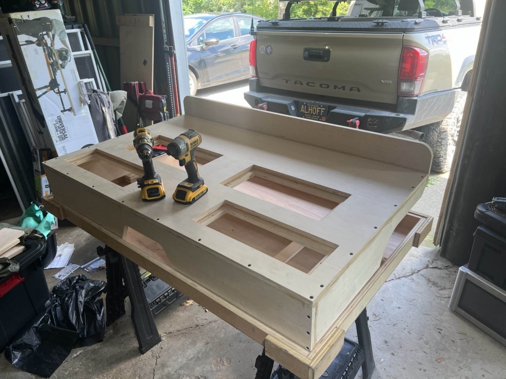

    The room this seat delete deck creates is fantastic. I have had mine for several months and have no complaints!
    The crate it ships inside of is a perfect platform to build the deck on. Super easy to glue and screw with the countersunk pilots. I ended up using a textured durabak to finish mine, all I needed to do was sand, wipe, and roll it on. If I had to do it over again, I would buy _enough_ bed liner to not need a layer or two of spray-paint and not miss sanding any spots....
    I am using a L bracket each side bolted into the cab where the seat bracket mounts and a bolt that screws into some inserts I put into the deck. I picked up some us cargo rails and those work for holding things down nicely.
    Great platform to mount a fridge slide!

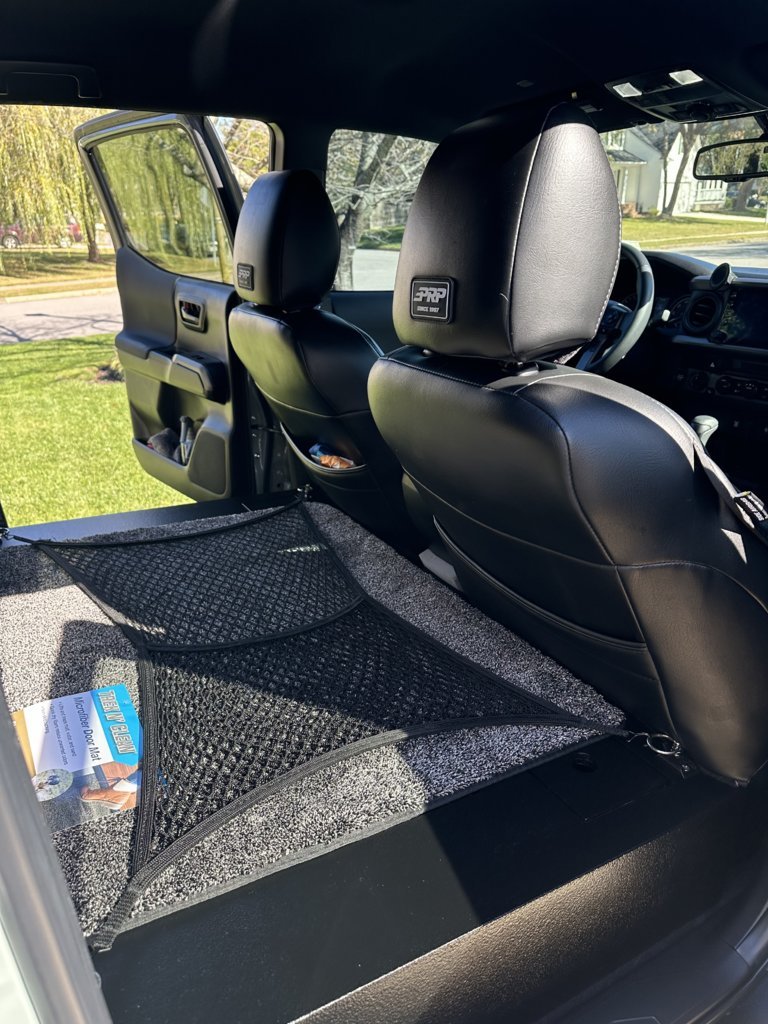

    Figured I would share, still super happy with my the rear seat delete! Its holding up great and functional.
    With the monstaliner, even with my bungee net, things were sliding around (grocery bags mainly).
    I saw this at Costco and decided to give it a shot—damn near-perfect fit, rubber-backed, and a cheap solution at $12. Most importantly no rubber smell like most cheap mats.
