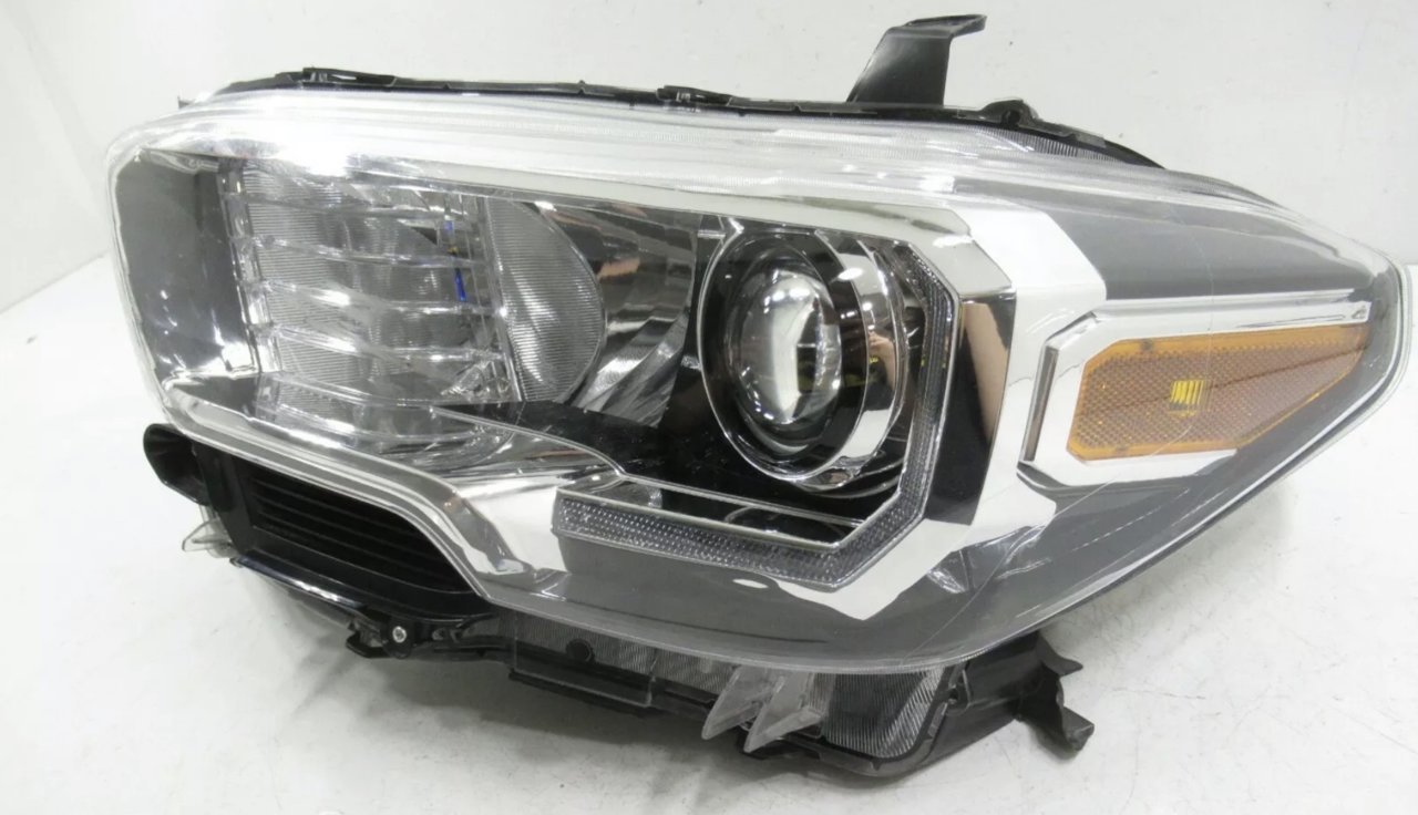

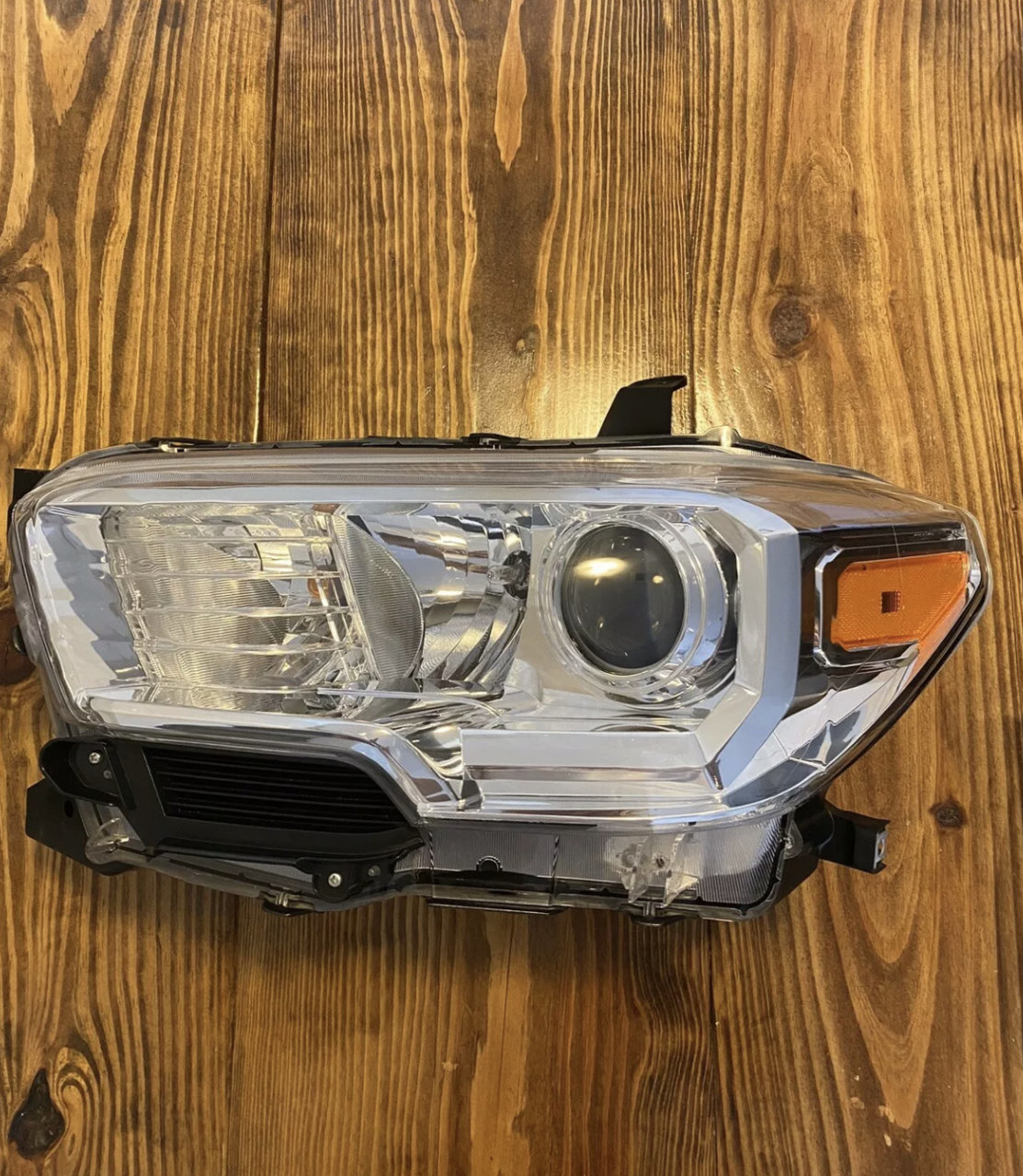

    V2, I don't really know my way around wiring. I'd like to get the V2 harness. Im trying to upgrade my basic headlights (SR type like the one on the wooden floor) to the TRD Pro (white background). I already own the TRD Lights, but unfortunately I couldn't upgrade it. My truck doesn't have an additional cable harness coming out of the truck to connect to the TRD Pro model. I believe the trd pro has 5 connections while my sr one has 4. Not sure if this will be able to make my truck have the fifth harness.

    Hey,
    The only thing you need are the headlights and the turn signal sockets with the bulbs.
    The harness' I sell have a total of two new connectors for each side; new turn signal and DRL connector that connects to the DRL plug on the new headlights.
    You'll just need to convert the female parking light pin that comes off the SR three pin connector, to a male and plug that into the open spot on the new DRL connector.
