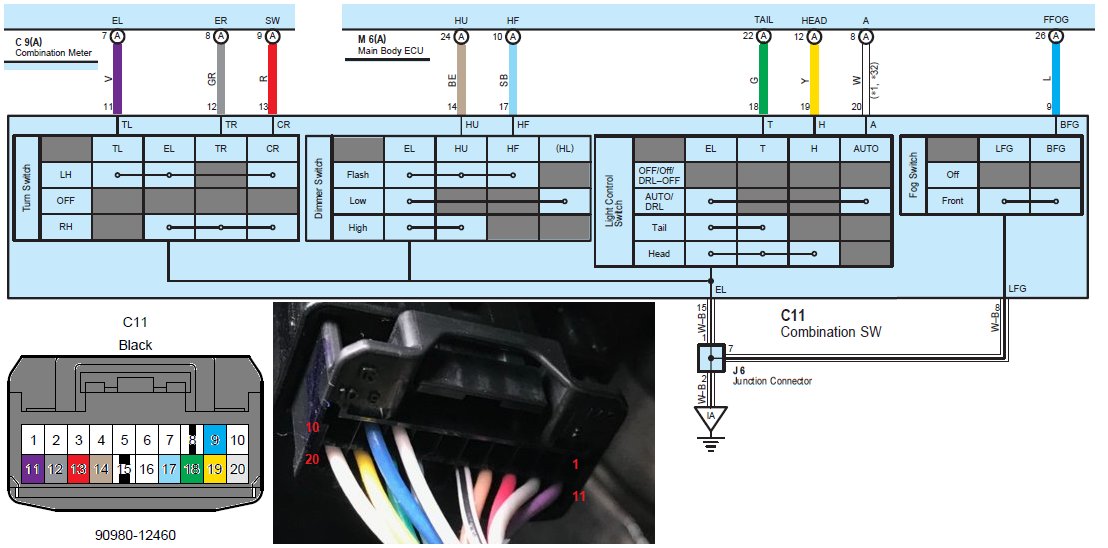

    In all 3rd Gen the stalk is a ground completing switch.
    And to clear your confusion, the DRL's, the Low Beam, High Beam and Turn Signals and even the Tails are all controlled via a relay.
    EL is ground in C11

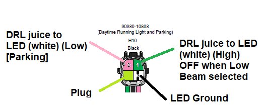

    YOU forgot to read the part where they TURN OFF when Low Beam is selected...

    The DRLs turn off on the SR, that’s easy enough to get around. A simple wire tap or another relay takes care of that easy enough. And it would actually make it easier if they did turn off, then the TRD DRL doesn’t have to assign a priority. I’m more concerned with the way they behave When the turn signal is selected. I think at times we are talking about two different things :)

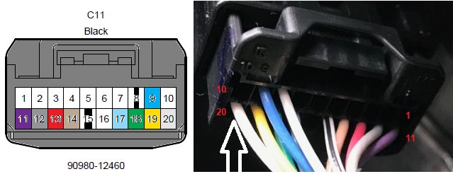

    Look at C11 in your SR and let us know. Maybe there is a wire in location #20 of C11. (Turn Stalk connector)

    I'm messing with you, if your SR has the DRL select feature then it should have the wire.
    That wire does other things in the "higher" models.
