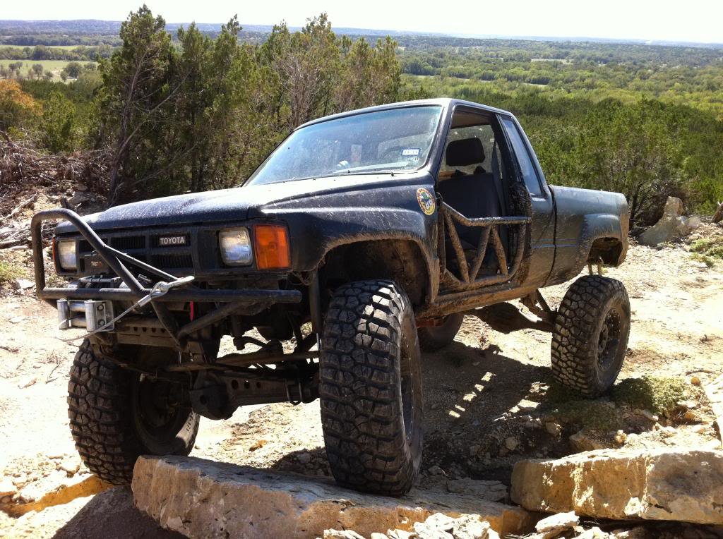

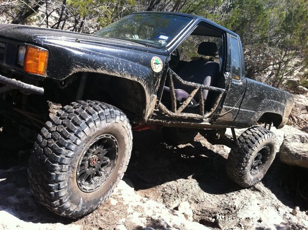

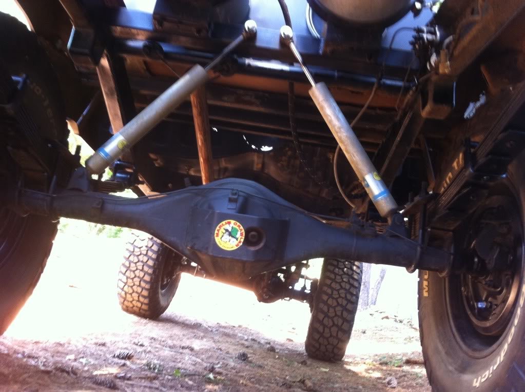

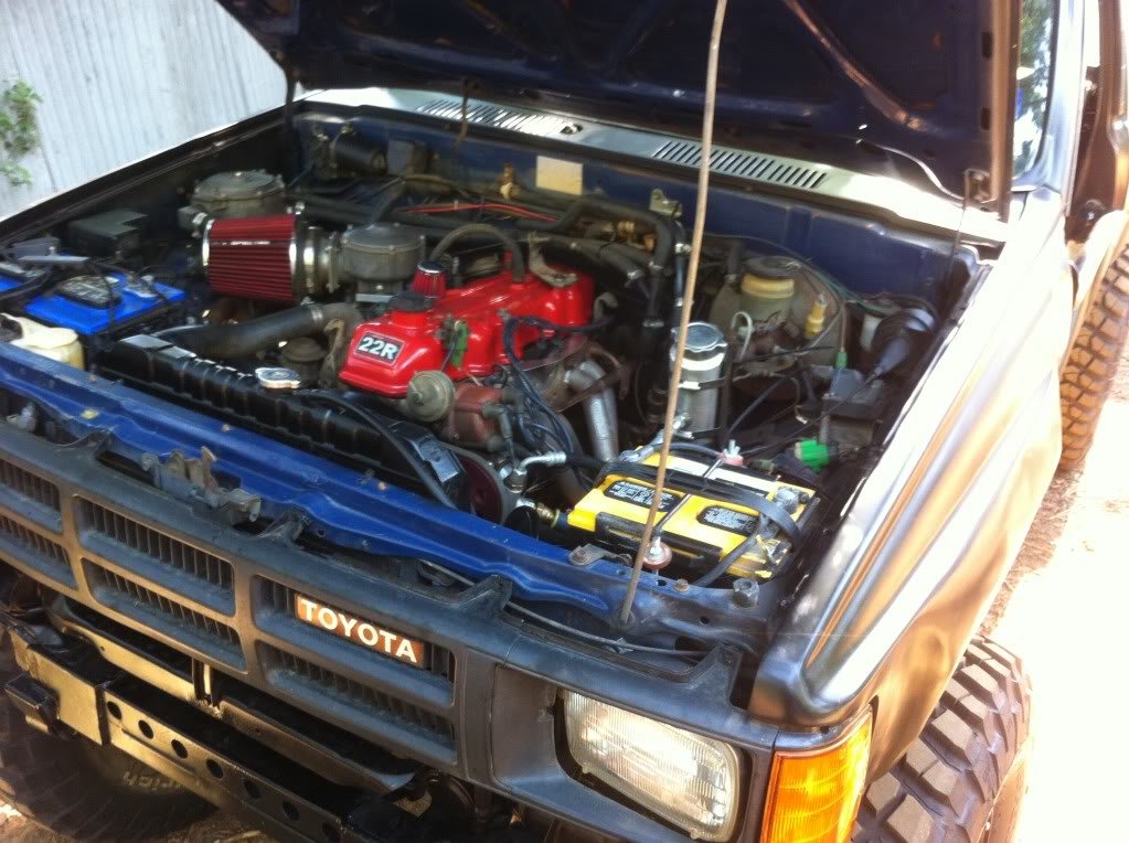

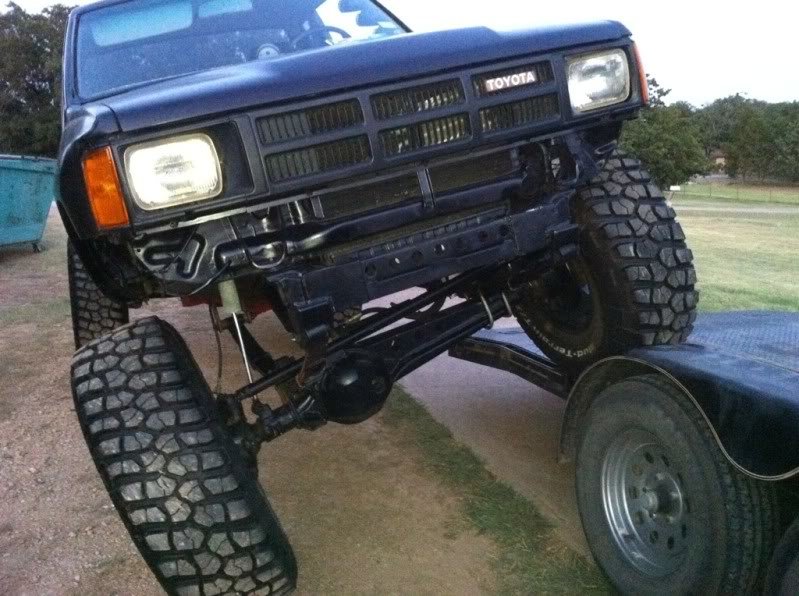

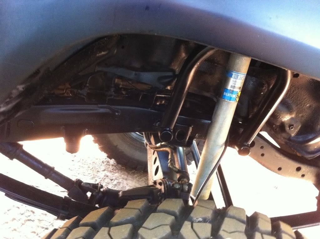

    Thought I would post this over here as well.
    What it's got:
    -Marlin Crawler 5" Suspension System
    -Greasable shackles front and rear
    -U-bolt flip kit front and rear
    -5125 Billsteins front and rear
    -shock hoops
    -extended stainless brake lines
    -Marlin Crawler High-Steer
    -Hydro assist
    -5.29 gears Front and Back
    -Spooled Rear
    -Detroit in the front
    -power steering conversion
    -reinforced frame around steering box
    -PROPANE conversion from GotPropane
    -4.7 marlin t-case
    -clutch From Marlin 1600 Ibs
    -Marlin Front Sting Bumper
    -37" Km2’s
    -17’’ Xd Hoss Wheels
    -Longfield 30 spline chromoloys
    -Axle Armor Front And Rear
    - 22r Engine
    -5-Point RCI Harnesses
    -Custom Dash/ Gauges
    -LC Engineering Header
    -Trail-Gear tube doors
    Some minor things I'm planning on doing:
    -Add CB- done
    -Reroute/chop exhaust (pointing right at the driver side rear shock body)
    -Add a more weather friendly stereo
    -Internal Roll Cage
    -Weld up sliders
    -Add rear bumper
    -Add rock lights, and spot lights up front- done
    -Get 2nd battery
    - and so on...
    A couple of shots as is:

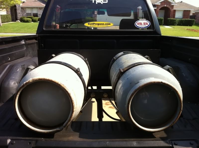

    Propane huh? That's pretty cool! :eek:

    How long do those two tanks last you? Thats pretty badass!!!

    Thanks guys. If I just use the truck for Off Road, one tank will last a long time. I've been on the one tank for 4 trips out. Each trip lasted about 4-6 hours.
    On the road, I can get about 130 miles out of one tank.

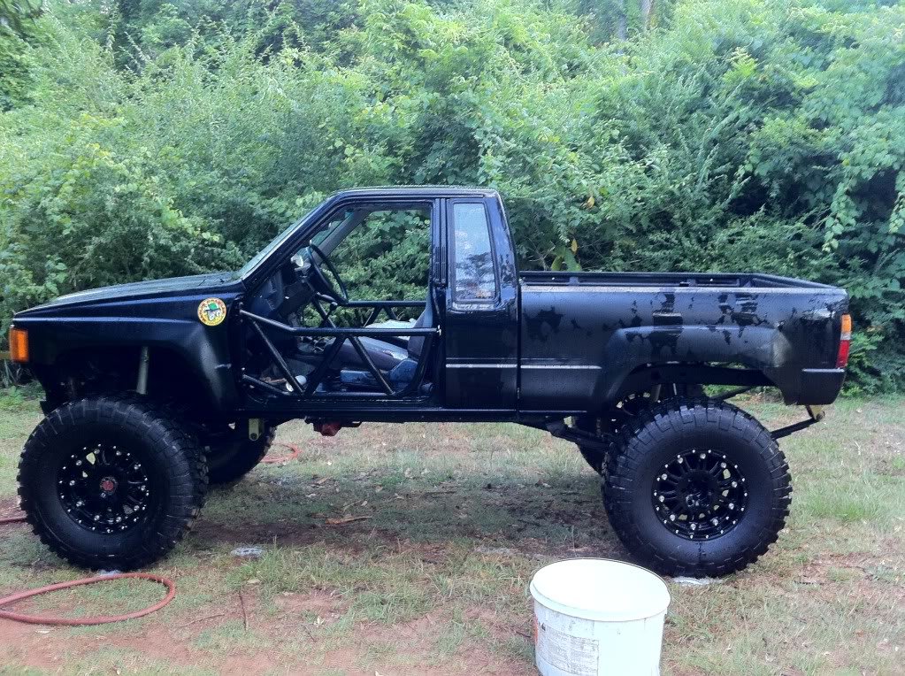

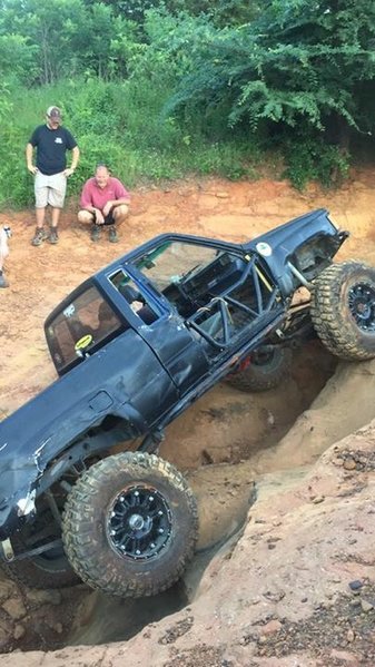

    I haven't updated in a while. So here's what she looks like today.
