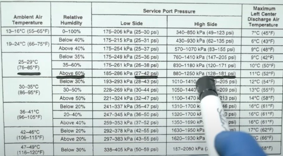

    Here’s my readings at 61-64* ambient less than 40% humidity - low side is pretty stable right around 30 psi and high side is pretty stable right around 150 psi with rpm at 800-1500 (I’ll open the throttle on occasion to see if it makes much of a difference which the high side would go up as expected but nothing out of spec as far as I could tell).
    I’m going off of this chart:
    And it looks to be in range but the sight glass isn’t clear and I understand it should be clear except I’m not sure if there are certain operating conditions in which this should be the case (engine rpm, ambient temp, humidity etc) or if it is irrelevant and should work no matter what. If I know that then I can make sure I know if I’m ok and run the risk of overfilling it or if I should refill more.

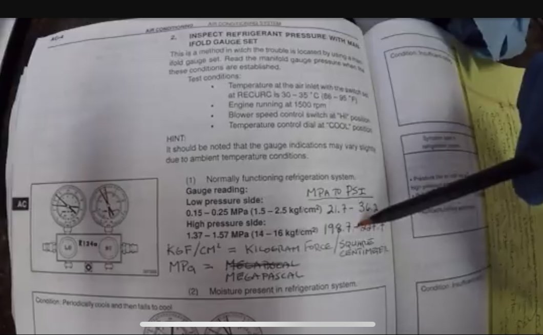

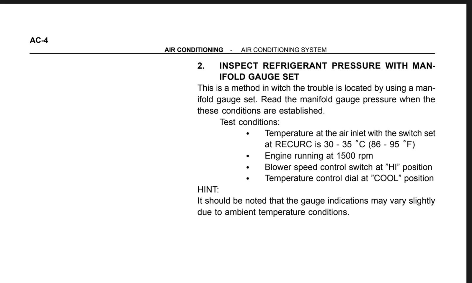

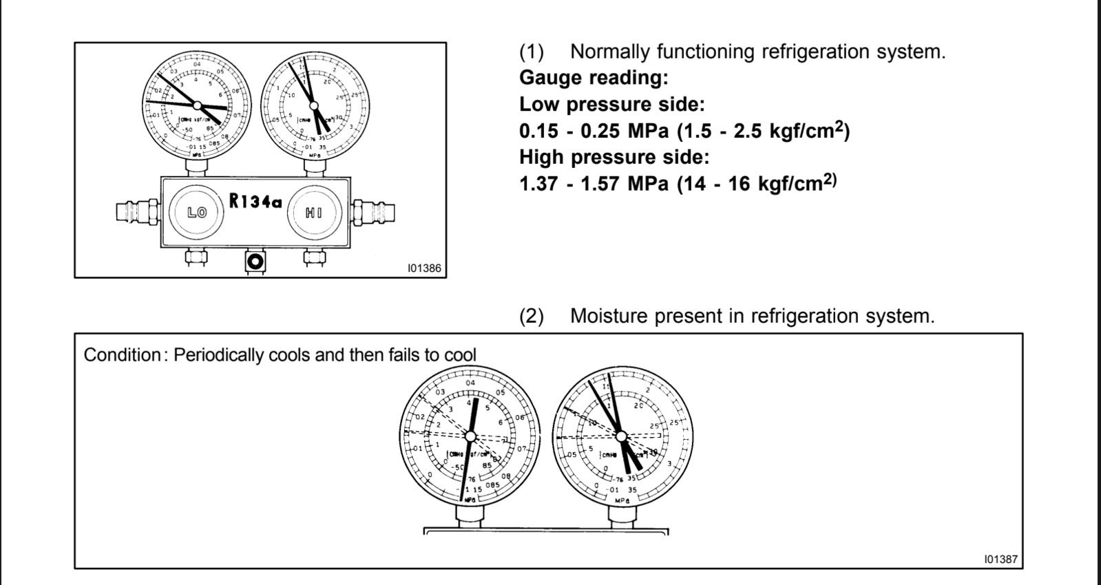

    It doesn’t give a humidity % spec.
    .2 map = 30 psi
    1.47 map = 215 psi
    But I recall 180 or so being “normal”.
    I’d wait and see what @Dm93 says.

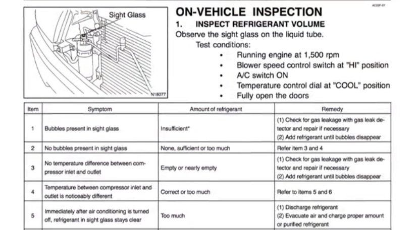

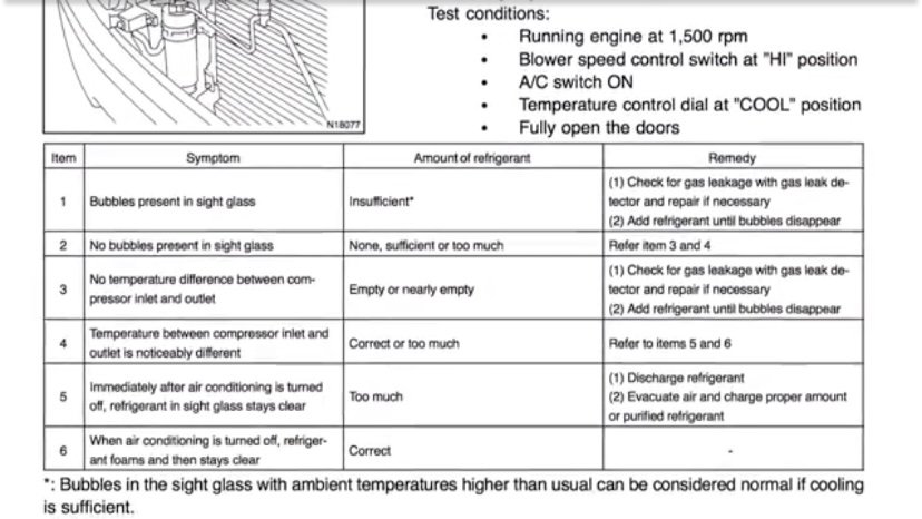

    Thanks man - I appreciate it. And a couple more screen shots from the Timmy video
    BA778900-07D1-4199-91E2-BCBF286A72F6.jpg 1494B1C3-3D5D-4225-93AB-1EEEB69A2AA5.jpg 8BD9ADD7-2177-466C-A10B-C038409CE040.jpg
    I believe his calculations were for 85* ambient temp but I can’t remember and it’s too late to look for it right now.
    I don’t know if I should either trust the sight glass, the manifold gauge readings, or if there is something going on like moisture in the system.

    Sight glass wont be clear on an automotive 134 system, don't pay it much mind

    Those readings seem close for a cool day, I'm used to checking them when it's 85-100 out and we usually see 30-50 on the low side and 190-250 on the high side.
    Rarely see anything with a sight glass anymore but it should be fairly clear with maybe a few bubbles, if the system is under a heavy load there will be more bubbles.
