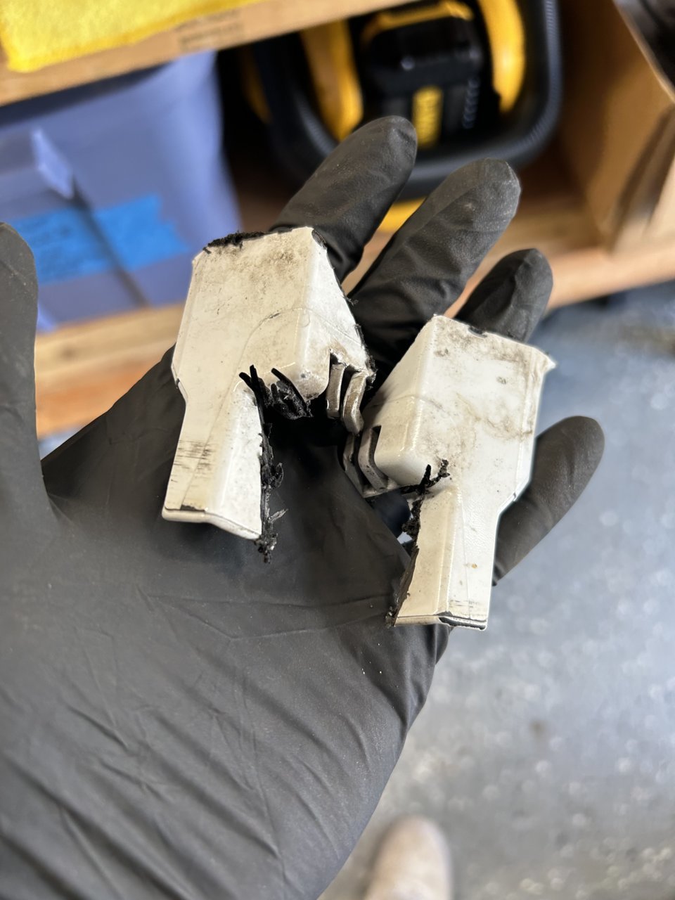

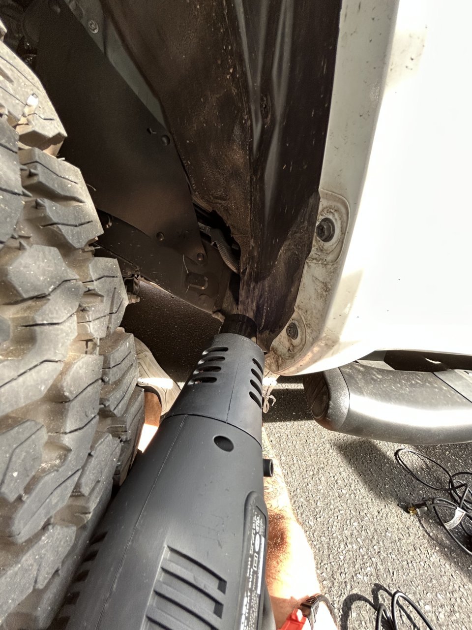

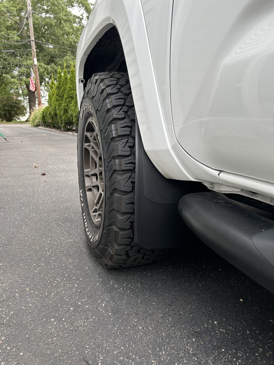

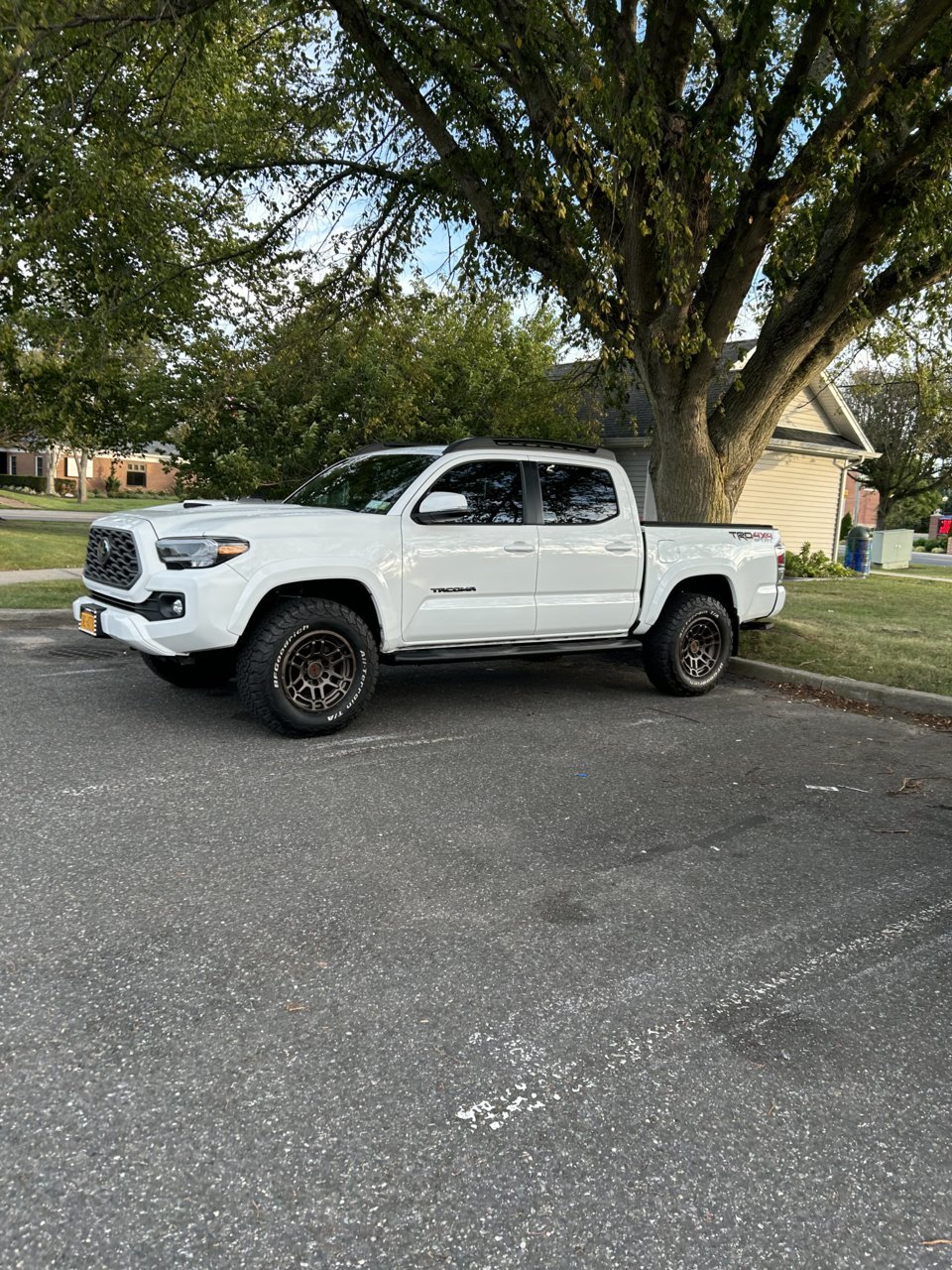

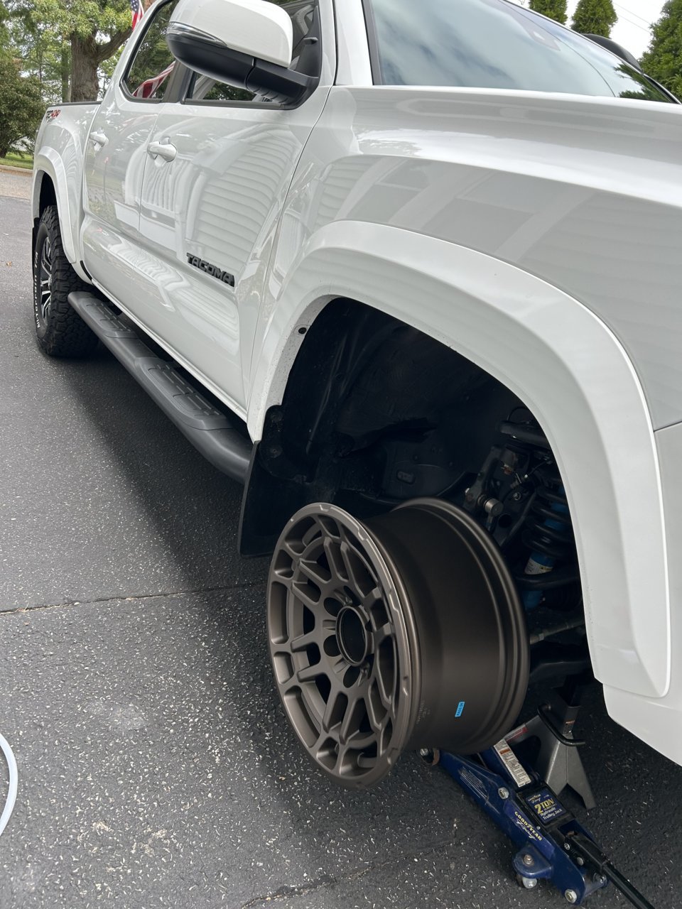

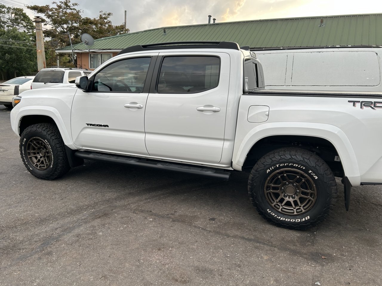

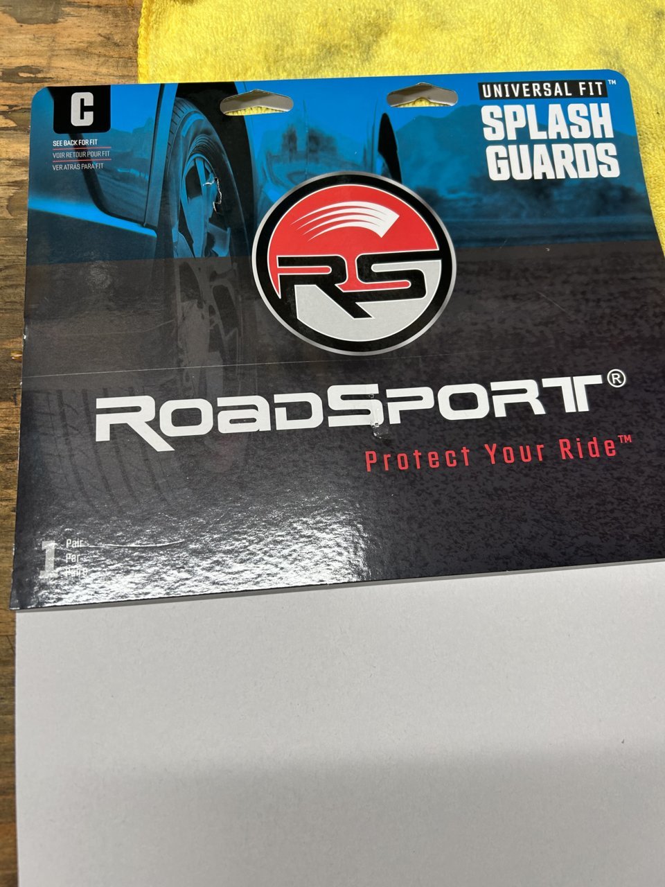

    Received a set of the updated FSW wheels (previous batch didn’t clear front hub dust cap) last week. Test fit then got ‘em mounted to find some rubbing on the front factory mud flaps + bottom of fender. Had to do some trimming and ended up getting generic mud flaps from Advance for $20. Nice thin design, matched up a few holes and she’s good to go!
    mud flaps (size C)
    https://shop.advanceautoparts.com/p...for-light-trucks-material-abs-4322/89013110-P
    overall very pleased with the FSW wheels

    forgot to add:
    BFG KO2 265/70/17
    FSW F268 17x8.5 -10
