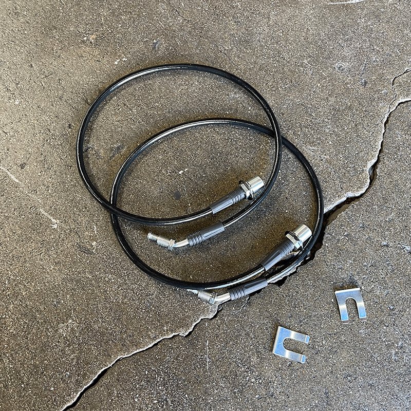

  16. Nov 30, 2024 at 7:46 PM
    #16
    Birdogsetter
    Birdogsetter [OP] Member
    Jun 22, 2024
    #451956
    20
    09 Tacoma
    I finally found these lines. Has anyone used these?? Or a better idea or cheaper these are not cheap at 120.00 a pair...
    And BTW thanks for the help everyone, I'll try to return the favor...

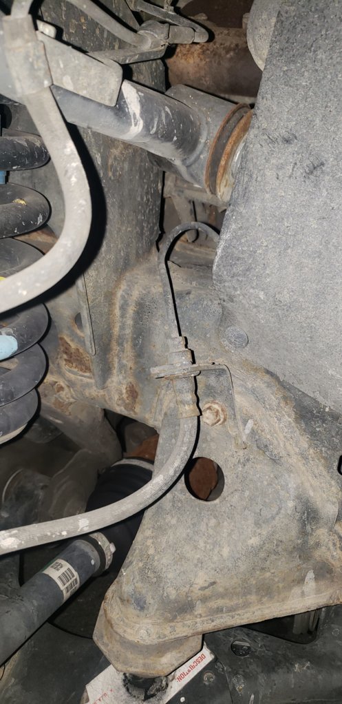

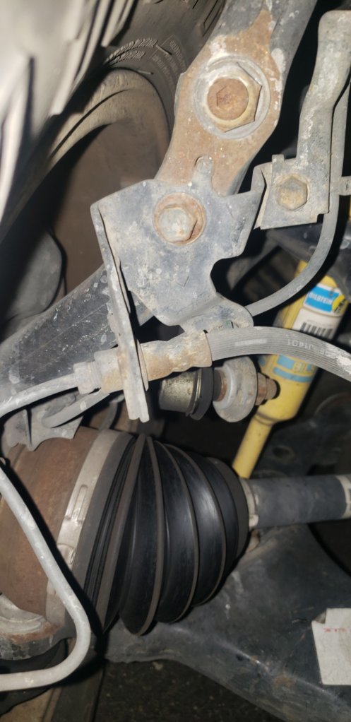

  17. Dec 6, 2024 at 2:04 PM
    #17
    joeyv141
    joeyv141 Well-Known Member
    Jan 31, 2016
    #176710
    1,880
    New Jersey
    08 DCLB 4x4 V6 TRD Sport
    Hi, sorry it took me so long to take these pics. I highly recommend you post pictures of where your brake lines are breaking.
  18. Dec 6, 2024 at 7:03 PM
    #18
    mk5
    mk5 Probably wrong about this
    Mar 15, 2018
    #247373
    1,459
    SoCal
    '05 access cab 4x4
    It might be prudent to determine why the factory hardlines are failing here. The following assumes it's simply because the prior owner's shoddy lift job causes these lines to be overstressed. They should be properly secured at the knuckle -- if you can't fasten the bracket to the knuckle, then you need custom-bent hardlines to accommodate the lift.
    I believe all the brake lines on these trucks are M10 x 1 inverted flare. I was able to find short length of teflon-coated brake line at my local car parts store... albeit for a Tundra booster upgrade, not replacing the caliper hardlines. I didn't even order them online, so I'm not sure exactly what the part number was, but I think it was this:
    So, you could try bending these to replace the failed OEM hardlines between the caliper and the bracket on the knuckle. Might be too long or too short... hard to say, but these are cheap and readily available. I would recommend getting a cheap tube bender sized for the line, although final adjustments can be made by hand. If you kink it, you have to start over. The line should fit into place without having to force it.
    Edit: Such as this fine specimen, clearly forged from American Steel by Hardworking Americans in Pittsburgh, USA:
    Another option... just take it to a good brake shop, they can bend and flare replacements lines that are perfectly fitted to your lift -- and likely for less than the cost of the fancy braided lines. Nothing against the fancy option, I just think it's unnecessary here.
  19. Dec 6, 2024 at 8:01 PM
    #19
    fatfurious2
    Jun 28, 2014
    #132884
    49,631
    David
    Ashburn, VA
    2010 TRD OR Access Cab
    Its not just fancy soft lines. They actually serve a purpose. Rubber lines will stretch with pressure over time. Plus rubber deteriorates over time.
    Stainless braided do not, giving you a better pedal feel and better performance by not expanding when pressure applies.
    OP, 120 for a pair is not a bad cost. Think about your safety too when you press the brake pedal, and not just your wallet.
  20. Dec 6, 2024 at 8:59 PM
    #20
    mk5
    Mar 15, 2018
    #247373
    1,459
    SoCal
    '05 access cab 4x4
    These are excellent points regarding rubber vs. braided brake lines, but I was talking about the factory hardline that connects between two fixed locations on the unsprung front wheel subassembly using rigid steel tubing.
    It shouldn't be necessary to replace this hardline with an expensive braided line; I think it would be more cost-effective to fit a new custom hardline to accommodate the lifted geometry. If this is not an option, then I agree, a braided flex line would be the next-best option. However, I would be weary about connecting two flex lines end-to-end in this application, where they would be free to flail against the knuckle or other suspension components as you drive. But, if that allowed you rigidly anchor their connection point to the knuckle, similar to how the original hardline was attached, then this would alleviate that concern -- although the braided lines pictured appear entirely too long for such use. Perhaps they are intended to replace the entire length of brake line between the caliper and the frame-mounted hardlines?
    In any case, I'm not arguing against braided flex lines in general, but believe that properly fitted hardlines would be the most cost-effective solution here.
