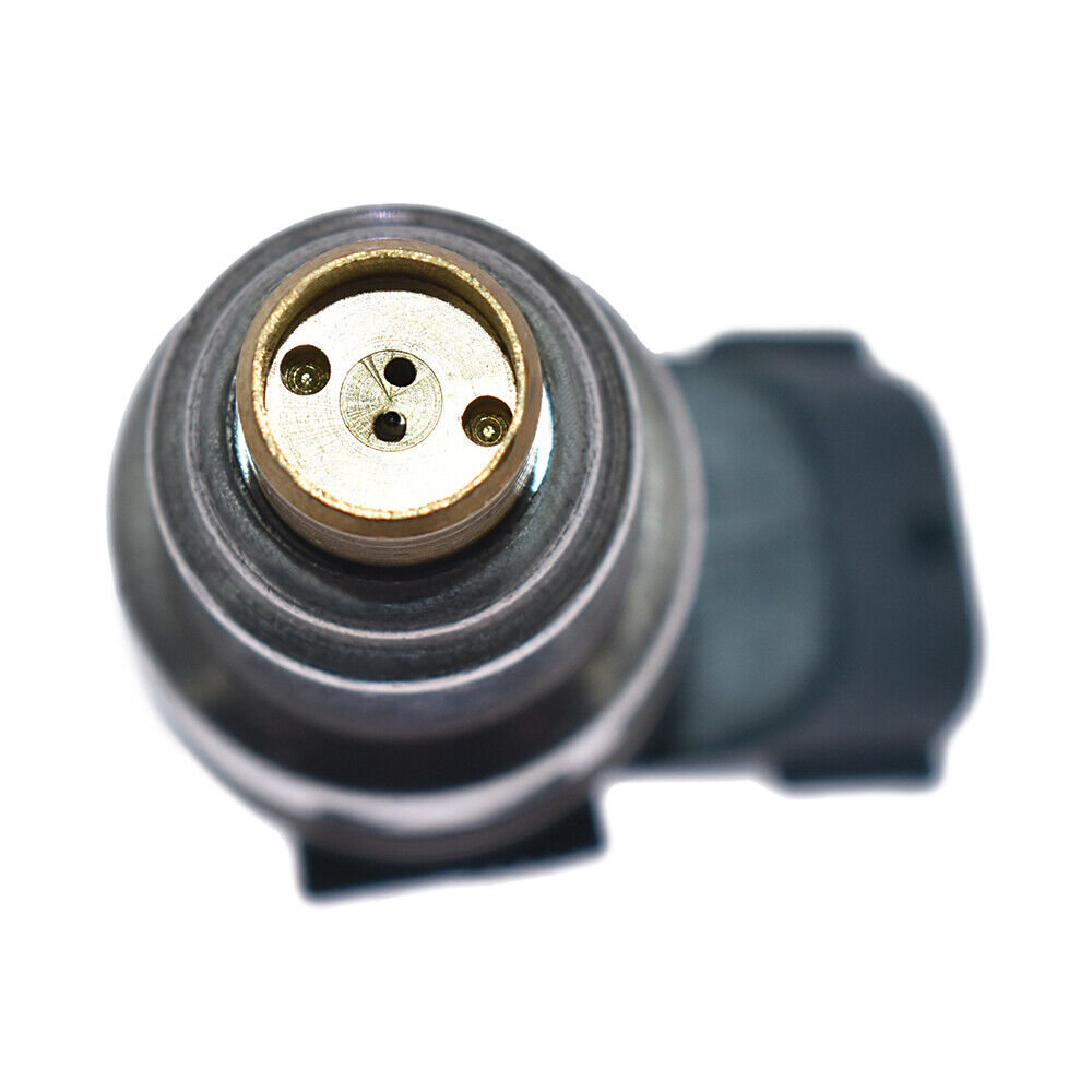

    Yeah check these tiny holes out.....these are for 3rz
    Doesnt take a genius to figure out.....
    If you have these you could benefit greatly by running injector cleaner every so often.....
    If you watch your fuel trims over time, they should increase as those holes restrict......
    And that's not normal carbon, its additives/ impurities in the fuel.......so its gonna take something really hot to break it loose.....

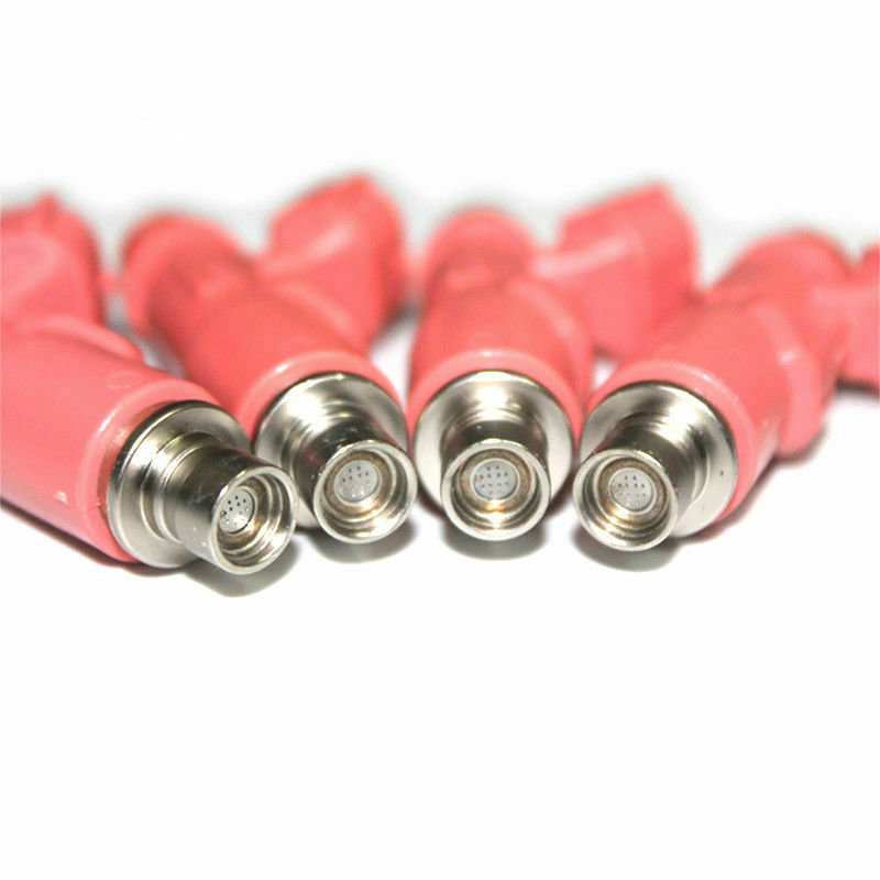

    2rz's have these.....and may not benefit as much......
    and the reason why the 2.4 dont get any better mpg than the 2.7....
