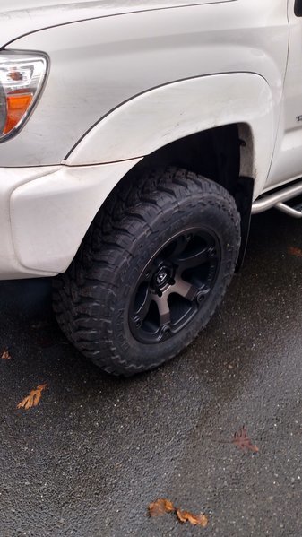

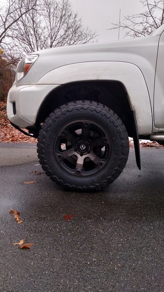

    Still waiting for the snow/salt to leave before I put them on. I'll be keeping my stocks as my winter set. I did test fit them. 18x9 -12 offset with 275 65 Toyo MT's. They do look pretty angry if I do say so myself. I also have king 2.5 resi's going on at the same time which will raise the front about another half inch.IMG_20170122_144108556_HDR.jpg IMG_20170122_144036871_HDR.jpg

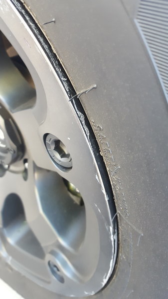

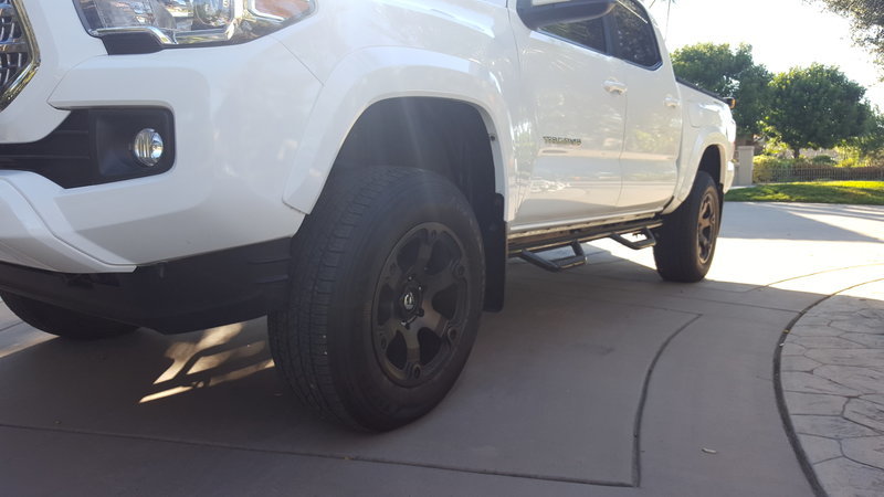

    This is what it looks like with my oem tire. It has a small gap between the tire and wheel as you can see on the picture. I'm having issues with the steering wheel vibrating. I thought it was because the installer put too much air in my tires, so I lowered it down to 32 psi and the shaking wasn't that bad, but you can feel the road bumps through the steering wheel and i also notice the steering wheel handling is more stiff? The guy said he balanced them. :notsure: when I had my oem wheels, everything was smooth.

    Did they install bore adapters? You need 106.1mm to 108.0 I think. Otherwise they will have a chance of vibration.

    Ok. I will ask them today. You figure a wheel place would know.. Do you know why it would cause vibrations and OEM wheels didn't cause it? I'm new to wheels dilemma. :boom:

    There's a gap between your hubs and the rim bore with that wheel unlike stock ones. The spacers take up they space and hopefully your wheels run true. Even though they used conical lugs they may not be centered 100 percent giving a wobble. Gl

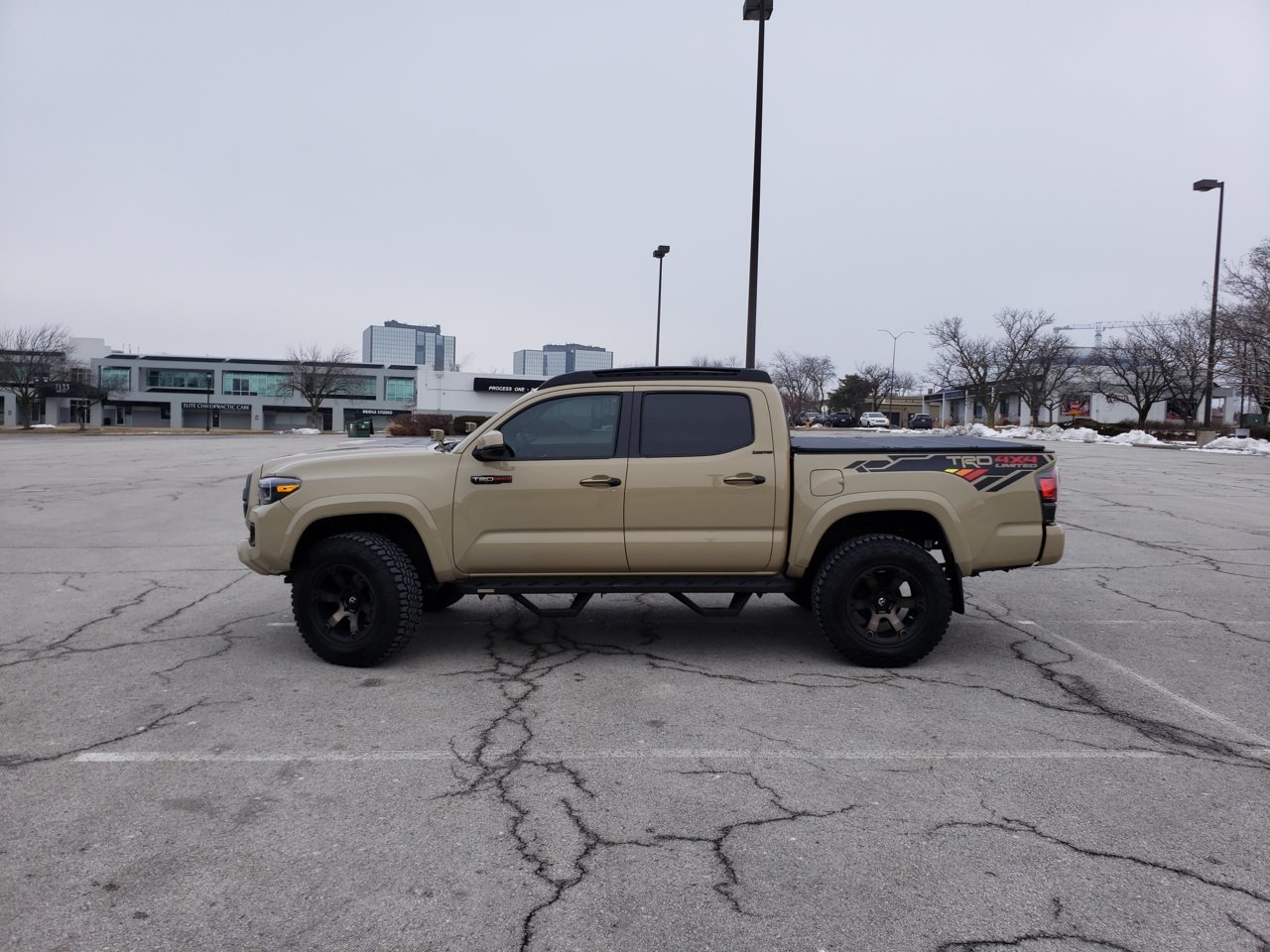

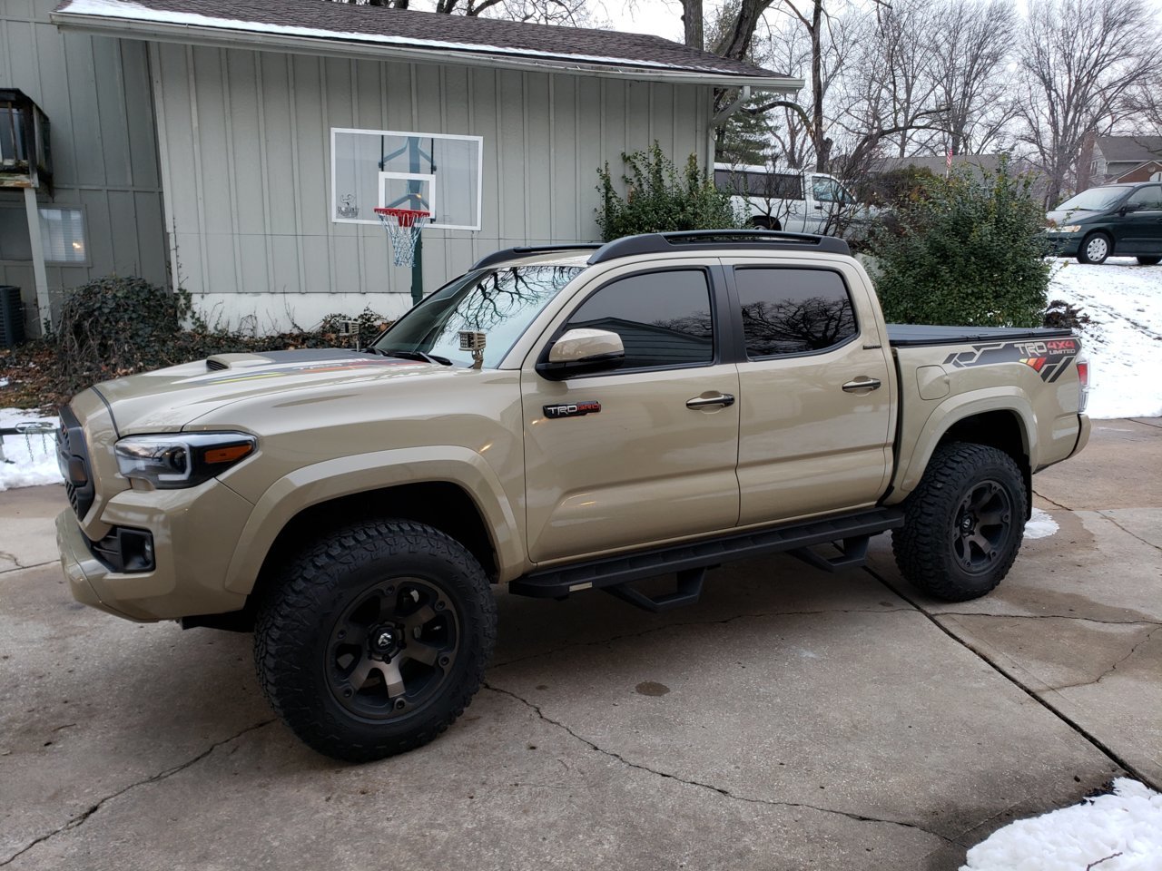

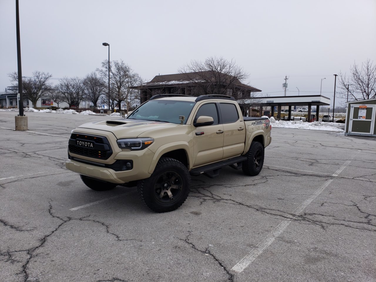

    Here you go,

    Very nice, thank you for posting up the pics
