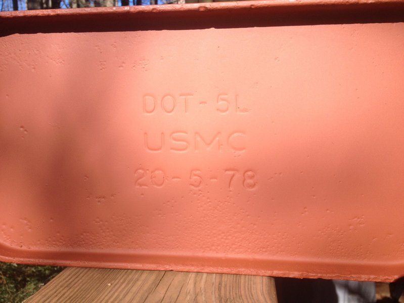

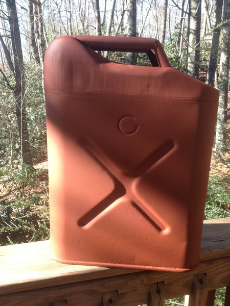

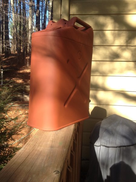

    Hey guys in the process of restoring 4 Jerry cans. They started out pretty rusty but all together I have about 30 bucks in all 4. So I debated a few methods on how to take the rust of without use of to many chemicals. I debated electrolysis but seemed to be a pain so I opted to soak in vinegar. It works amazingly well but just slow, about 3 weeks per can unless you have a tub big enough for all cans and want to buy like 30 gallons of vinegar. the cans still have pitting from the rust but nothing I can do about that unless i used body filler or something.IMG_1524.jpg IMG_1525.jpg IMG_1526.jpg I will post pictures as I go but here is my primed and first can I did. I used engine paint for the final coat because of the chemical resistance of the paint vs regular paint. I hope it works since I took a gamble. more pictures to follow.
