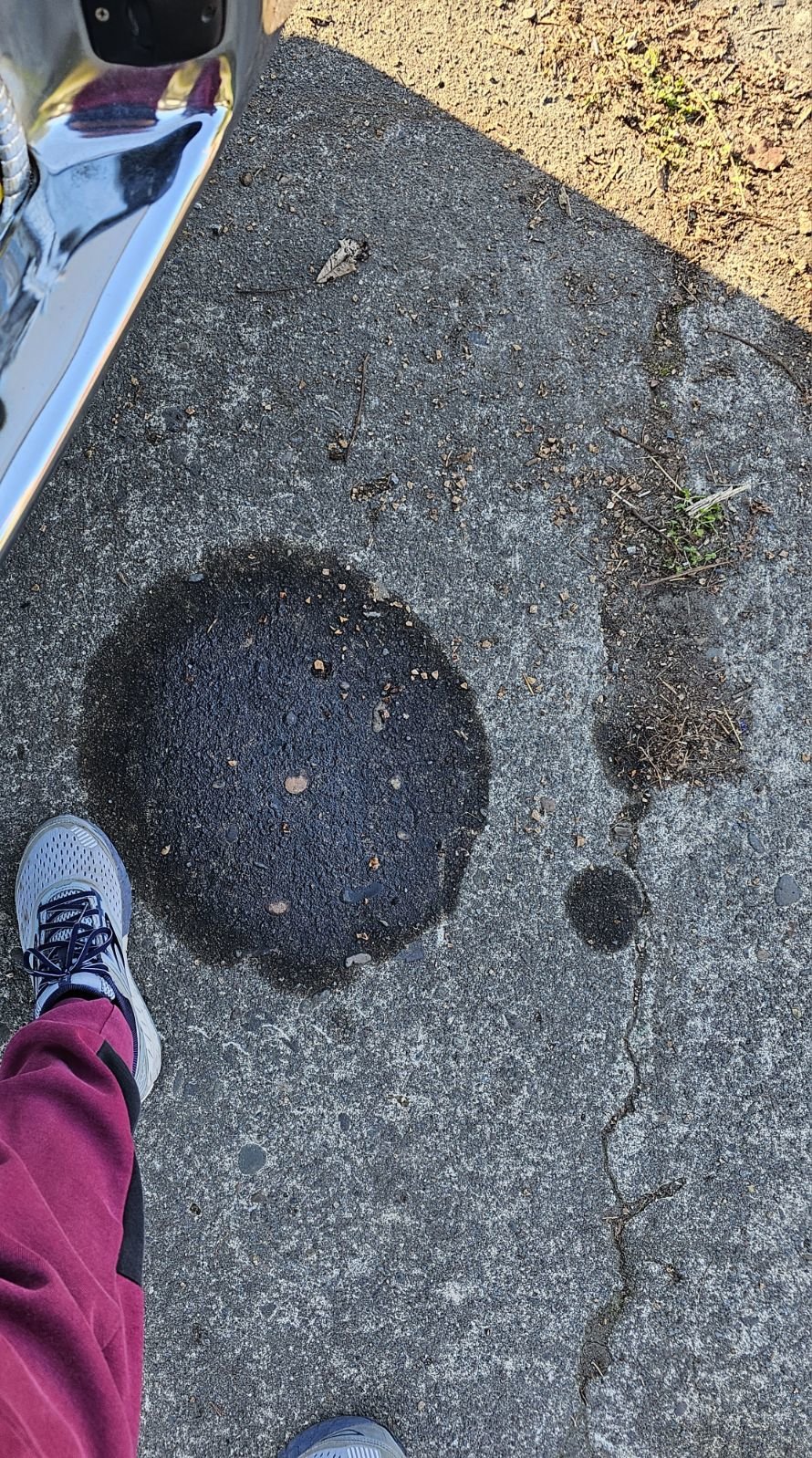

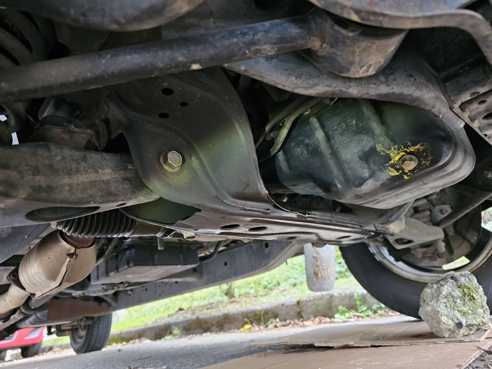

    Dear Members,
    I have a 2001 Toyota Tacoma and recently went to an oil change location for a oil, and radiator fluid change. I opted to have the fuel cleaning service done (which I've never had done and GREATLY wished I'd just used a can of seafoam instead, in hindsight) and I realized afterward that it was the first time this guy had done one. I remember hearing the assistant manager say, "was the tank (of fluid) all the way full?" Admittedly, I'm not a mechanic. However, when I got home I noticed a pool of liquid under the truck and those pools have continued since, though they are getting smaller. The fluid didn't look like, or have the viscosity of oil- nor the color of radiator fluid, nor did it smell like anything. I looked up the YouTube video of valvoline doing a fluid cleaning procedure and I do not think this was done properly. I believe that in all likelihood, the cleaner dumped down into onto the parts below because this wasn't done correctly. I brought the truck back a week later and told them what I found. The cleaned the area and thought that would take care of it- it didn't. I brought it in a 3rd time and they re-did the oil and unfortunately discovered they'd put too much oil in it based on what their system recommended (after I mentioned that the RPMs were high during idle). They also attempted to clean the underside again. I put cardboard under the areas and I'm still getting small circles of this fluid. I should mention there are no lights going off on the dash. There is one particular area where this fluid seems to drip from (I'll include a photo, you'll see the shine on it); it seems to stretch along between the front tires with 4 holes in it. I don't know what this part is. I'm concerned that because it has those 4 holes at the bottom (I'm not sure if this part also has holes on the top of it or not) they haven't been able to adequately clean it (3 times), which has a slight vicosity, is going to cause debris/dirt to stick to and/or in it, and cause rusting. I feel like I should probably ask for a refund for the fuel cleaning because I can't imagine there should have been that much that leaked all over the street (I can take pictures of all of these stains if needed to show the size- but here's a pic of one of them that's larger and a small one next to it) but I was hoping someone here might help me be able to help me feel more confident in making this assertion.
    Additionally, I was wondering what needs to be done about the part that seems to be most effected by this (assumed) spill of fluids. Do I need to have it removed and cleaned? Is this something I could possibly do myself? Though not a mechanic, I'm a capable DIYer and think it might be safer, if generally doable, to do it myself rather than possibly asking this oil change place to do it based on how many issues I've had with them already. If it's not a do it yourself kind of thing (and should be done), it'd be helpful to know what part this is in case I needed to have an auto shop do it. It's only got 109,000 miles on it and I'd like to take care of it so it keeps on going as I understand you can get 3- 400,000 miles with these trucks.
    Any help, or advice, would be GREATLY appreciated... more than you all can possibly imagine!

    Change the oil yourself, make sure everything is properly tightened, clean the engine to your best ability, see if anything is still leaking.
    Make sure your coolant level isn’t dropping and make sure your coolant doesn’t look weird like oil is mixing with the water.

    First... Take the truck to a car wash and try to clean the underside where it's leaking as much as possible, with the goal of eliminating any remaining fluid in that cross member or other locations where you think it's leaking from.
    You need to determine what the leaking fluid is to focus on what system of the truck to target.
    If it's oil.. I'd be checking that the oil filter wasn't loose. You should also be able to see where the oil is coming from...
    Coolant.. similar, check that they didn't damage the drain valve.
    I don't know what a fuel cleaning service is... Did they try to replace the fuel filter? The 2.4/2.7 fuel filter is a pain to replace. Maybe they didn't tighten the fuel lines well enough and you're leaking fuel?

    Oil change locations are notorious for making up and selling completely unnecessary procedures, because those are the only things that pay the rent (They couldn't stay in business if all they sold was oil.) Do not let them touch anything beyond the oil pan plug and the air filter (and preferably not even the air filter); they don't know what they are doing. I would recommend taking it to an actual well-reputed mechanic's shop for maintenance, if you don't wish to turn your own wrenches. Believe it or not, they will be less costly in the long run.
    For the weird fluid leak, try to chase it yourself if you can. I'm hoping that its the very simple answer that the tech spilled fluid, which will take a while to drip its way down the block. But you would need to check all of your fluids and chase the trail to verify that it is something that simple. If you can't do that, don't take it back to the oil shack. Take it to a mechanic, let them look at it, have them check the fluids, and then present the bill to the oil shack when its done. You might get the money back, you might not. Post a picture of the bill on their google maps review if not.

    I do not believe it is a fuel leak as it does not smell at all, nor does it evaporate quickly. It also has a slight viscosity to it, so that leads me to believe it's not likely fuel.....thankfully.

    Looks like oil. If it's dripping from the front crossmember behind the oil pan, you might want to check the rear of your valve cover for a gasket leak.

    Thank you so much for the advice! I checked the radiator fluid and it looks good.
