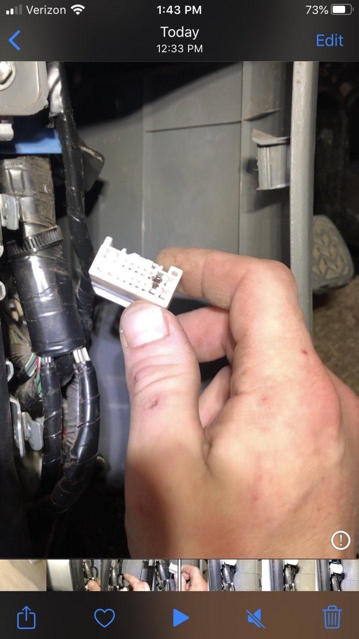

    I had swapped out relays in the parking lot the first day it quit.. I bypassed the resistor as well, it was reading 11v at pumpwiring connector while cranking, did seem to be consistent or enough to prime and run pump. I traced the power wire from pump back under the dash and found this... I am going to solder in a jumper wire to bypass the connector and see what happens. Thank you all for the replies so far, I’ll post my results of what happens shortly.

    It was the burnt connection. It showed 11v on the test meter, but didn’t have the amps to run pump.. I just want to add to this post for anyone who might read it in the future. When I was troubleshooting the issue, I was still getting 10.5-11v at the pump wiring connector. My first thought was a bad pump. A brand new pump was installed, and the power supply to the pump was still testing 11v while cranking, but pump would not run unless I hooked 12v directly to it. Apparently even with the burnt connection it would still test close to 12v at the pump, but when pump was hooked up and drawing electrical current, the burnt connector could not provide enough amperage to run the pump. If doing it all again I would check for resistance or current flow between resistor under the hood and the pump connector..

    Even 1 strand of copper wire will read voltage on a DVOM, but will not carry a load, that's why load testing and not just voltage or continuity testing should always be performed. Glad you got her fixed!

    OK , found the weak link in the system, I get the jumper wire temp fix to verify the problem, so now what is the proper repair for this, a new connector, if this were a warranty repair what would a dealer do so that it did not reoccur ?

    is that at the ECU itself?

    Connector is on the driver side, as noted by the pedal in the back ground. Makes me want to check my connector, since I never upgraded the whole wiring to the larger pumps that I have run over the years. Especially with the age of my truck.

    Hmm what do those pins actually go to (connector and harness side?)

    It appears that the wiring to the pump is not enough to foot the amperage that even a stock pump is capable of running. That's a little nerve wracking...

    That has nothing to do with the wiring.
    The burning was from a loose fitting between the male and female terminals.
    This loose connection equals resistance, a resistance in a wire is a heater.
    That is what caused the burned connector. The wiring is just fine for the fuel pump full load amps.

    Yeah true. I didn't think of a loose connection.
    Probably a freak thing as you don't see it happening much on these trucks.

    Well this is true in most cases of normality, the wiring connector in tank showed signs of heat degradation on the factory side, due to the smaller gauge wire at that connection, on my truck specifically. Which made me replace the wiring in tank with larger gauge wiring. However that doesn't correct the rest of the wiring to the tank and any smaller connections in between. Which is what got me thinking about that pin and wiring for my truck specifically.
