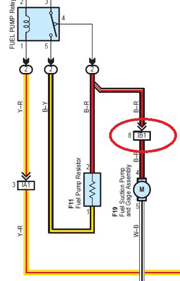

    does the electrial load for the pump actually run through the harness inside the truck? I could see maybe the signal wire for the fuel pump relay, but not the actual main feed to the pump.
    Off to the wiring diagrams i go.

    From what i can tell the main power for the fuel pump from the fuel pump relay doesnt go through the cab. Those pins look like they could be the trigger wire for a relay though.
    Edit. NVM. that connector is IB1, pin 8 (top row) is directly from the pump relay that OP shows fried. Very surprised that main power wire isnt just ran down the wheel well / firewall, along the frame rail right to the tank.

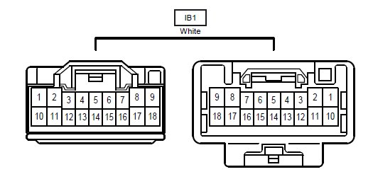

    FYI here at the wiring diagrams. now what are the other pins in there for, specifically the larger pins (1 2 8 9 10 11 17 18)?

    The black with red trace 14g fuel
    Pump wire was the only wire utilizing one of the large ports on the connection. Iirc there wer 4 other smaller gauge wires separated to the other side of connector. Fuel pump positive wire was on its own.

    Interesting. Wonder why they used such a big plug for all of 5 wires.
    Whelp good to know. I assume that connector was in the drive side kick panel by the clutch (manual) or dead pedal (auto)?
